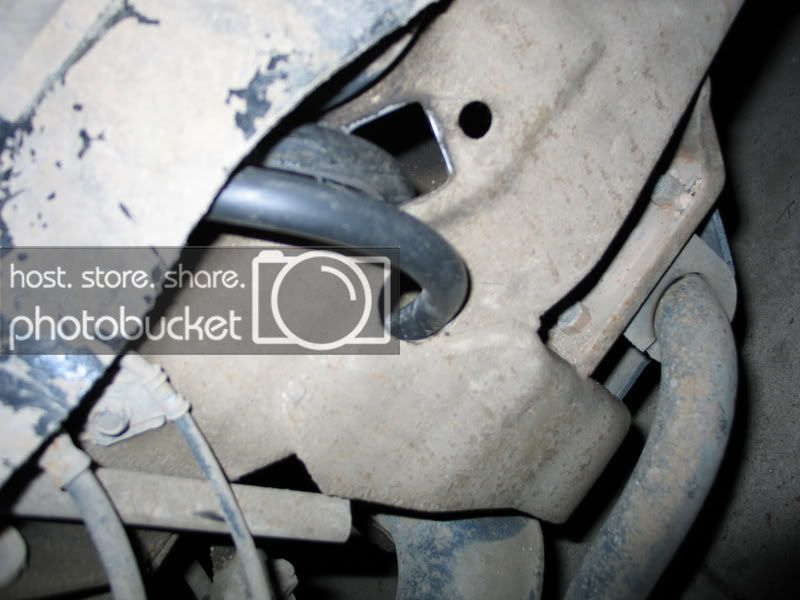

Right below the battery there are two holes to run in the frame. This is how I ran my ground, if you run your power wires through make sure to use something to protect the wire from rubbing on the hole. This is on a 2001 s10 blazer (the front half of the frame is the same as the trucks) with 2/0 welding wire.
