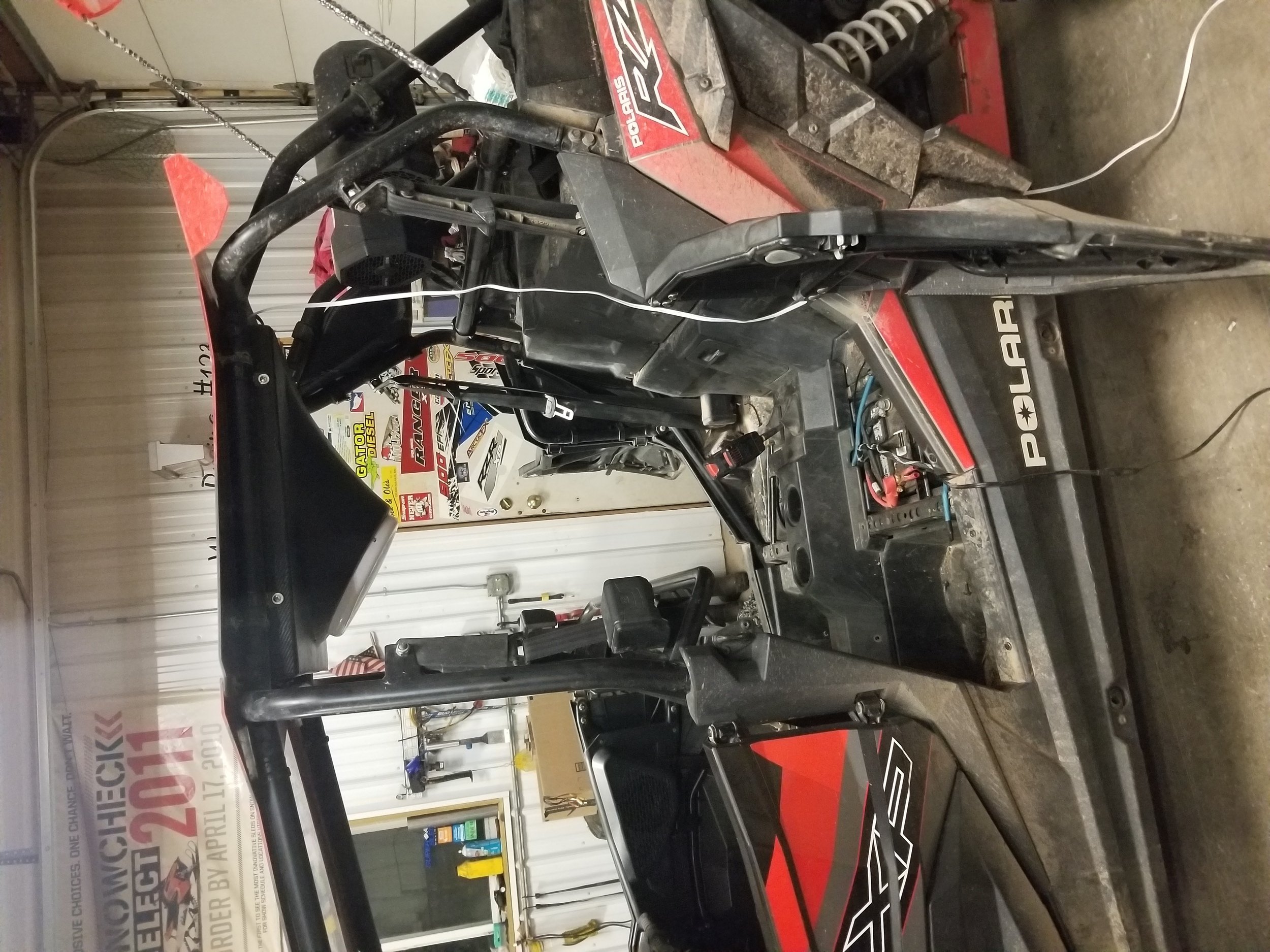

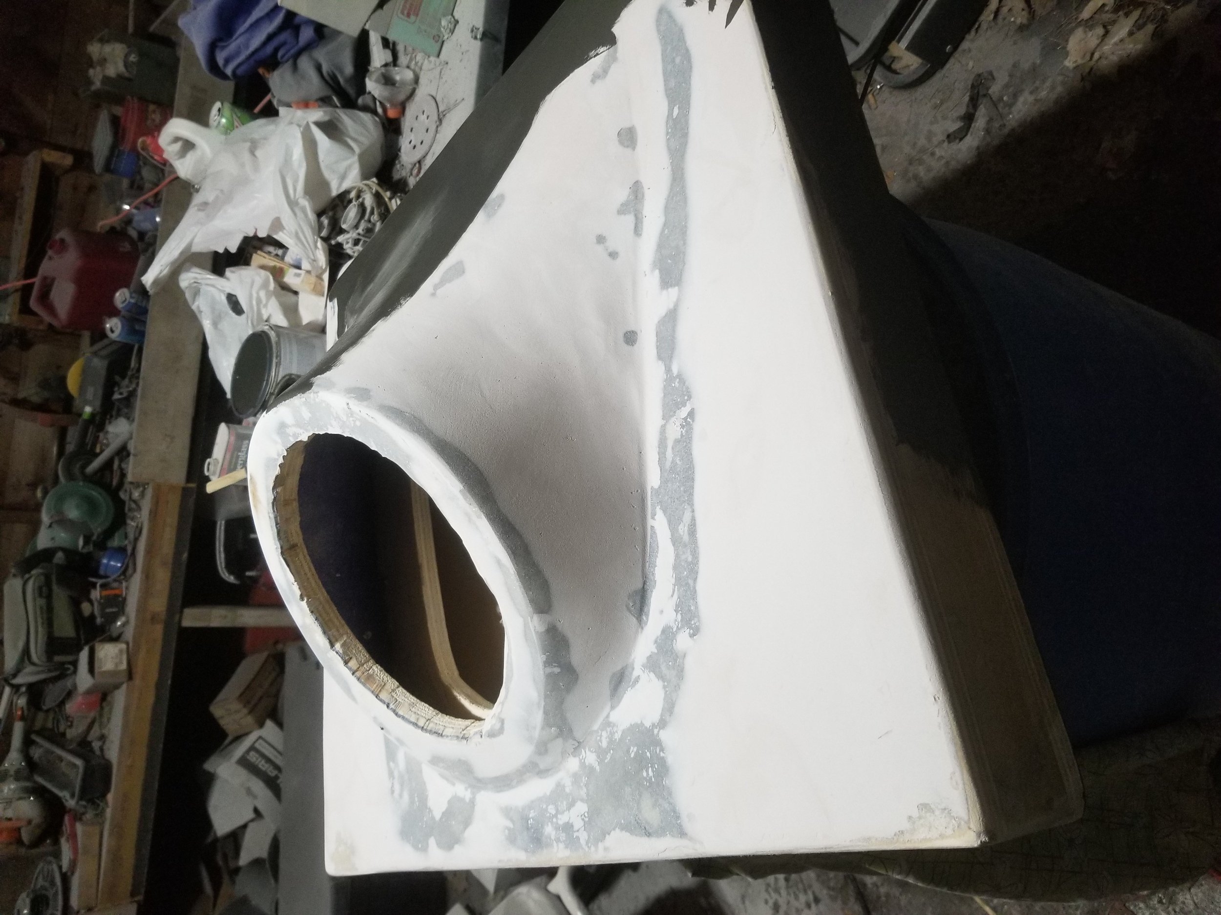

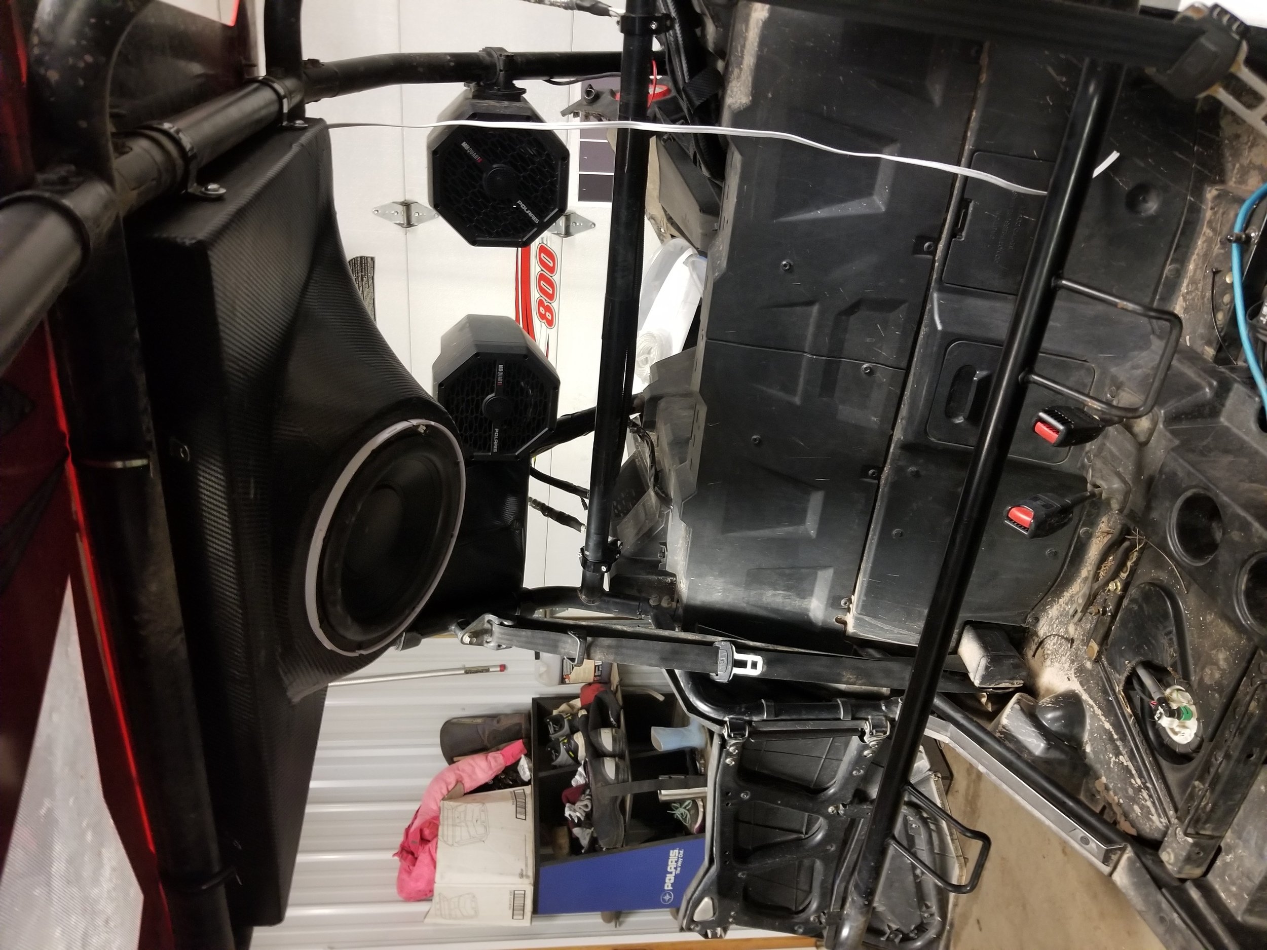

Heres my first attempt at making a fiberglass enclosure i think i turned out ok there isnt many subwoofer options that work very good for the side by sides it seems towork pretty good im only running a rockville 10 inch marine sub for now until i decided if i want to keep it so after a little testing ill upgrade the speaker id like to here some feedback from more experienced builders
Cool idea, do you know how much airspace is in there? Doesnt look like a lot. Personally i like ported boxes if at all possible around 32-35Hz in my cars, I'd probably go with 37 just to get more output in a razr with it being so open. (I hate higher tuning and sealed boxes) I don't have any experience in razrs tho. All my useless opinion 🙂
Ive meaning to fill it with something and measure but im thinking around .7 to .9 cuft i wanted to go a bit bigger but i was worried about head room if i went deeper
