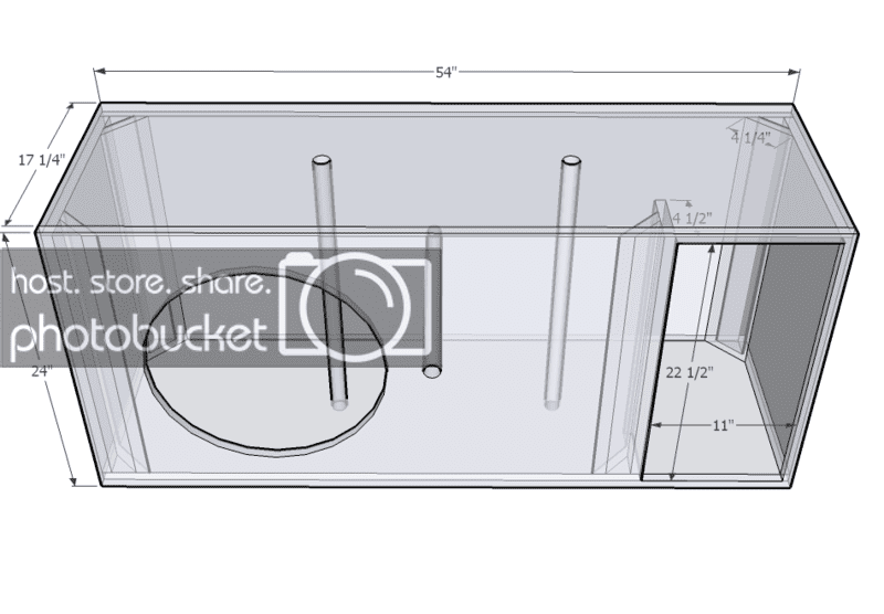

The box is going to be 10ft^3 tuned to 53hz, with about 250in^2 of port. It'll be powered by a Sundown SAZ-1500D at .5ohms in my '04 Dodge 1500 4-door truck...here's a little glimpse as to what it's going to look like.
This will all be below my window line, also. //content.invisioncic.com/y282845/emoticons/sneaky.gif.7189749b3a3f769e8815b47e8ae87f88.gif

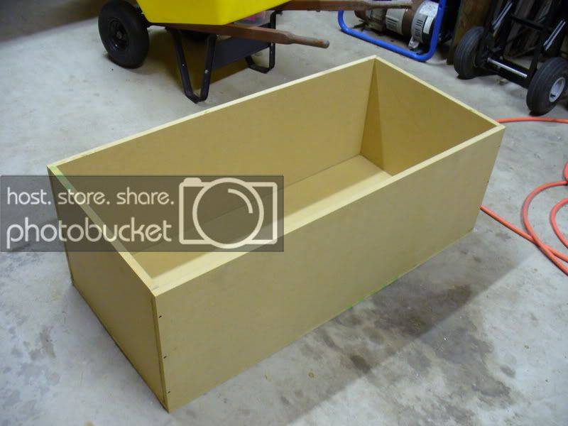

Well I decided to change my box a little and use some leftover MDF from my other boxes. The box will now be 8.5ft^3 tuned to 52hz, and just 49" long. Got started on it tonight...
First pic came a little late in the build...

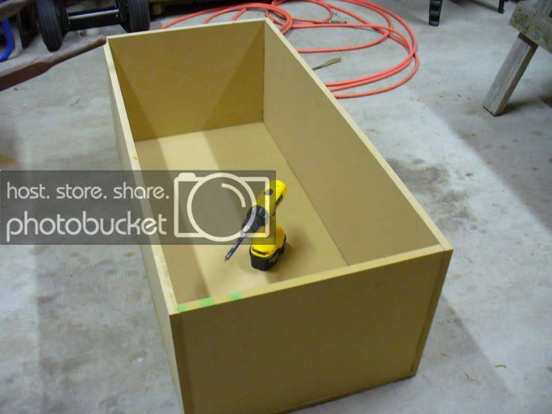

A little size reference, the box is 9.75ft^3 total.

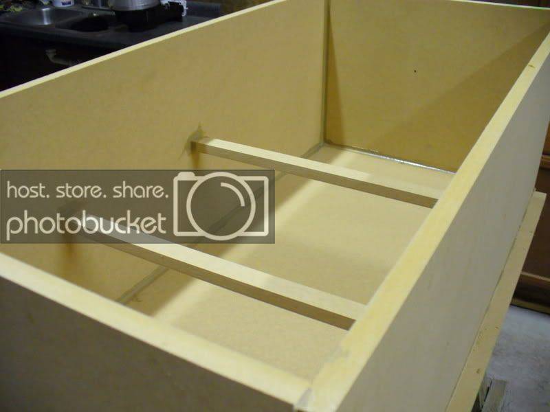

Got some bracing in...
Tomorrow I'll be doing more bracing, putting 45's in the corners, and getting the front baffle all nice and pretty...more pics to come. //content.invisioncic.com/y282845/emoticons/biggrin.gif.d71a5d36fcbab170f2364c9f2e3946cb.gif
