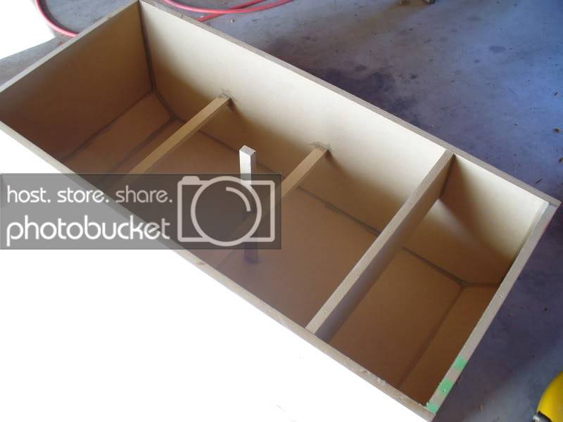

just FYI using MDF strips to brace your box is a terrible idea. they will most likely break.
get some pieces the innier H & W and cut holes in them and do it that way. i will almost guarantee those braces are going to fracture or flex and not do what they are supposed to do.
otherwise, looking good.
I was actually thining that too, but I didn't want to do my usual 1.25" dowels until I see that the sub is even worth going through more trouble and money for. If they do break, I'll just use some wooden dowels like I have before.

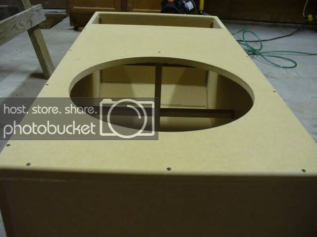

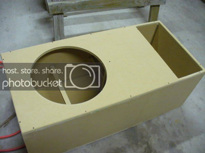

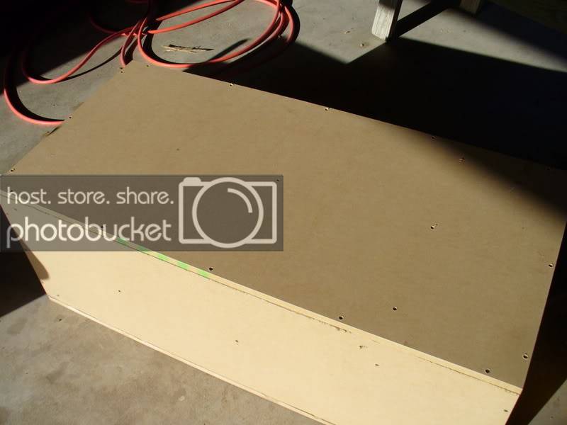

Did a little more bracing, put the port in, and put some 45's in the corners.
Got the face on, just need to cut the sub and port holes...
All done with a nice lil roundover on the face.
A little angle shot...
Port's as wide as a long neck.
A test fit and size reference.
All in all I'm pretty happy with how it came out. As stated earlier I'll probably end up using 1.25" wooden dowels for braces instead of the MDF.

x2, I would have at least double baffle'd the front.
I didn't have enough leftover MDF for that, unfortunately. I'd really be surprised if this box flexes much at all. The sub is close to three sides and has a brace right next to it on the right side as well.
But if it does, nothing a little $$ and some elbow grease can't fix.
wtf? single baffle?
Double baffle is overrated. //content.invisioncic.com/y282845/emoticons/biggrin.gif.d71a5d36fcbab170f2364c9f2e3946cb.gif I looked at the xmax graph on winISD and it won't be moving more than .5" at the frequency I'm playing. Not to mention it's not a terribly heavy sub and it doesn't have a lot of xmax(just a little over an inch p2p).
I also did a single baffle on my three MJ-18's and have had no flex issues...
