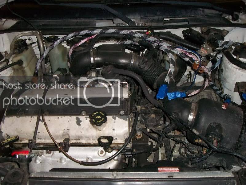

this was my 98 escort zx2. i had one ground straight to the suspension bolt(on the right of the pic) and it is a pretty good spot to ground to on that car. then i did one straight from the alt casing on the top mounting bolt, (the best spot to ground on a car period.) then theres the alt pos. to batt, BIG 3 done!
