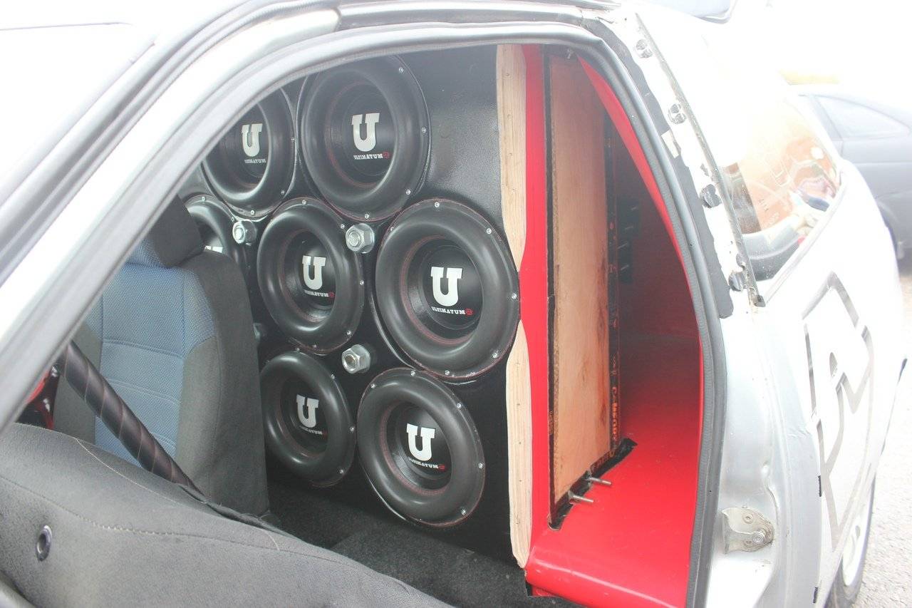

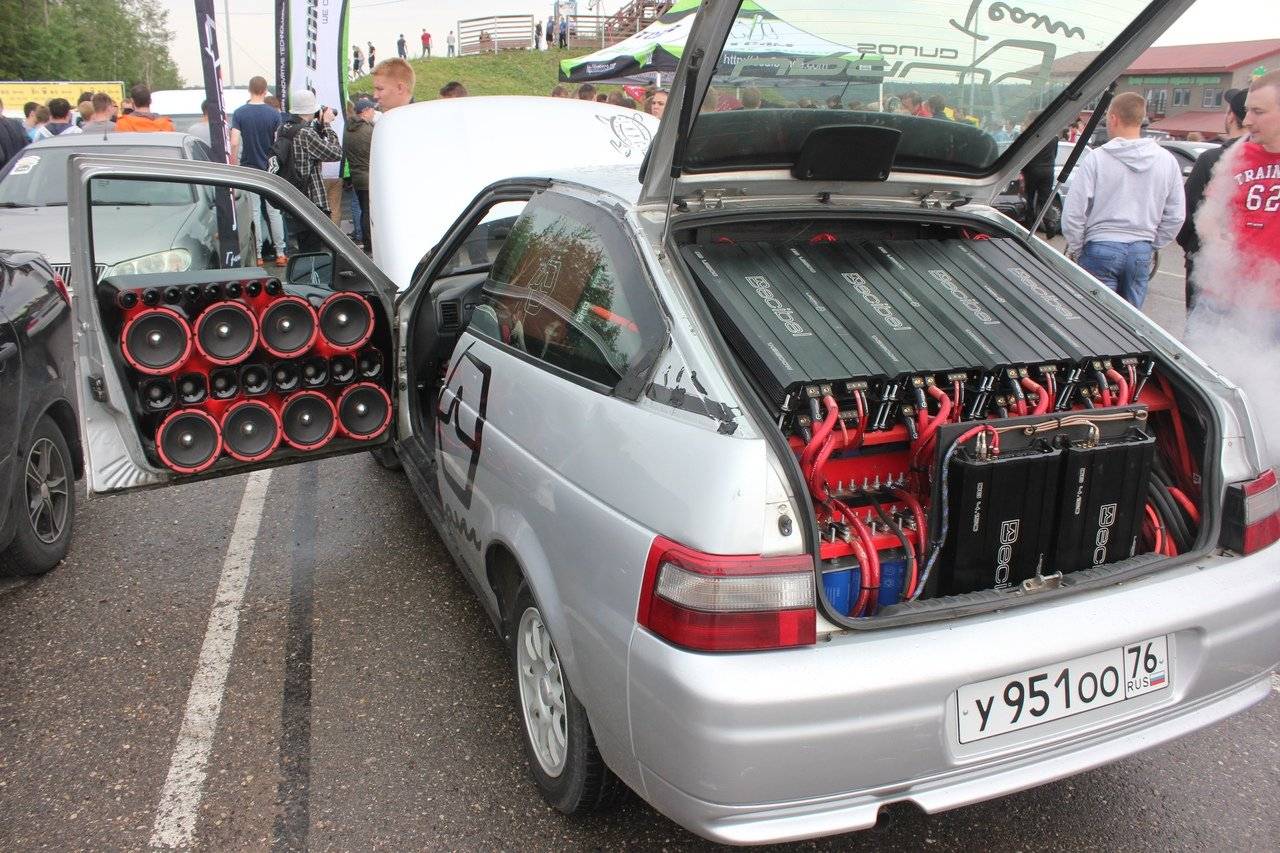

Flat wall:
8 subwoofers Ural Ultimatum 12 "
8 Amplifiers Ural Decibel 1.3500
Front Acoustics
16 speakers Ural Decibel 8 "
16 drivers Ural Patriot SPL Extreme
16 Twitters Ural Patriot PT-60 Neo
Amplifiers for frontal acoustics
2 amplifiers Ural Patriot 2.1200
2 amplifiers Ural Decibel 4.150

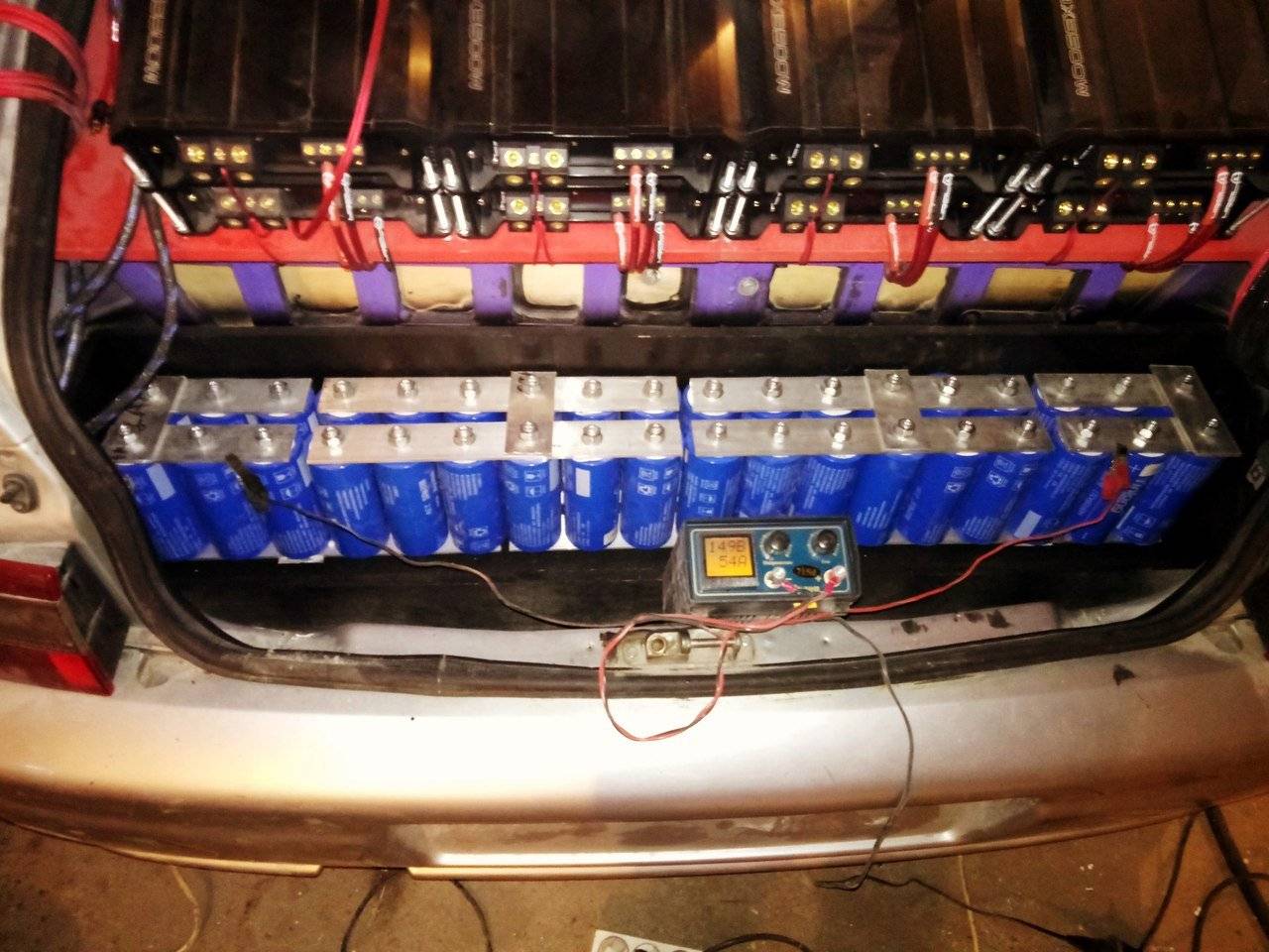

Batteries Lithium LTO 240 Ah
Alternator 320 A

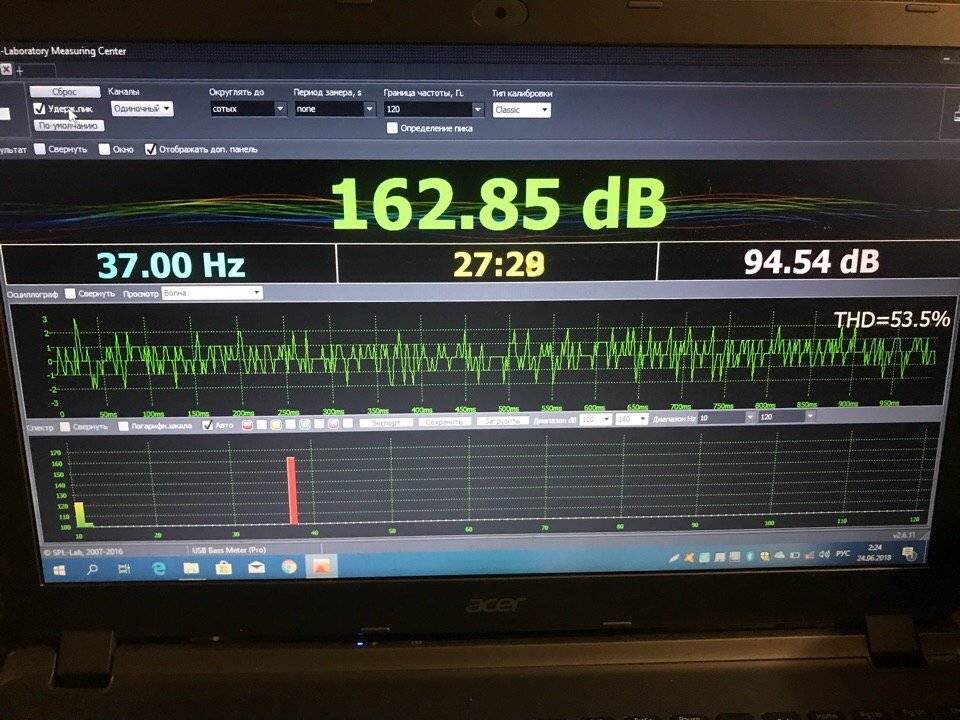

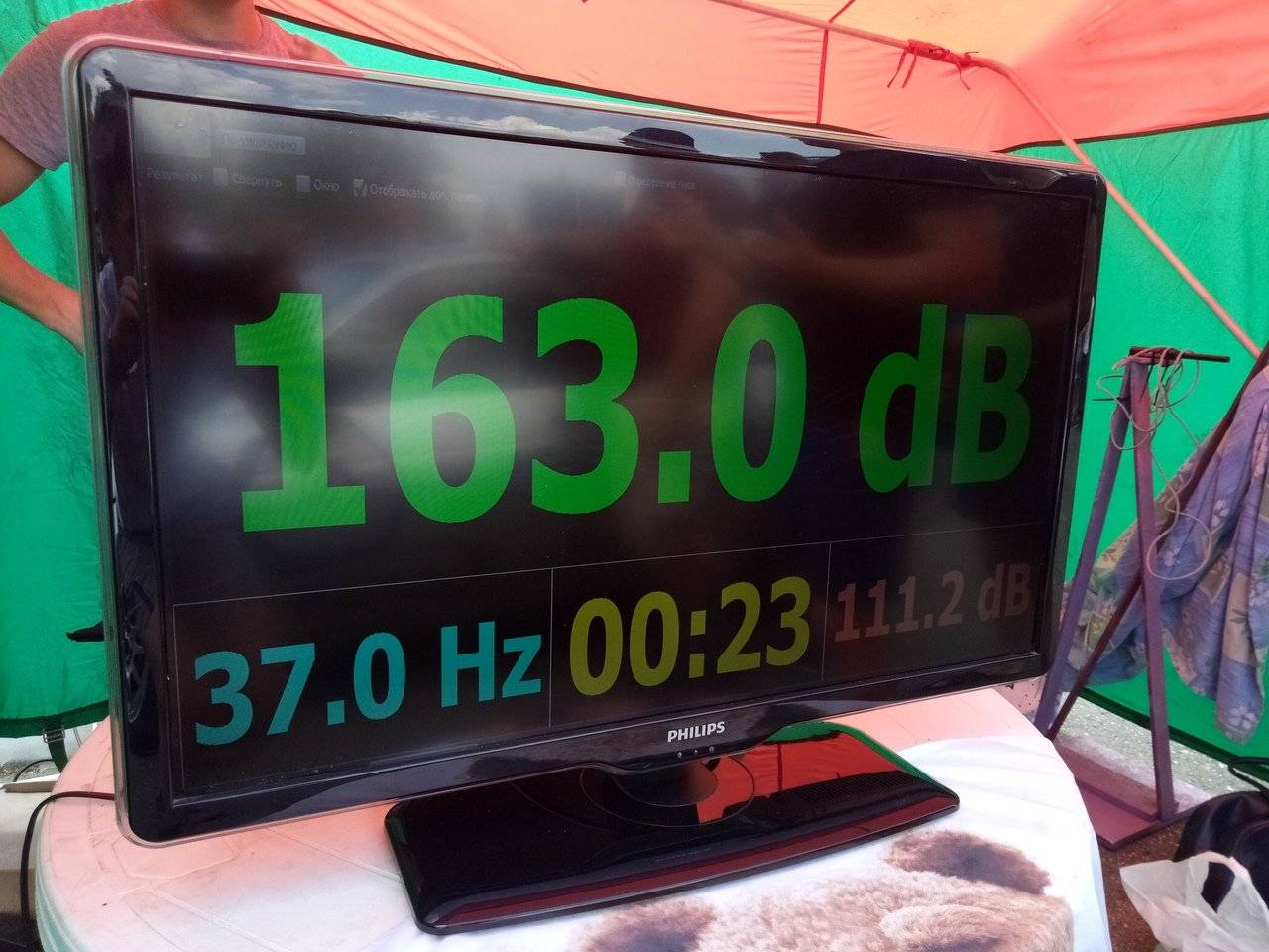

SPL - 162.8 dB

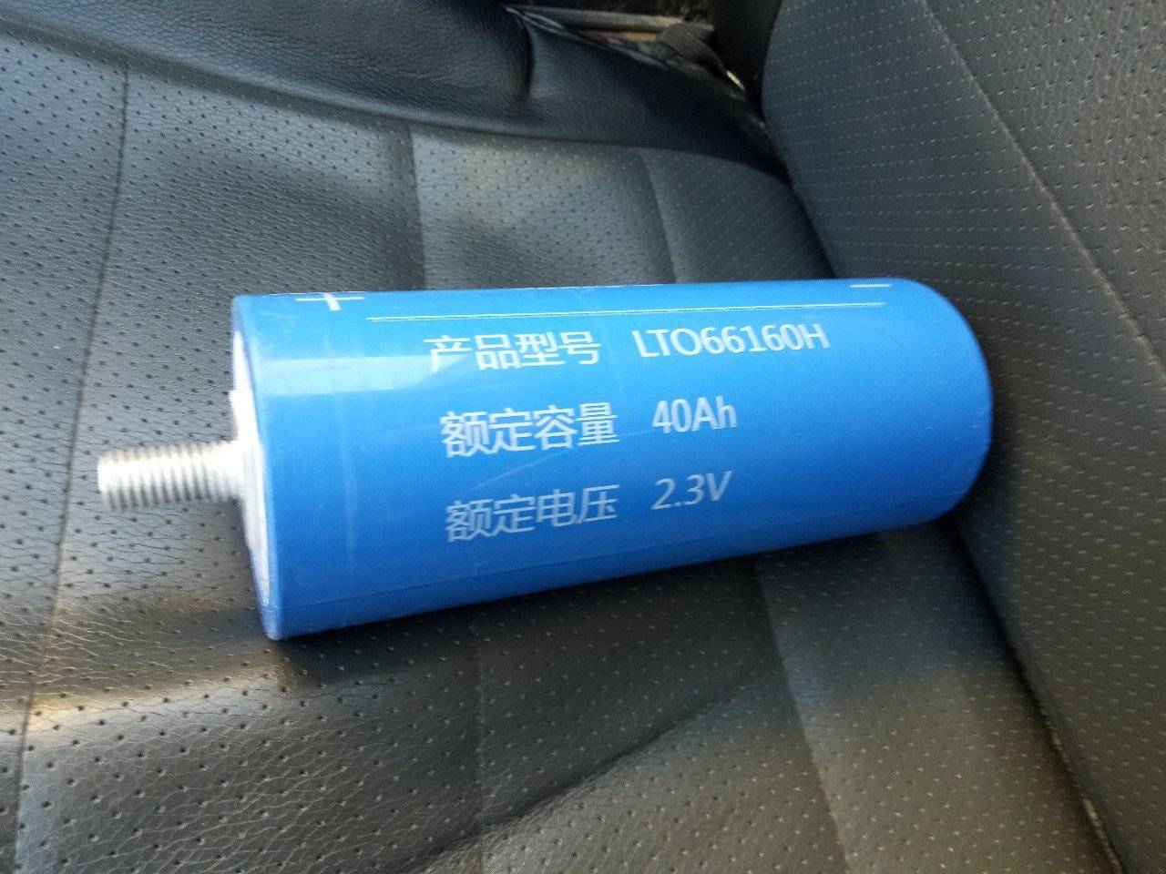

Buy in Russia. Batteries made in China.36 pcs, each of 2.3 V and 40 Ah
Very nice. I am actually getting ready to buy some of those cells and I'm very happy you posted this.
At what voltage do you charge them? How low does voltage sag with burp? With music?
Would you build the same battery bank again? Use more cells? Use less?
I would very much appreciate your experience with these.
charging voltage 15.5 V
batteries are collected in a section of 6 pcs.
With a consumption of 18 kW, the voltage sags to 14.5 V
We use these batteries for 3 months until everything is OK

I know, right? Looks like these cells are going to work out to about the same money as I was going to pay for the A123 LiFePO4 cells and while the C rating isn't quite as high on discharge I wasn't planning on redlining my battery bank anyway and by all accounts no matter what you're doing you can expect 10X the life out of LTO according to everything I've read so far.
It seems that guys who are trying to balance these are doing it with supercapacitor balancing boards. That said, I'm not sure how much I really trust any of that. Considering the current that these jokers need to handle for our applications what do you suppose an actual BMS that would pass 2000A would look like?
I figure I'll just pull the cells and test them individually every 6 months or so and if anything looks out of spec throw it away and replace it as needed. From what I've read the LTO technology is a lot more stable/reliable than other lithium and they're even much more tolerant of constant charging or trickle charging (basically what driving will be doing).
As it stands even if you kill them in only3-4 years it's no more money than LiFePO4 or AGM under most favorable conditions.
The big drawbacks I see are weight and size (not nearly as good as LiFePO4 still far better than AGM) and oddball voltage (will need to externally regulate most likely), and slightly lower discharge C rating (10 as opposed to as high as 40 on the better LiFePO4). Still I didn't really plan to push either far beyond 5C.
Big plus is huge life reasonable cost and strong cold weather performance which is important up here. The fact that OPs bank is hanging with 28K pretty much tells me all I need to know. From here the only risk I see is sending Western Union to China, but it seems like a pretty legit seller I'm looking at, so fingers crossed on 2500$ that I have no way to recover if something goes south.
