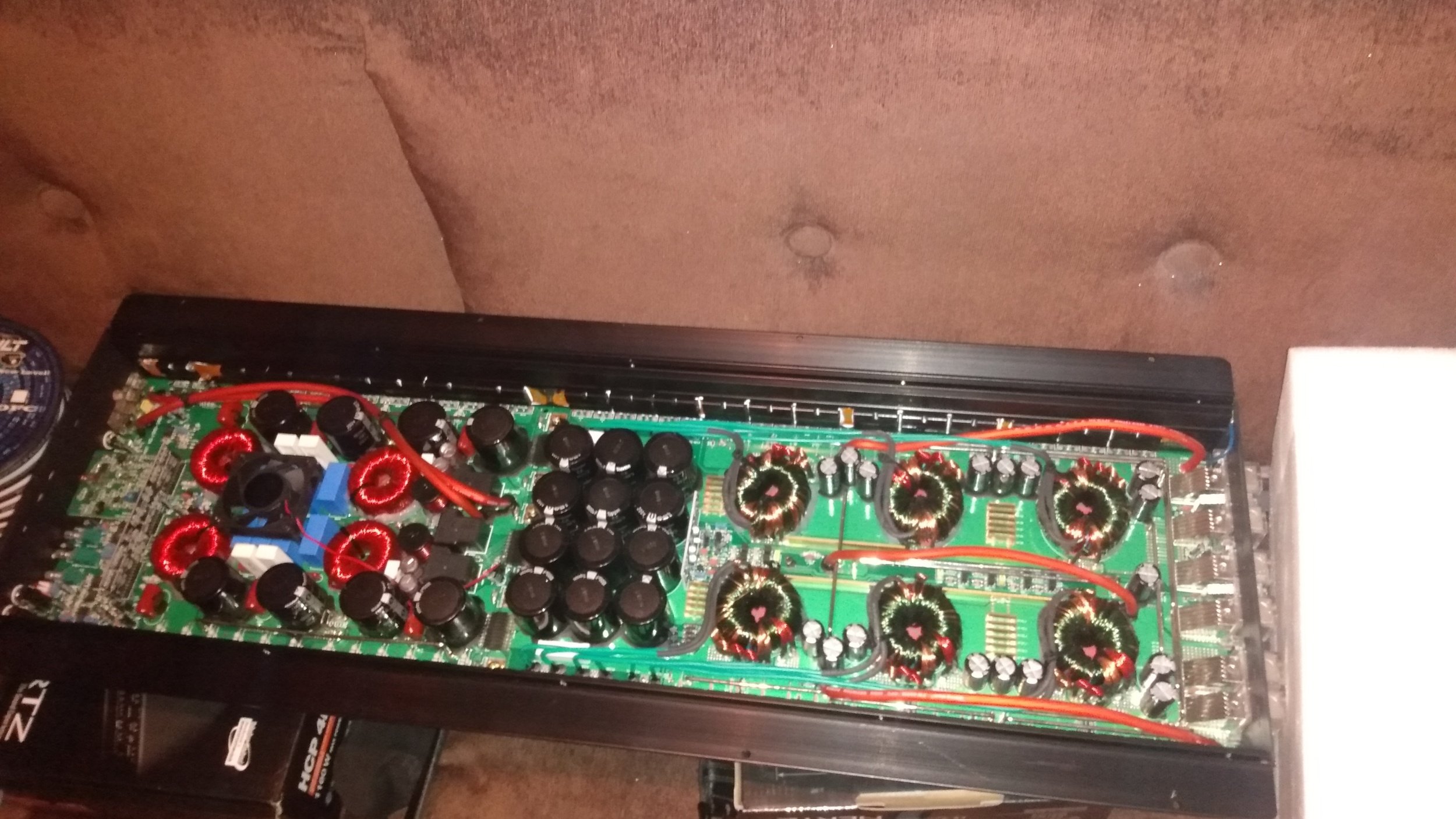

Dissected it opened it up the capsid damn decent so all of transistors they're not top-tier transistors but they're middle of the road and both the output and power supply is capable of over 10.5k
