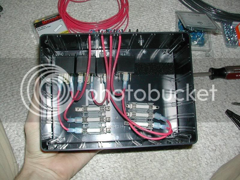

With switches .... Thats why I said I had relays and fuses... heres a pic of what I have so far:
I will mount a distro block on each side from PE for ground and 12v+ distrobution to the relays/fuses.
