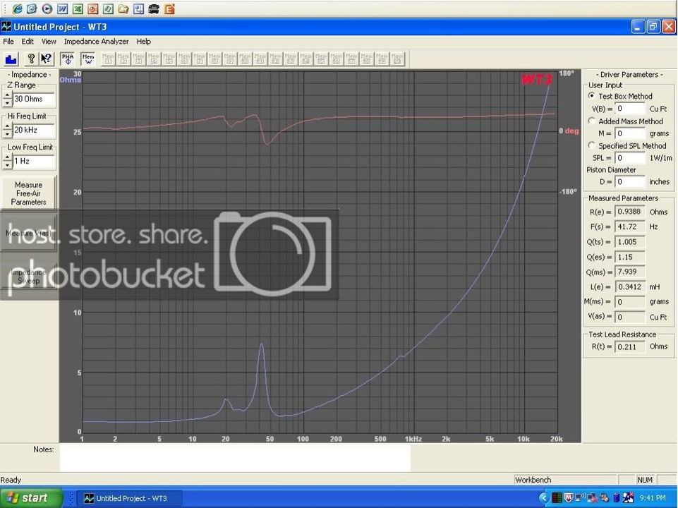

i have 2 dual 4 subs with all 4 coils in parallel, which ends up being 1 ohm, right? Well, the impedance looks like such:
as you can see, it remains above 2 ohms for most of the frequency range......but take this as you will.
edit: this is at rest, i'm sure when the VC's heat up it's higher.
