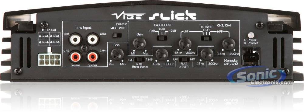

I'll have to look at everything again. I ran all new wires. It's just the front right making that noise. The amp was purchased brand new from Sonic Electronix on Ebay. I didn't really plan on buying one but I was just playing around and offered $120 shipped for it and they accepted. They sell it for $150 on their site.
first problem is the amp. Vibe is pretty poor quality. Powerbass would have been a better choice.
fader is front/rear
balance is left/right
if your fader changes left/right then you mixed up your RCA's and your gains aren't set the same. don't just relay on visual settings - you need to play a tone and adjust until both measure equally with a DMM on the output. you'd be amazed at the difference in the knob setting.
the crossover settings - what are they set at currently?
the input range is 0.2V - 6V.
The JVC has 5V preouts
your gains should be near the Min setting and you can use almost full volume on your head unit.
Yes...sadly I have found this out. //content.invisioncic.com/y282845/emoticons/frown.gif.a3531fa0534503350665a1e957861287.gif I'd rather just go back to no amp and use my HU to power the speakers.
I haven't even bothered with the crossovers on the amp. My HU has everything...crossover settings, Digital 9 Band iEQ, Advanced DSP w/ BBE High-Definition sound.
I have my gains set near minimum but there is no way I can get anywhere near full volume without losing my hearing and having it sound terrible. 20 out of 50 is pretty **** loud and this is from someone who listens to metal 80% of the time.
I should have just stayed with the HU powering the speakers.
just set the gains at full minimum then. keep EQ boost settings low.
the Type-S don't sound very good anyway, so they are another weak link. nice HU though.
so your amp crossovers are set to Flat and Bass Boost is set to 0dB?
just set the gains at full minimum then. keep EQ boost settings low.the Type-S don't sound very good anyway, so they are another weak link. nice HU though.
I got the speakers for $40 shipped and they retail for almost twice that so it's no big deal I guess. I'm just not good with knowing what brands to buy so I thought I'd try Alpine speakers too since I have a Type R sub.
Yes amp is set to flat and 0db.
