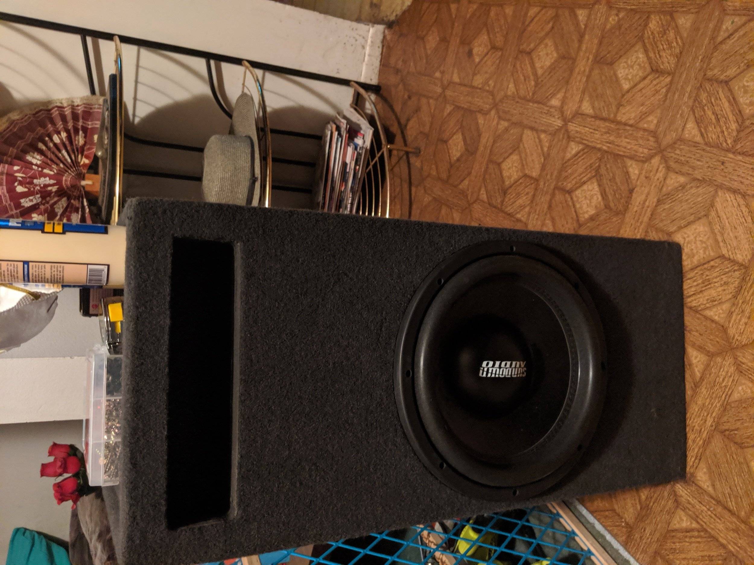

I like the my single sa12 more than my dual xfls but that might be because the single sa12 is in a box that is only a 1/2cu ft smaller than the dual box.
lol idk how thats possible but the xfls probably in the wrong box...when i compare the 2 i put both in a 2 cuft box tune @ 34hz with both getting like 1000 watts each
Take back everything I said lol
I hooked my single sa12 up again and it sounds great but the xfls you can feel in your chest. Again nothing wrong at all with the sa12 it's just not dual xfls.
I do believe the sa12 hits lower because of the box it's in. The same notes in a song rumble lower with sa12 but not as forcefully as the xfls if that makes any sense.
The fact that I ain't selling the sa12 even though I'm not using it says enough about it's quality
