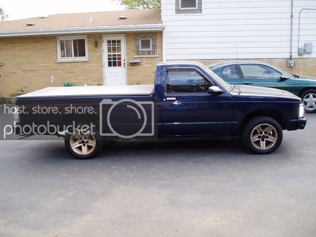

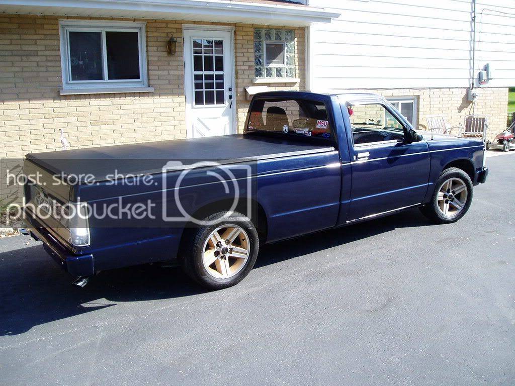

Mine rides pretty much the same because i used spindles in the front and blocks in the back, so essentially the suspension is the same. I lowered mine 2/3.
However, if I were you I would remove/relocate the bumpstops in the back so you don't slam against them whenever you go over a big bump like I do. //content.invisioncic.com/y282845/emoticons/mad.gif.c18f003ab0ef8a0d9c27ca78d77a6392.gif
Before:
After:
