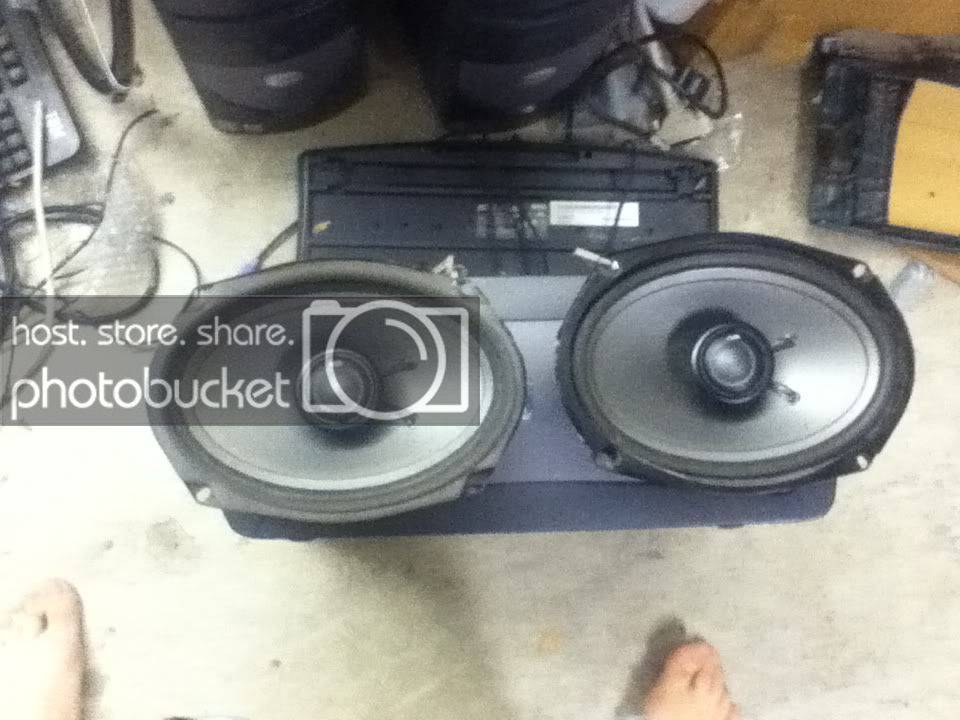

So i had a pair of polk ex tweeters i wasnt using and a set of old school RF punch 6x9's with bad tweets. I went mad professor on them and created something. LOL
HERE IS A VIDEO OF THEM IN ACTION. http://s1105.photobucket.com/albums/h359/stanky1219/?action=view&current=c361b922.mp4
sound good. the woofers were always pretty efficient but the tweeters were paper cones , now they are silk domes. //content.invisioncic.com/y282845/emoticons/smile.gif.1ebc41e1811405b213edfc4622c41e27.gif i will do a video of them playing in a bit. gotta get some stuff off my work bench to make room for a deck and amp to hook them up to.

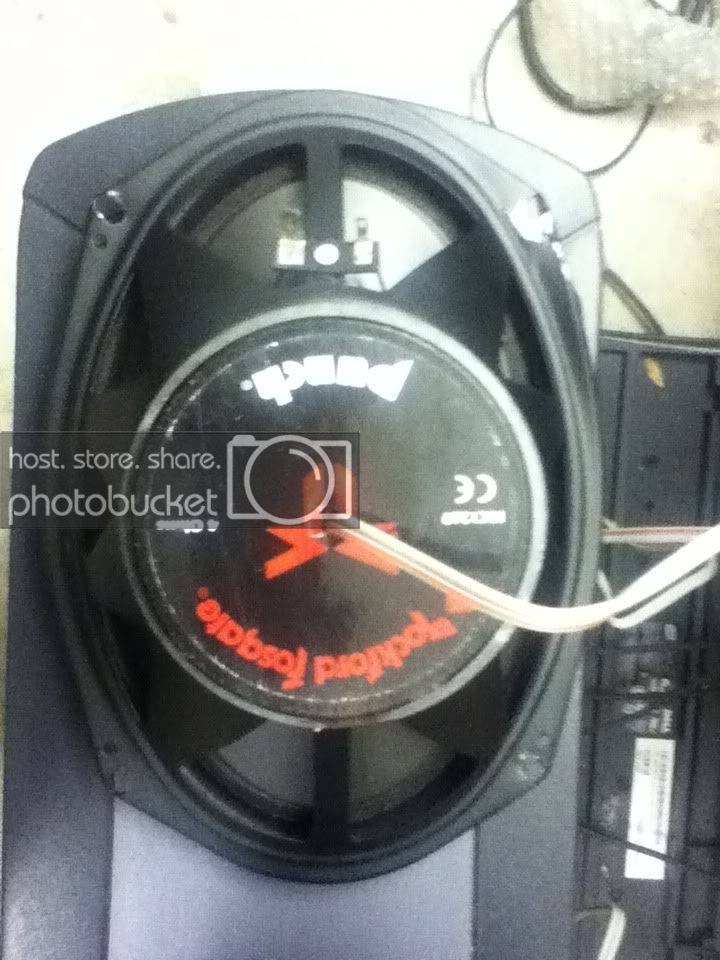

got a video uploading now. All i did was unscrew the tweeter stand , snip the tinsil leads from the woofer cone to the tweeter , rip the old tweeter out , got some epoxy and epoxied the polk tweeters to the original tweeters stand , then epoxyied it back onto the pole piece carfully. They sound great now. //content.invisioncic.com/y282845/emoticons/smile.gif.1ebc41e1811405b213edfc4622c41e27.gif will post vid when its done uploading
