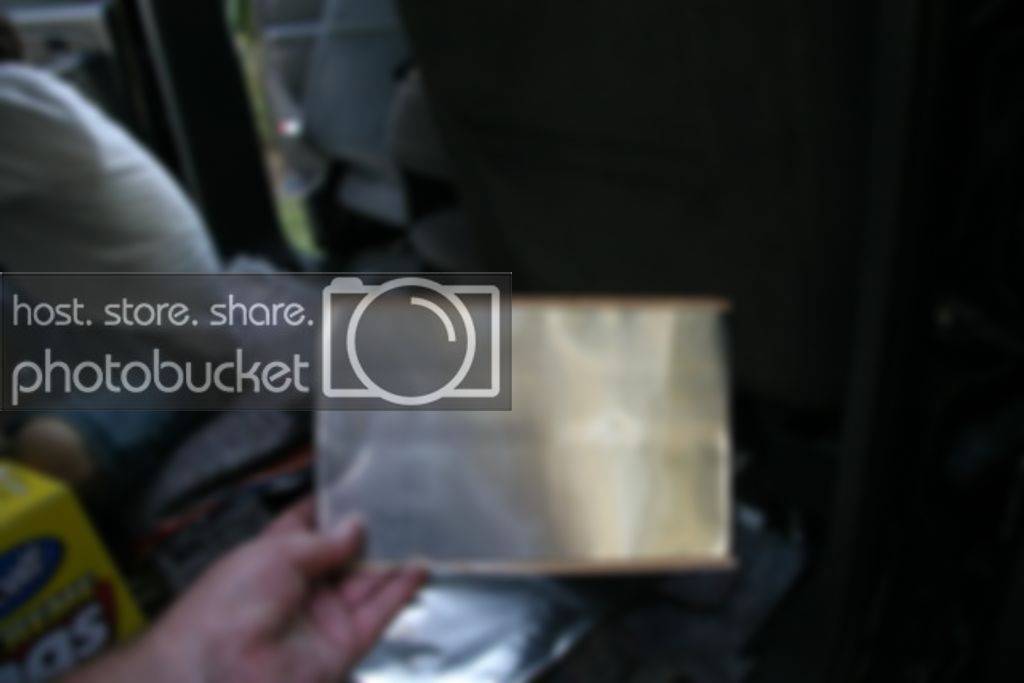

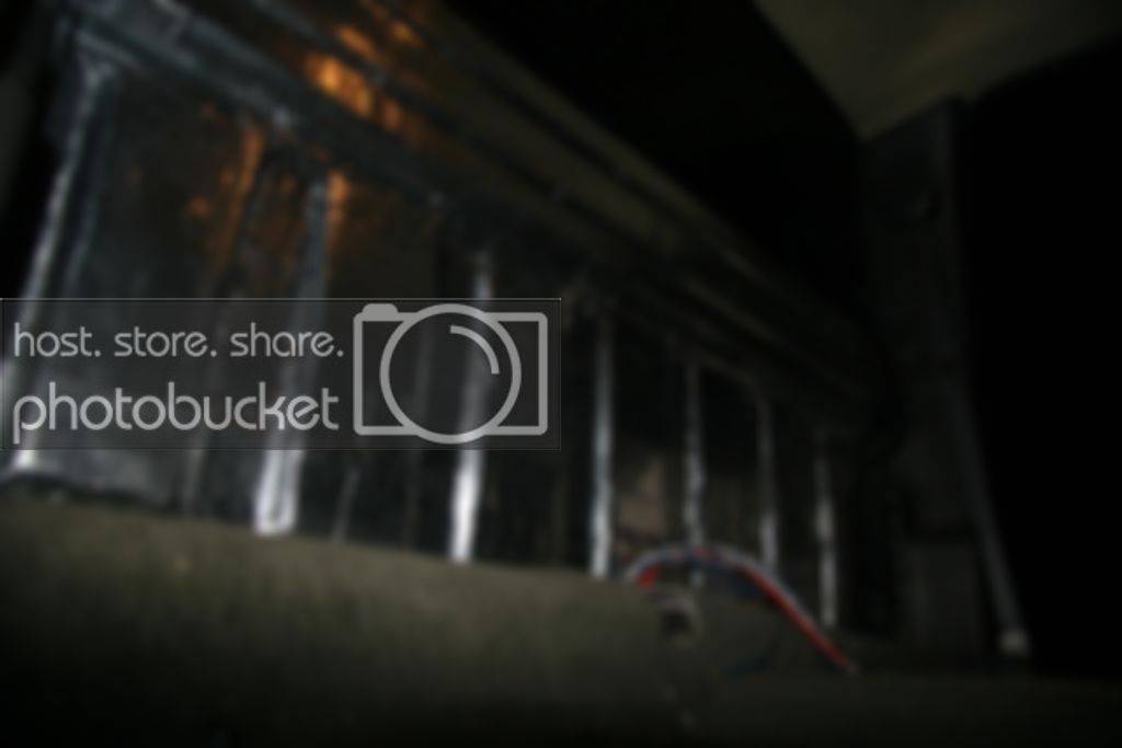

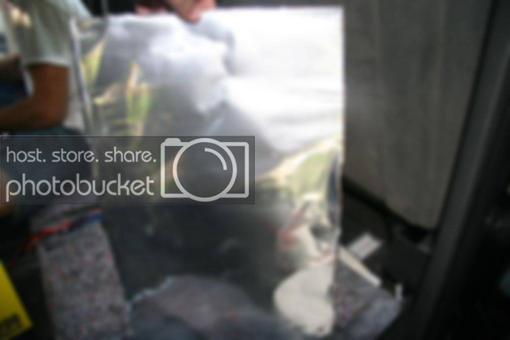

The first photo is of the area to have the damp pro and the spl tiles to be installed.. In the back wall there is a ridge and I was able to take the SPL tile and form it to the shape. Then I just pulled the back off and it kept the shape I just made very well due to the foil being so thick. It looks like a sheet aluminum with sticky stuff on it, is the best way I can describe?

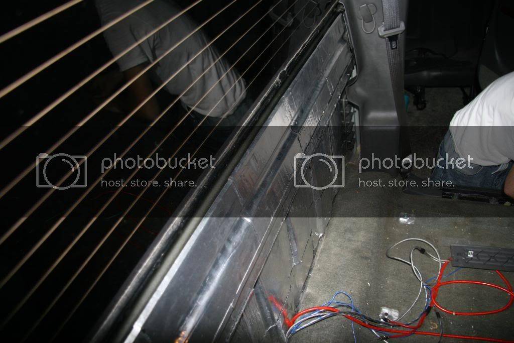

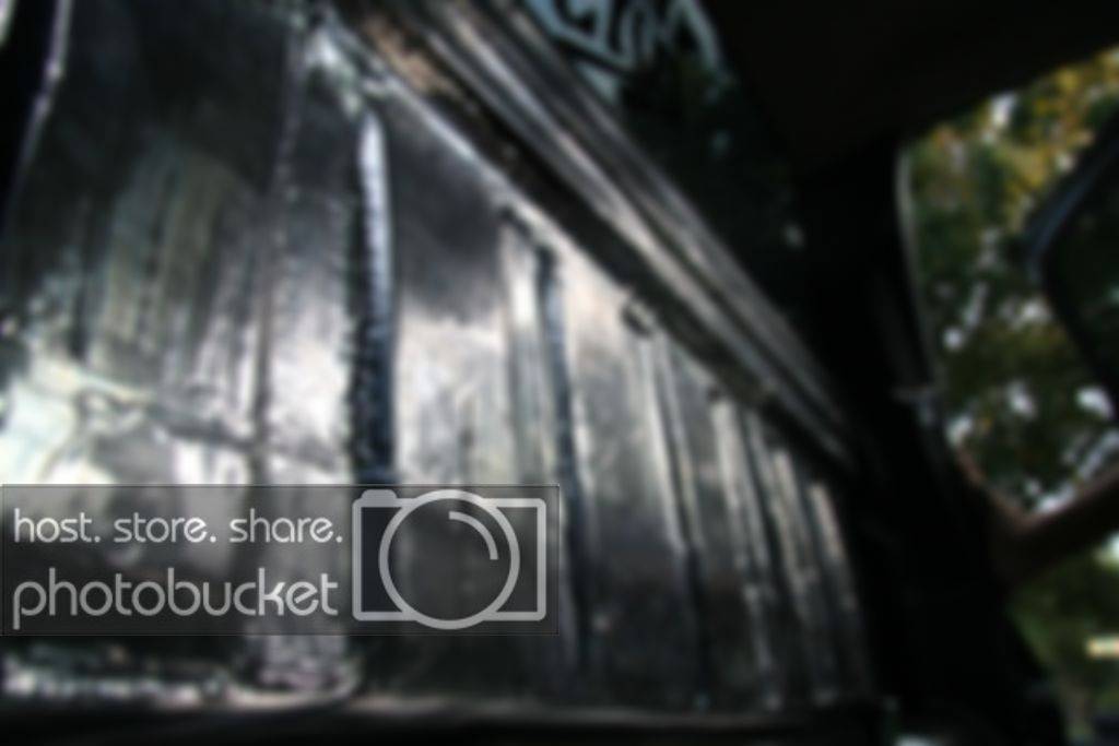

I started on the back wall at the top. Due to the top being a bit weaker I used 10 SPL tiles across there very top (6 full sheets and 3 cut in half across). I must say I thought the SPL tiles would be a pain to cut but I was actually able to cut them with a pair of scissors.
Got a little messy on the fingers with the damp pro. On a scale of 1 to 10, messy wise maybe a 4 where fat mat was maybe a 2. But the Damp Pro is MUCH more sticky so it's worth it. //content.invisioncic.com/y282845/emoticons/smile.gif.1ebc41e1811405b213edfc4622c41e27.gif

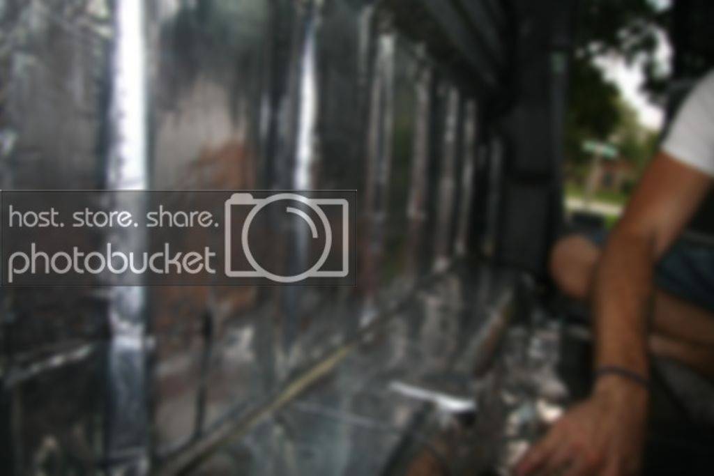

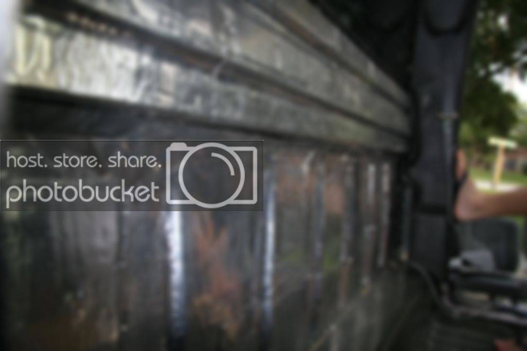

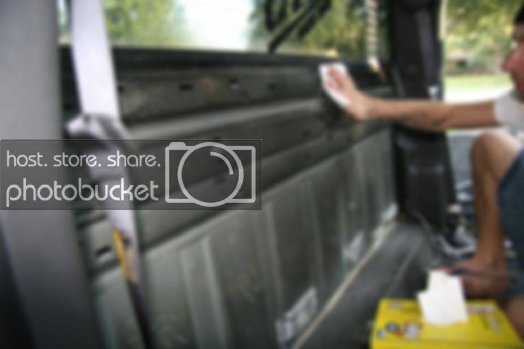

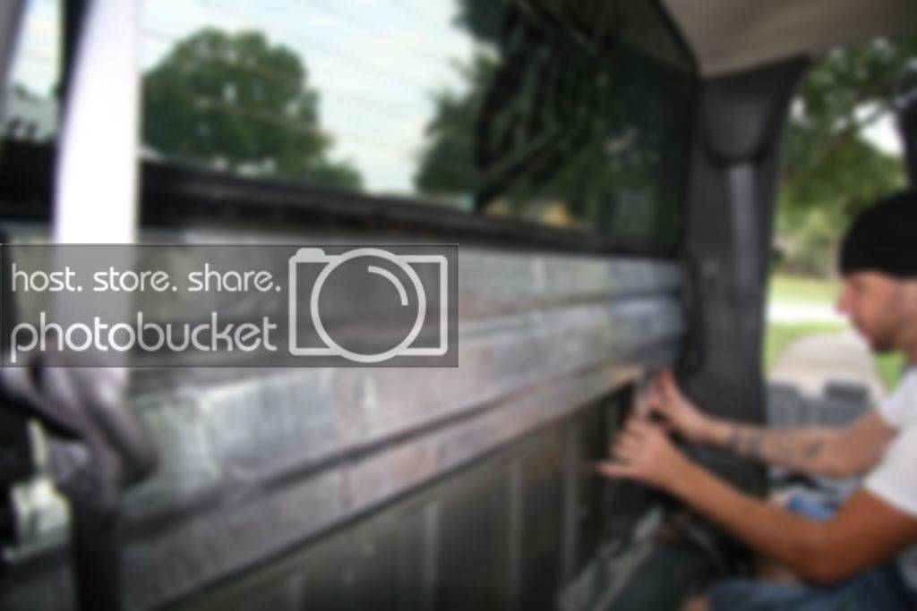

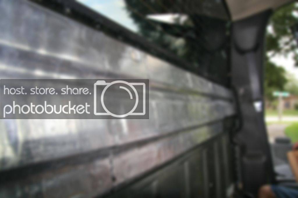

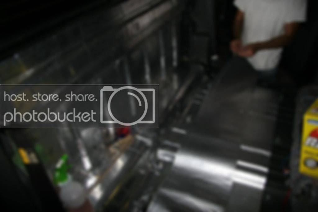

Next is the Damp Pro on the main wall. This is kind of a pain as it has a lot of "humps" in the back wall and has to bend like 2 different ways.

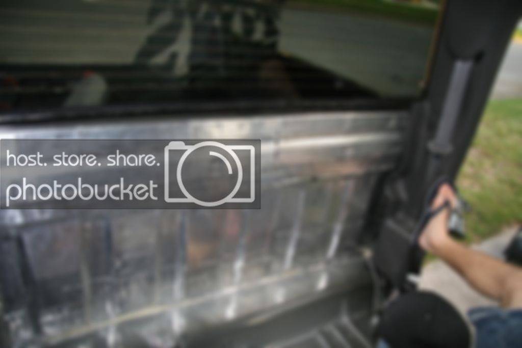

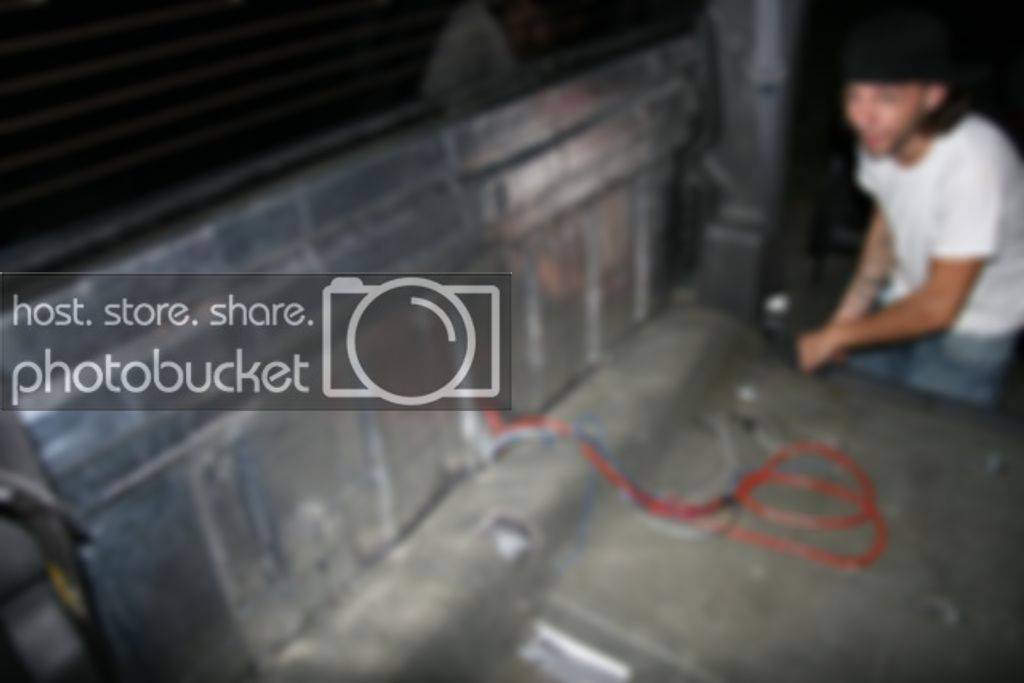

Then on the floor there we laid it down. It took 3 sheets to do this and that is the end of my Damp Pro.
Next is the floor under the 1/3 seat and where the false floor will be put in and box on top of that. Unfortunately, I did not have the money for Damp Pro but found a deal on Edead 45 mil. I must say this stuff feels funny. It's not a foil, it's like a plastic on the bottom that you peel off and the top "looks like" foil. I think its foil colored plastic? Cheap. But I got it cheap so I thought I would put it down on the floor since it can't slide down or fall off. Since it's SO thin I will have to cover it with Edead V3 paint on deadener tomorrow. So Edead = 2x the work. //content.invisioncic.com/y282845/emoticons/frown.gif.a3531fa0534503350665a1e957861287.gif
So here is the finished product for tonight. All Second Skin is installed plus about 15' of Edead 45. The back wall will have a 2x4 run across and MDF on top of that screwed down on the back wall covered in Edead V3 and carpet to help brace the wall a bit. I will also be putting tennis balls between the back wall and the beed to reinforce it a bit more, about 3 of them across the back.
