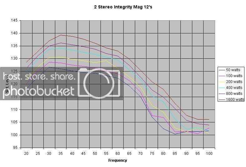

First off... 2 SI mag 12's
Not a whole lot to say about em.. they wang.. hard..
after frequency testing... I picked the loudest frequency and went full power on the amp... rolling volume up until spl maxxed out, and recording current and voltage to establish wattage.
at 40hz, the mags did a 141.1 db, with exactly 2000 watts
at 35hz, the mags did a 141.8 db, with 2116 watts
at 30hz, the mags did a 138.7 db, with 2280 watts
no issues with the drivers to report.. fully capable of handling the power levels provided...

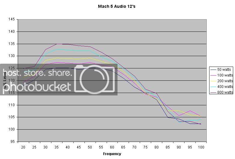

next up, we loaded the Mach 5 Audio 12's into the box..
Testing was stopped at 800 watts, due to beginning driver stress (I was being very cautious today for some reason)
we then found loudest frequency, and let the 20.1 loose on them.
@ 35hz, the Mach 5's did a 138.2 with 1843 watts
@ 40hz, the Mach 5's did a 137.3 with 1050 watts

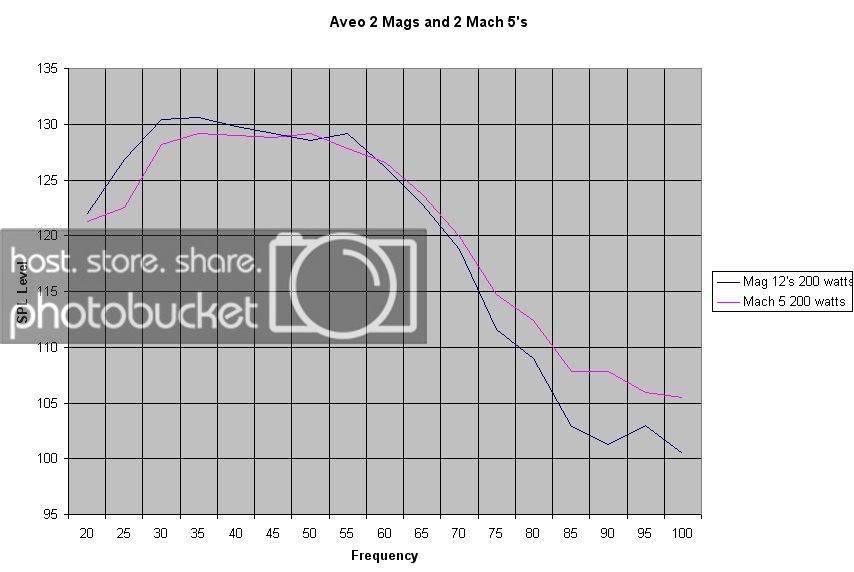

as you can see from frequency response testing, to this testing... the Mach 5's have a good flat response.. but ran into some compression

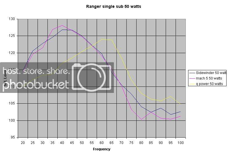

Next.. we switched it up... A friend came over with his 94 Ford Ranger, ext cab.. and he has a single 12" box, thats 2.0 cuft, tuned to 32hz via slot port, with a 400 watt orion amp for power..
we did this to show you the difference between vehicle boosting acoustics.. the ranger has a much smaller cabin, therefore.. its easier to pressurize the space.. you'll see from the testing numbers.. they are significantly higher in the ranger..
all the same test methods used in the aveo, apply here..

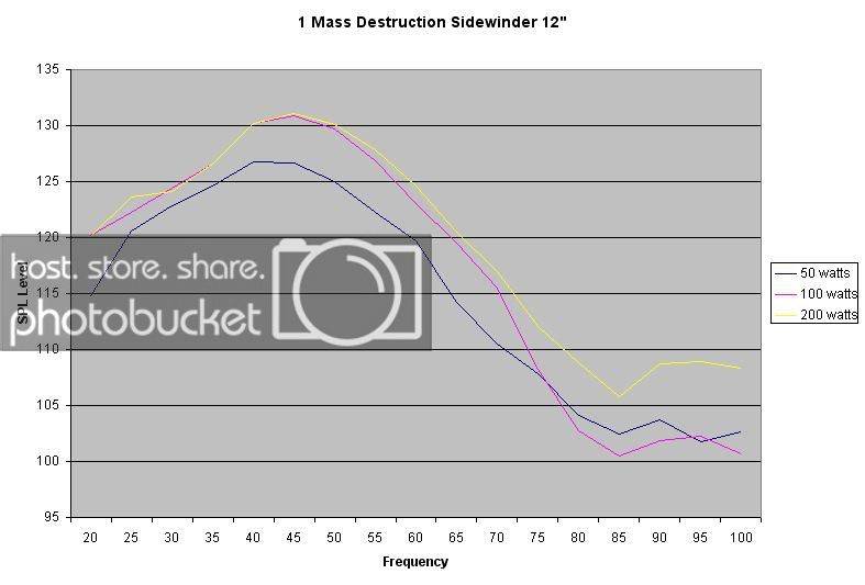

first up... a Sidewinder 12 from Mass Destruction Audio
testing was stopped at 200 watts due to coil fatigue..
after a rest, we then turned the orion loose on it... lol
at 45hz, the sidewinder did a 131.3 with 515 watts
at 50hz, the sidewinder did a 130.6 with 528 watts
As you can see from the graph.. the woofer ran into severe compression with 200 watts... it's not exactly a power happy driver..

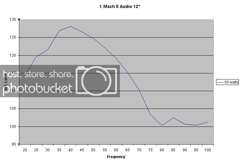

Next up, a single Mach 5 Audio 12"
we did not get to progress testing past 50 watts, due to the speaker developing a coil rub clanging with 100 watts.. after investigating, this was due to spider deflection.. in which I'm working on fixing..
at the least you'll be able to see the difference in cabins from 1 12, and 2 in my car, with 50 watts..
Issues.. suspension geometry... I'm working on a solution for that I think..

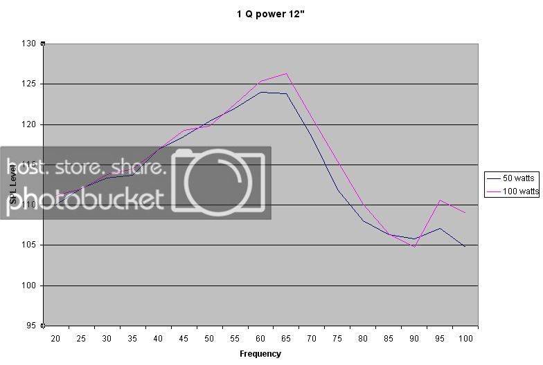

Finally... the almighty Q-Power 12
as you can see... no low end extension... but she got **** loud in the upper frequencies.. and handled the 100 watt test without failure..
issues... its a 6 dollar speaker... do I need to go into it? lol
to finish the day... the q power had to die..
to its credit.. it took over 400 watts for nearly 2 minutes @ 65, and then 20 hz before it died.. vids will be posted //content.invisioncic.com/y282845/emoticons/smile.gif.1ebc41e1811405b213edfc4622c41e27.gif

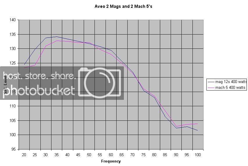

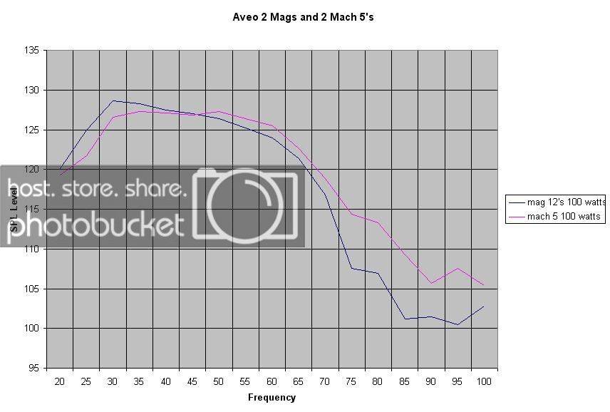

More Fun Graphs! Mag's and Mach 5's in the aveo, power v/s power
50 watt
100 watt
200 watt
400 watt
800 watt
This last one.. is from the Ranger.. single sub box... 50 watts
