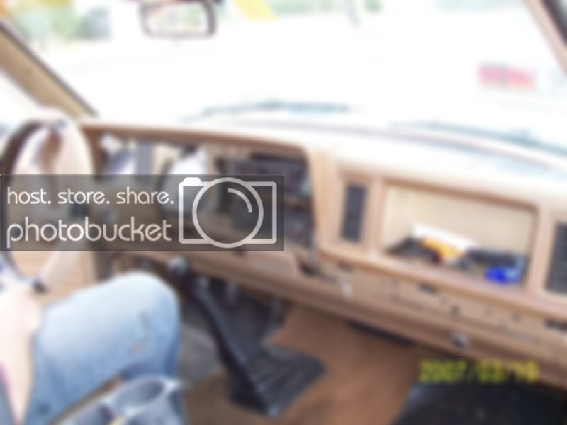

bored so i will post what i have done so far yeserday.. today have a lot more to do .. but getting somehwere.

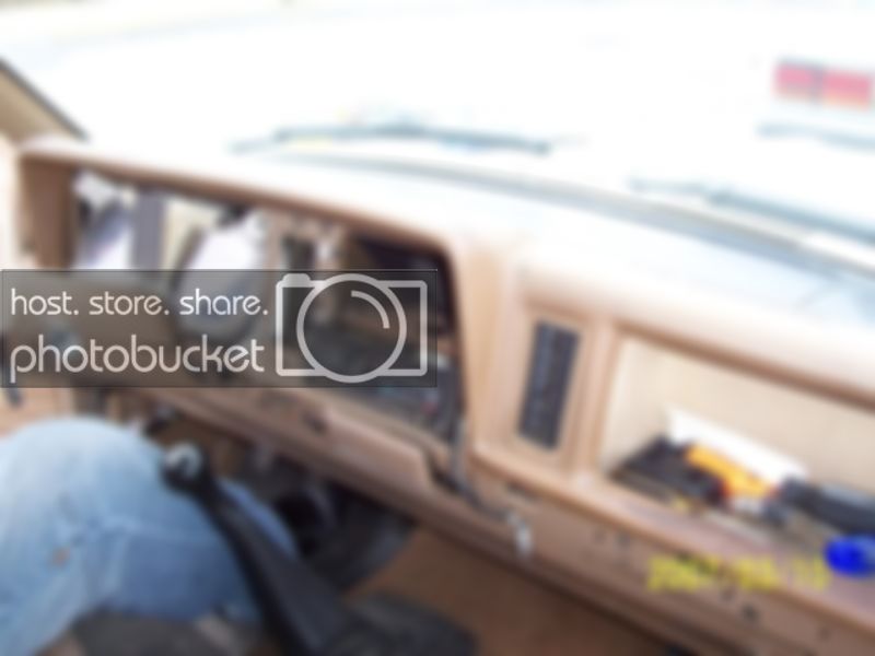

this is whats going in... lol..

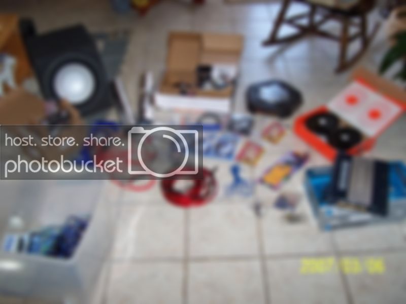

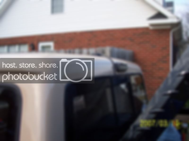

and what ive been doing with my free time.

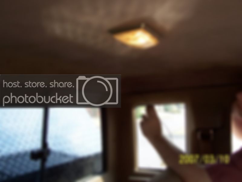

looks good! all i would suggest is to pull ur sat antenna and run it threw the the bed light hole becuase it should go into the cab of the truck u just pull that trim peice and pull the headliner down a bit and snake it in. will look better and less of a chance of it getting cut.

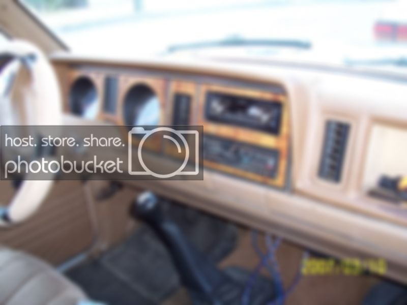

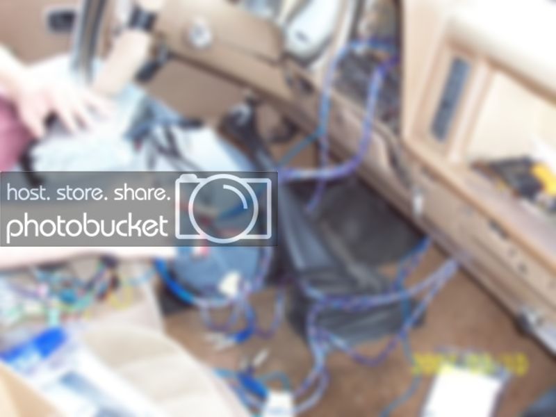

overall i got quite a bit done. I also mounted my crossovers and wired up the tweeters.. oh and ran my 4ga power wire. so all thats really left is mounting the tweeters, but waiting on some music so i can stage it right and putting in my distributions blocks and fuses. I still have to pick a grounding spot.. and finalize where these amps are going to go as well as the sub. Then its all just hooking it all up.
I already have some ideas for cleaning up the wires.. I have already ordered a custom dash cover and I am going to cut a hole for the SS speaker grills when i put them up there.. that will cover all the ugly spots as well as the wire thats exposed and give it a nice clean stock look. The same concept is going to be used by the gear shift to hide the RCAs and such.. going to cut some carpet and place it over the gearshift so that its covering all the wires. I really need one more solid day of installing to get this done. I still have plenty of deadening to do but thats going to have to be another day.. I need sound to deaden before i start that.

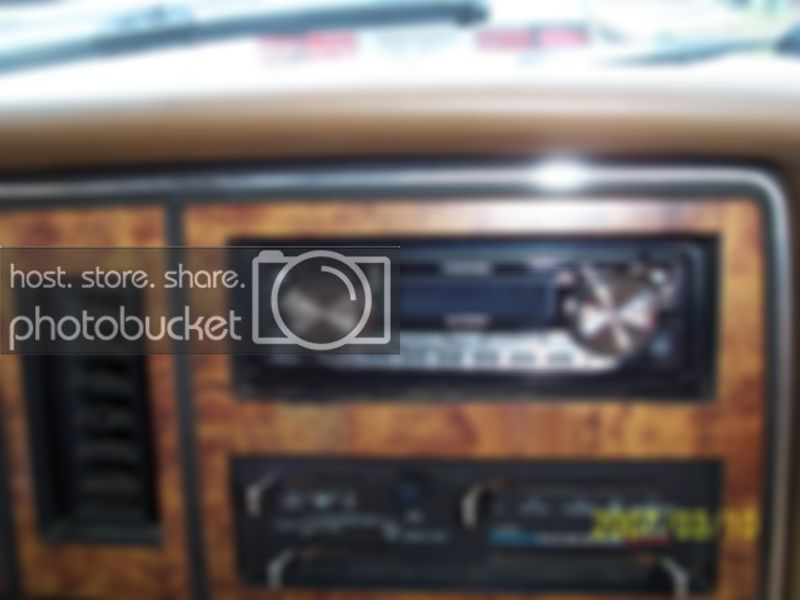

well finally i got everything hooked up. ITs been a rough day though. First the high amp wouldnt come on. Found out my power cable came loose on it and was off. Fixed that. Then my headunit decided to just die and not power back on. I pulled the fuse in the fuse box and put it back in.. bam worked again.. no idea wtf that was about. So now I am still tuning it but I can tell you this. The gains are set very conservative on both amps.. and this truck is louder than I thought by far. I made sure that my box was totally airtight and it made a huge difference. That Kappa Perfect is pounding away. The highs are crisp and the mids are real tight thanks to the baffles. Turn it up and it gets ear piercing loud and I know it can handle more power but I don't need it. So all thats left to do now is hide all my wires and ill take some more pictures once i finish. I can say this though those JBL GTO speakers in the rear really suprised me in how detailed they sounded for being coaxial.. very impressed. The front soundstreams are very strong for their size. You can hear a small gap in the midrange as they are only 4" drivers. I think once i tweak the settings some more I can get rid of it. I can say i hear 0 static or interference. I would say all in all it was a success for a budget SQ set up. My ears hurt though at the moment and so does my head from seeing just how much guts these speakers had.
On a side note: I do notice dimming on full power so I will need to look into that next.
nice install especially the HU. It looks great and secure. How do you like the EZ series kendwoods? I think they look retro (a good thing). I've never tried them before, but how about thoes baffles, so they work? They seem to make sense. All in all a good simple clean install.
