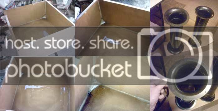

look on the bottom of that box,see how shiney it is in the light? that is resin that has self-leveled .... all you do is make up enough resin to fill the entire surface of whatever side of the box you want to coat by at least 1/8th inch......then DO NOT BRUSH IT ON ANYWHERE, just let it sit and cure and it will be perfectly smooth once its done.

i lost db's resinin the whole inside //content.invisioncic.com/y282845/emoticons/frown.gif.a3531fa0534503350665a1e957861287.gif gained from resinin the port though //content.invisioncic.com/y282845/emoticons/wink.gif.608e3ea05f1a9f98611af0861652f8fb.gif
