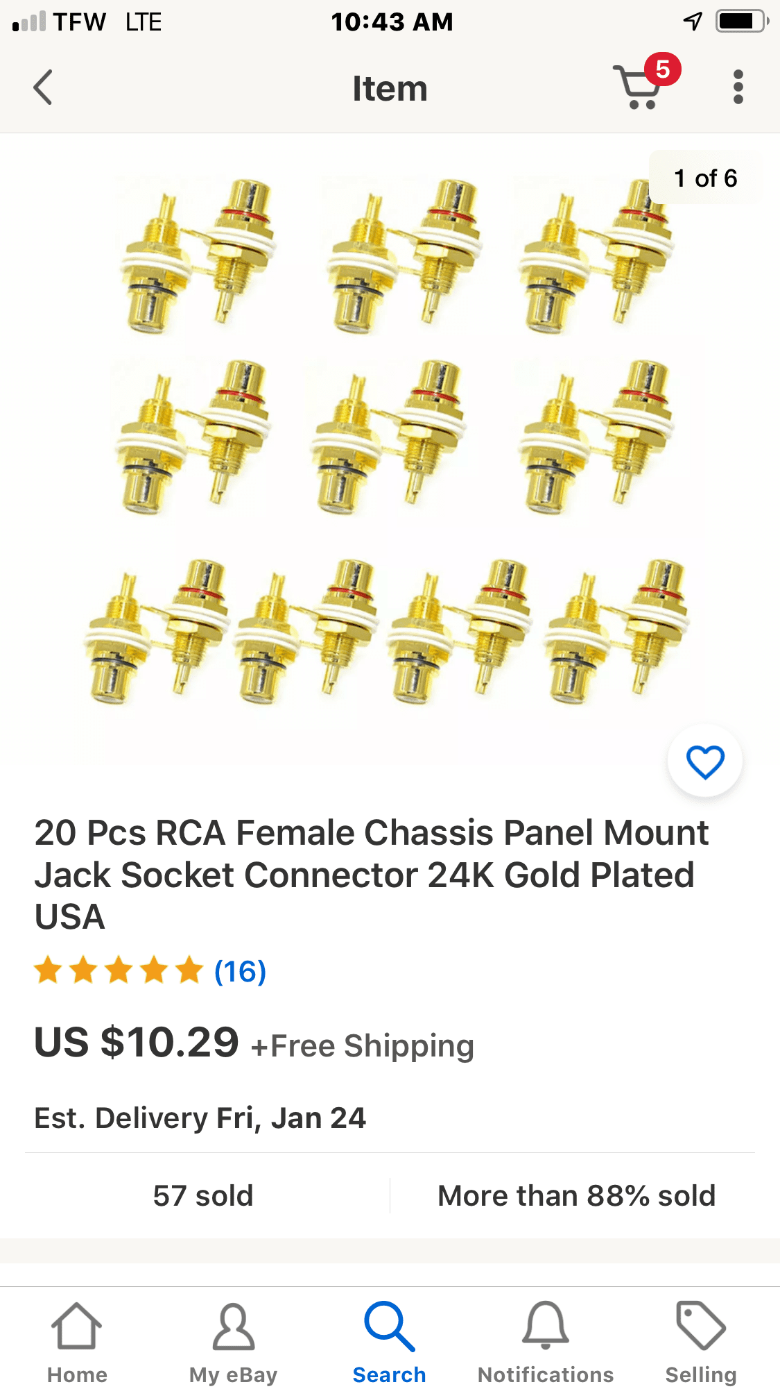

Thanks...I'll give it a shot this weekend. The RCA connections themselves on the H800 didn't impress me too much...half of them pulled right out of the unit when I removed RCAs.

I’ve had amps do that .. if able upgrade the RCA’s to chassis mount style a far better connection . I don’t know how to add a link by phone but I photo shot what I’m talking about you can find these on search on eBay ..these are fairly cheap good reviews and would make a nice upgrade over the cheap Alpine factory RCA sockets
