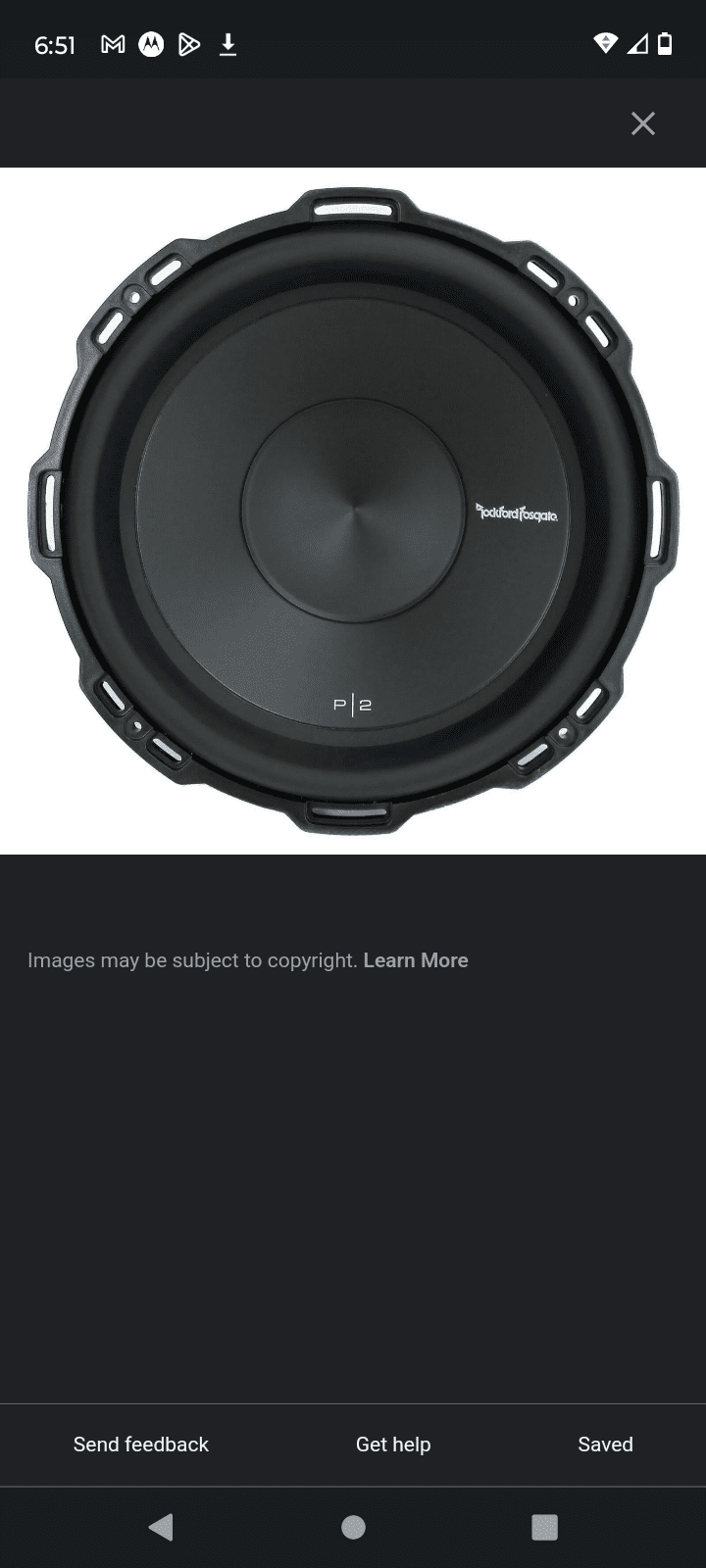

Anyways, one of the items I made out with was a Rockford Fosgate P2 D4. Gonna throw it in a sealed box in my truck. However it looks like the gasket, which is attached to the surround, is disconnected about half way around the circumference of the subwoofer where the gasket/surround meet the landing on top of the basket.
I know I can fix it easy with adhesive and clamps but the question is should I remove the surround/gasket completely and redo it all or just the part that is disconnected? Also what adhesive should I use? Is there any good one that I can go pick up at Lowe's or home Depot?and any tips?

Well I've never owned a Fosgate sub before but this one appears to have the plastic gasket that's attached over top the edges of the surround that you screw into. If you pull on the plastic, the surround comes with it without separating

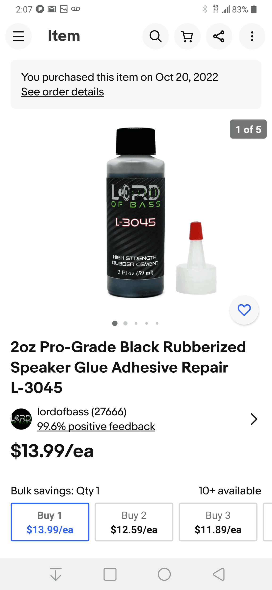

E6000 is a good glue for this.
The best repair would be to lift the entire surround from the frame, remove the dust cap, shim the voice coil, and then glue / clamp the surround. This is a solid long lasting repair.
However, if you were trying to do as little as possible:
You could try scraping the frame where the surround has lifted, remove any old adhesive that remains, spread E6000 all along the frame, use a tooth pick to get it into the edge where it is still holding, clamp the surround, then quickly feel if the cone moves without coil rub up and down, then let it dry.

Pretty much what I just got done doing. I got it in on a trade so I'm not too concerned about it. Just picked up some e6000 from Walmart, hand ful of clamps from harbor freight, took a small flat head and scraped all the old glue off (Fosgate really skimps out on glue) and then sanded it with high grit sand paper. Then I put dabs of the glue on every surface possible where the gasket/surround attaches. Now I got like a dozen or so clamps on it waiting for it to cure.
