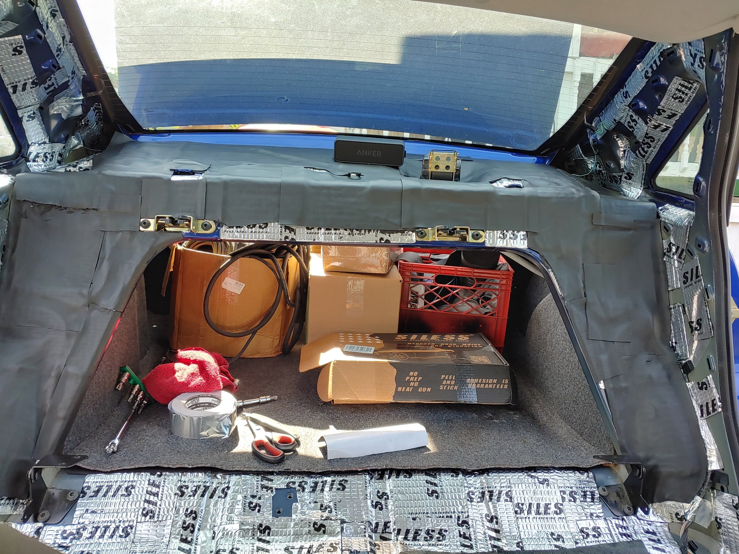

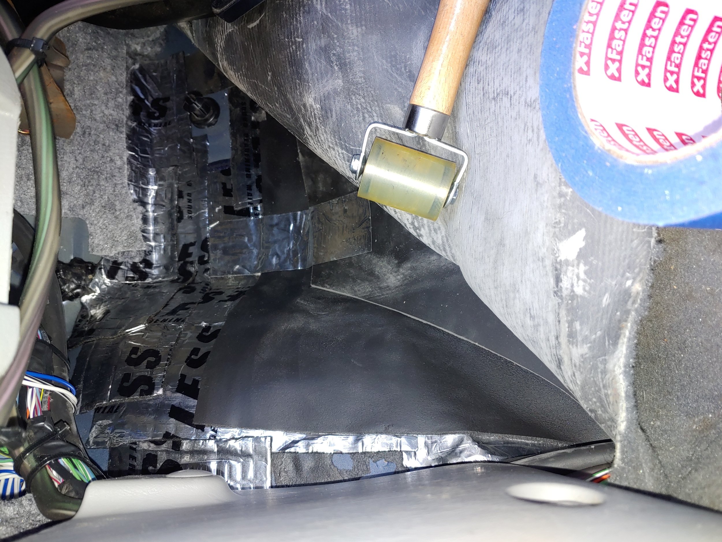

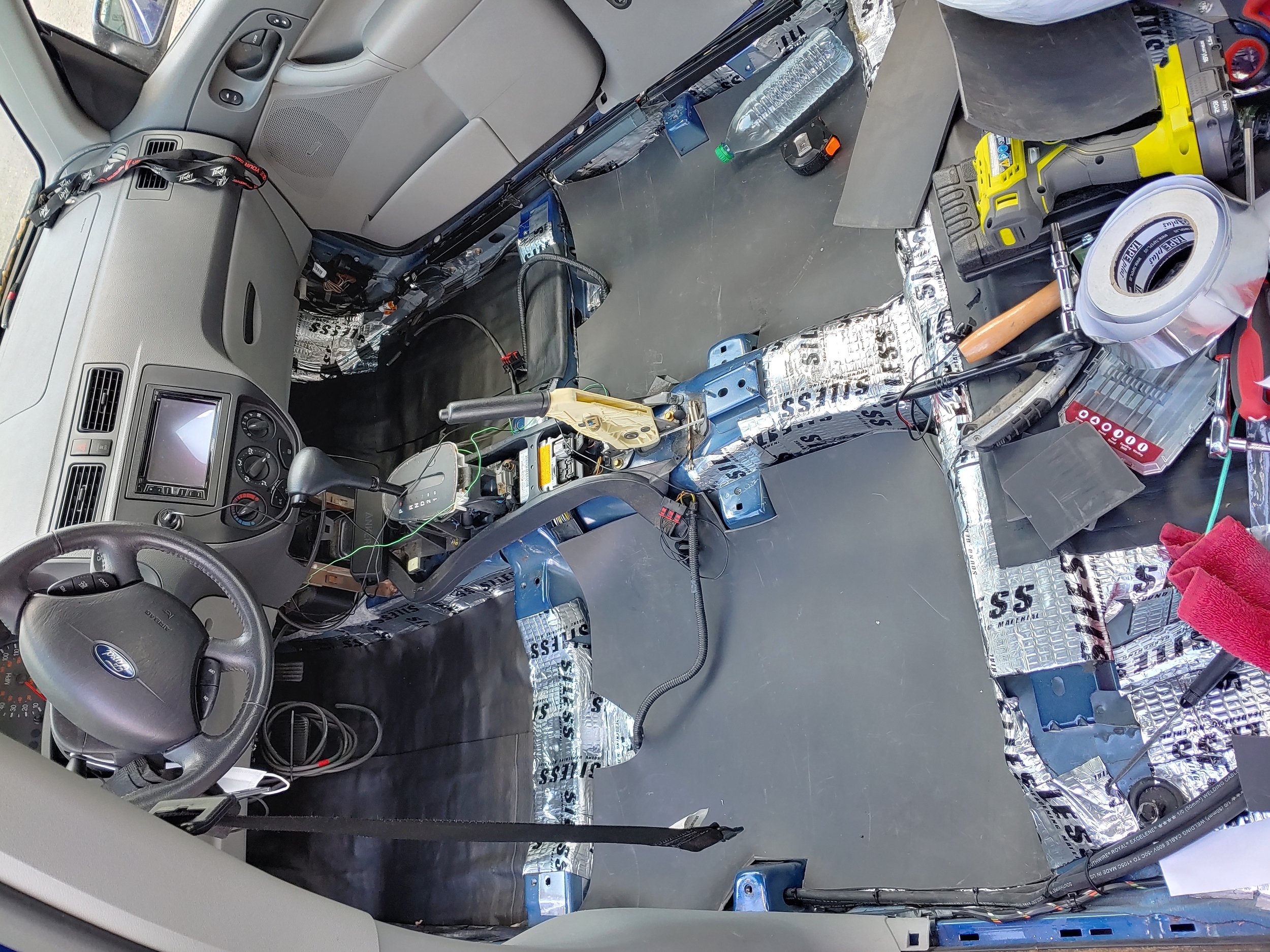

It gets expensive quick. Remember we want the MLV to have the ability to move so some aluminum tape in the right spots secures it and allows it to float. (see third photo.)
Let me preface it by saying that no one needs to go as far as I have. A good portion of my budget (+$1000) is dedicated to this ..and I'm clinically insane.

View attachment 42207View attachment 42208View attachment 42209
