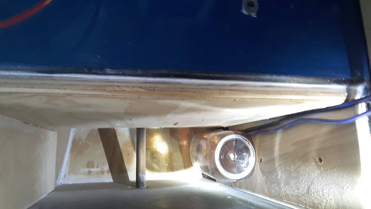

Then due to the added power I had some enclosure surgery to do. 7.6ft3 then to 7.1ft3... finally around 6.7ft3 seems to be where I need it. I've closed up the port area a bit to 111in2 and kept the tuning close (around 42hz... best guess I got). I removed my preamp/eq and set gains a little better (DD1 and all). I had to get assistance with the reconing as my hands lack strength and fine motor movement skills but it got done.
I think I'm getting closer to my goal and will meter it soon. After the recone I blew my dustcap loose and now it's mufugly with CA but solid after fixing the issue.
At .5 nominal I sure need more current but it IS a difference for sure. Not setting records here or anything but for a daily single 18?.. :)
I've never made an enclosure last so long or go thru so many changes... lol... this one started at 9.07ft3, then I cut it down to 7.6ft3, added bracing/45's to take it around 7.1ft3 and is now around 6.7ft3/42hz after more bracing/45's and doubling up the inner port wall.

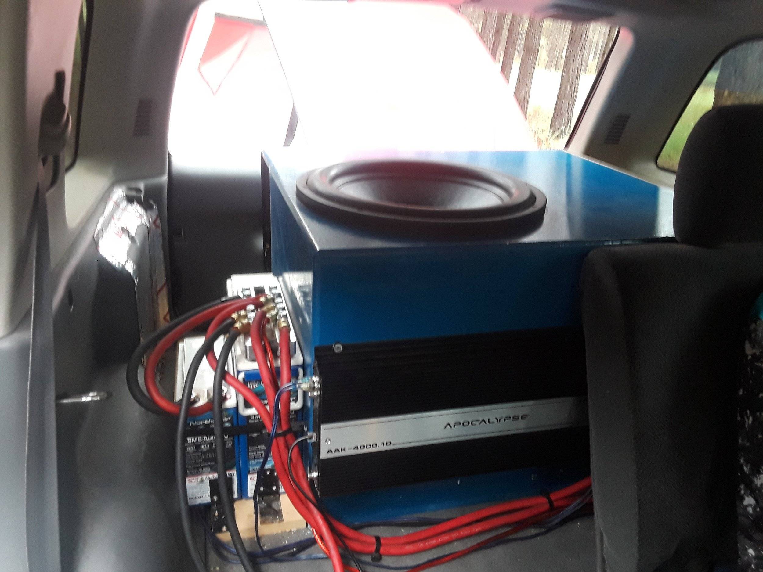

With only a few burps testing, that small port area change did make a real difference, so I'm hoping the volume change will let me use all the power. This AAK-4000.1 is pretty strong at .5.
I'm very happy as is but looking for more as usual...🤣

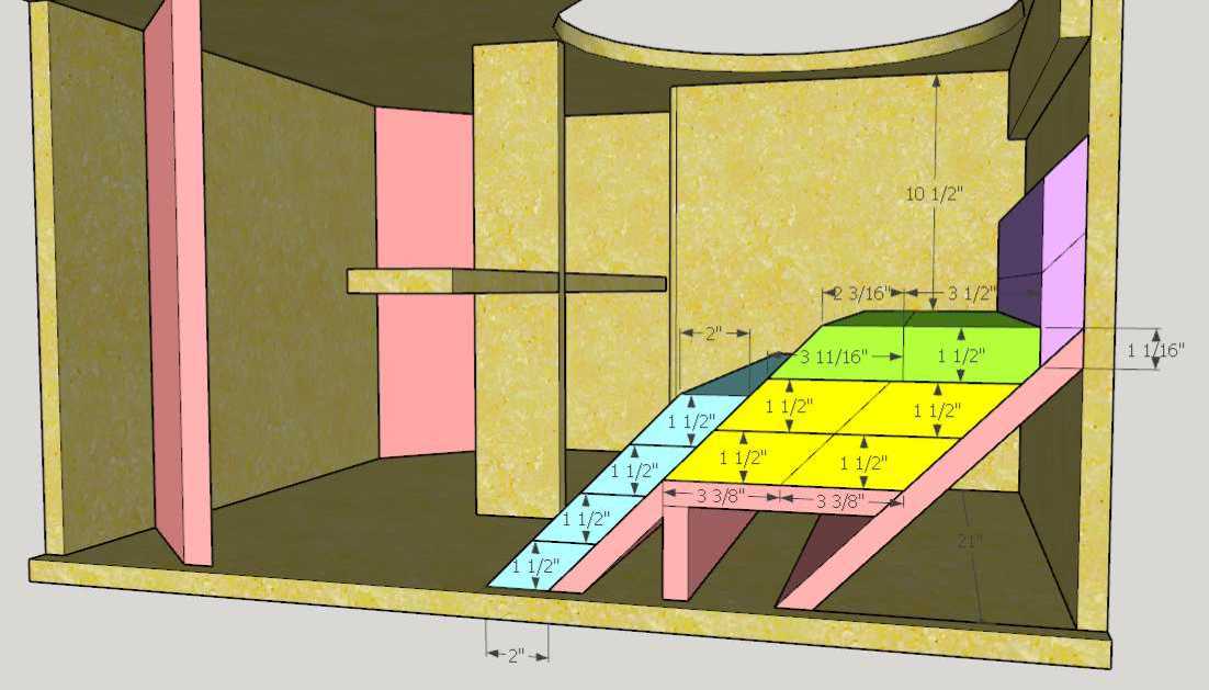

Jeez... look at all this nonsense... blue, yellow and green needs to be added to close up volume. The tan, pink and purple is already previously done.
I remeasured and ran some #'s and I'm around 7.1ft3 net tuned 39hz or so currently.. with the change in volume I should be around 6.5ft3 net tuned just under 41hz. Hopefully that will allow the sub to handle the power better... there's another event in Oct locally coming up. I'll probably fart a 45 on that day... lol
