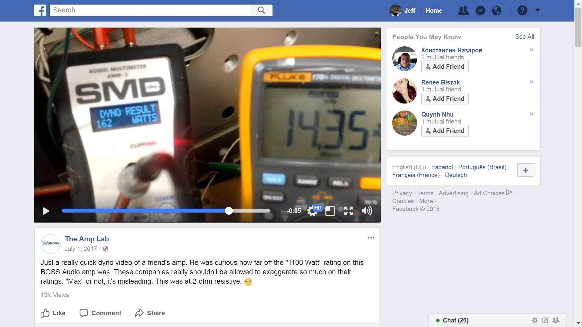

I highly doubt its getting even close to 75 a sub. It might as well be on head unit power.
This is a so called boss 1100 watt amp. being put on the chopping block. Only does 162 watts.
