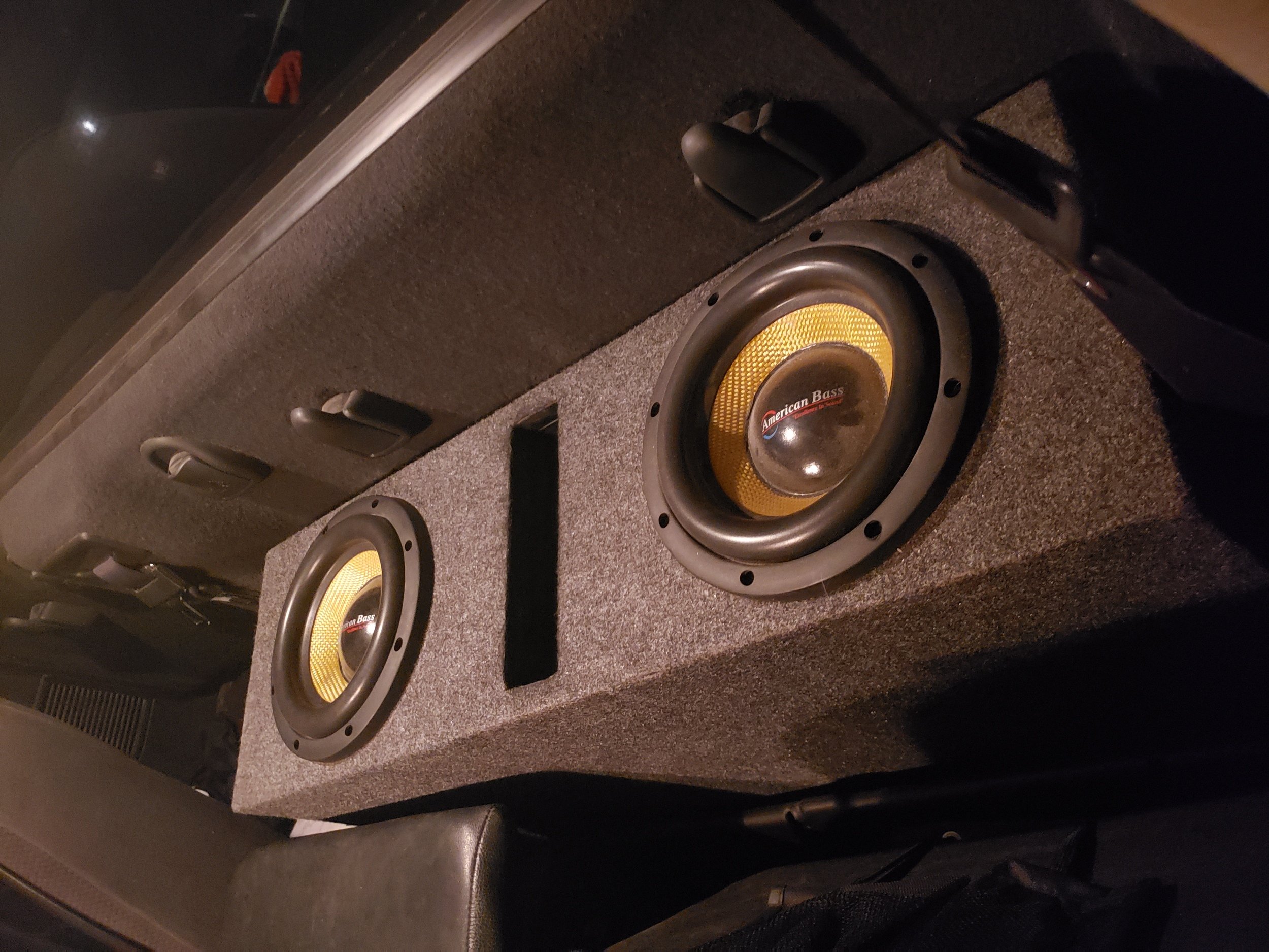

Two American Bass VFL8's @ 1ohm on a DD M80 (900@1 ohm). Sub up port up and behind the seat. I'm 5'11" and drive very comfortable. Box is 9.5" top and 10.5" bottom. Loud and cleanView attachment 19540
