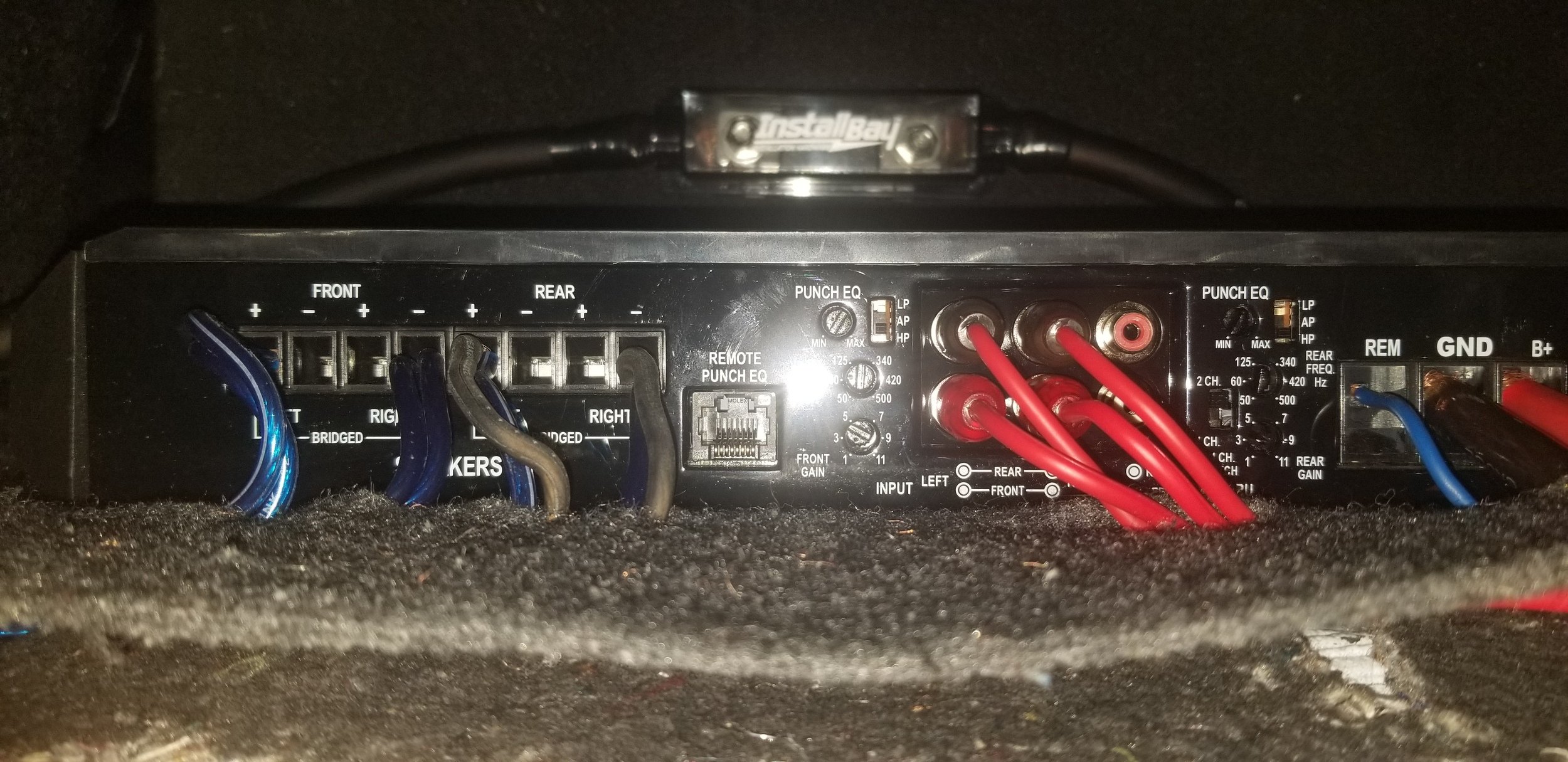

You shouldn't be bridging those I wouldn't think. It should be one per channel on a 4 channel amp @ 4 ohms each. If you bridge you're paralleling the two channels effectively making it 2 ohms 300 watts for 2 speakers. What are the speakers and the specific amplifier?

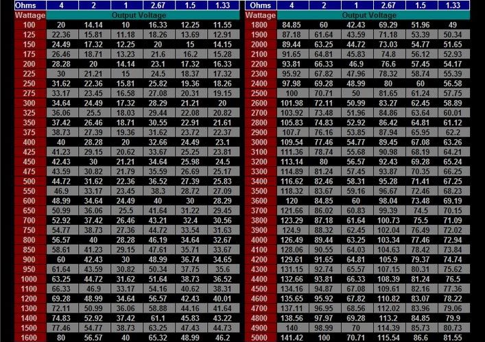

Are you overdriving those speakers? They're rated for 70W so you'll need to use the multimeter to set it up using ohm's law and a 0db tone. Disconnect the speaker and measure the AC voltage coming from the terminals, how high is it?
Do one channel at a time, it should be under 17V peak. 17V is approximately 72W.
Use the tones on that page, whichever tone generates the highest voltage at the highest listening volume you use is the tone you go with, just make sure it's 0db.

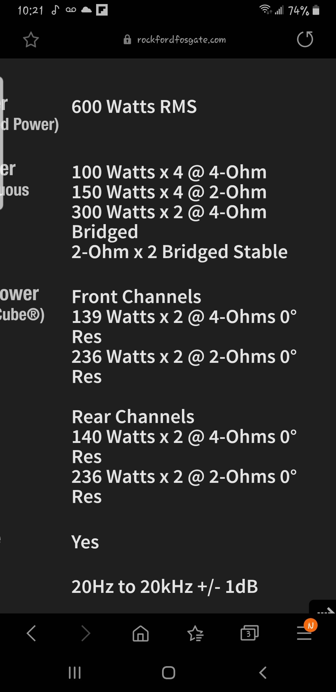

They are hertz energy ecx 165.5 2 way coaxial rated for 210 watts running off rockford power 600.4. So I dont think I'm over powering them. Just tried my multimeter and I must have left it on and it killed the batteries lol. So I'll have to go get new ones tomorrow as I dont have spare ones atm

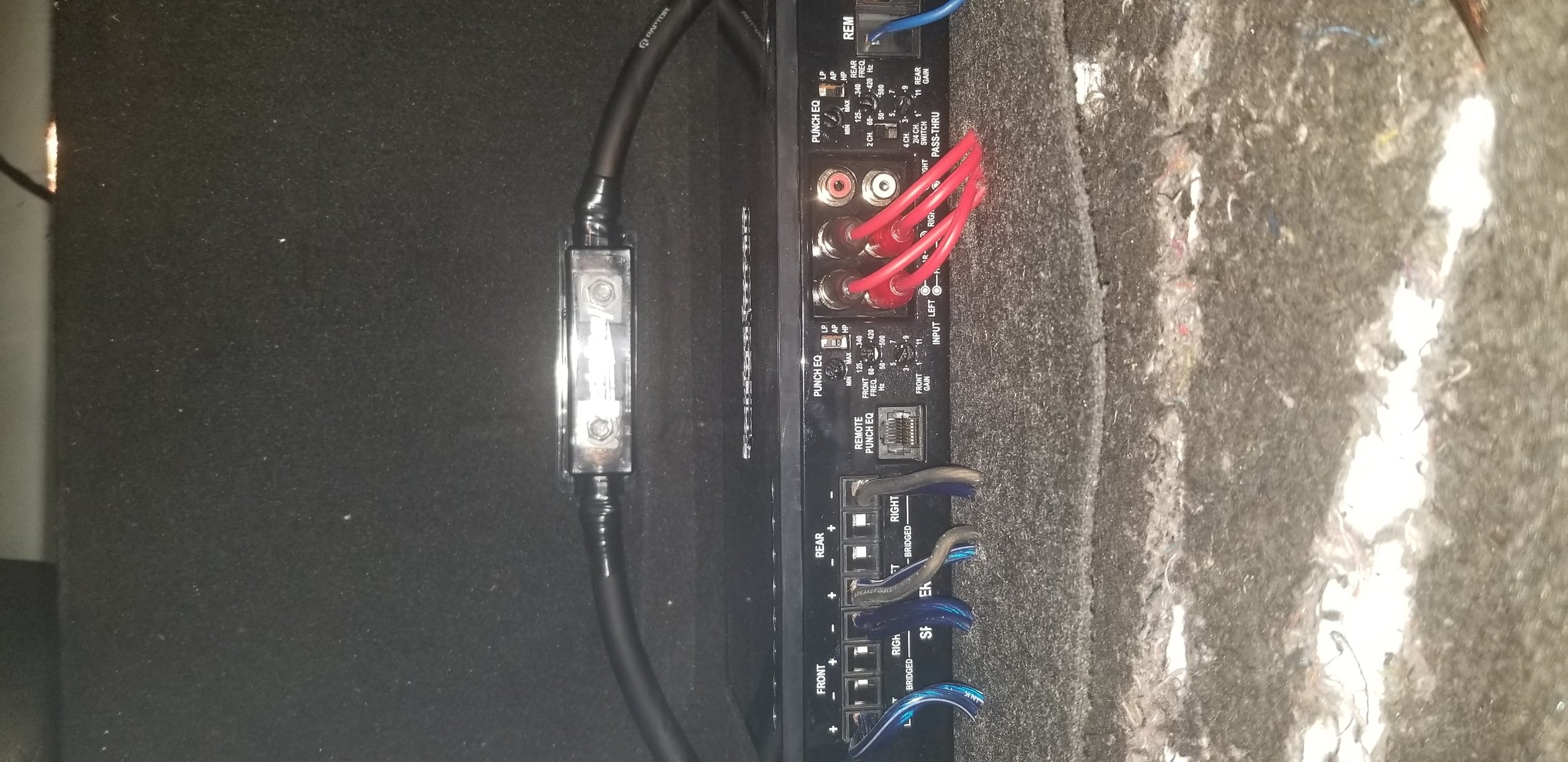

. I'll attach a pic of the amp and how its setup

Continuous power is 70W. Peak power is more of a marketing thing, but with Hertz speakers it's what it can handle briefly, not full time. You need to get those things lowered down to something more reasonable. They can be run a little bit above RMS rating, maybe like 10% full time but not 300%.
I think the issue is that you're going by the wrong numbers, peak or max is meaningless on speakers for setting them up. It's completely different between brands and on cheap brands it means literally nothing. Continous or RMS voltage is what you want to go by. It's not that big of a mismatch though, it'll still sound good and the amp will still perform pretty well at 70% power if you do 4x4ohm. Hertz is a great brand that can put up with a little abuse on top, just not crazy amounts.
Hmm ok. Maybe the issue is that they are bridged then getting way too much watts. I'll see if I can find a set of spare batteries in the house. This store literally said they would be perfect to run bridged at 2 ohms on 2 channels.. hitting about 150ish watts roughly so I set it up that way and bridged them and tuned it. Must the the issue then. Ughhhh
Yeah, bridged full power means they'll be at 150 a piece, which is over twice their rating. It's asking for trouble, but they're obviously pretty good speakers to put up with it lol. Hopefully no damage was done but when you get the chance do the whole multimeter setup again. You can leave them bridged if you want, so long as it's metered down to about 24.5V peak with various 0db sine wave frequencies.
If you end up going with 4 channels, one to each speaker then it'll instead be 17.4V ish
