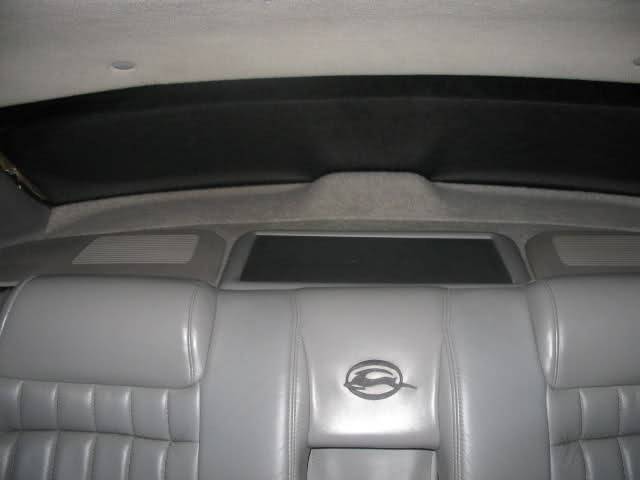

The ones I've heard sound great, this is a bandpass, here's pics in a '96 Impala SS.
