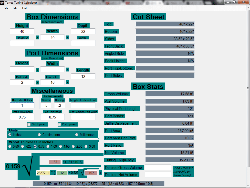

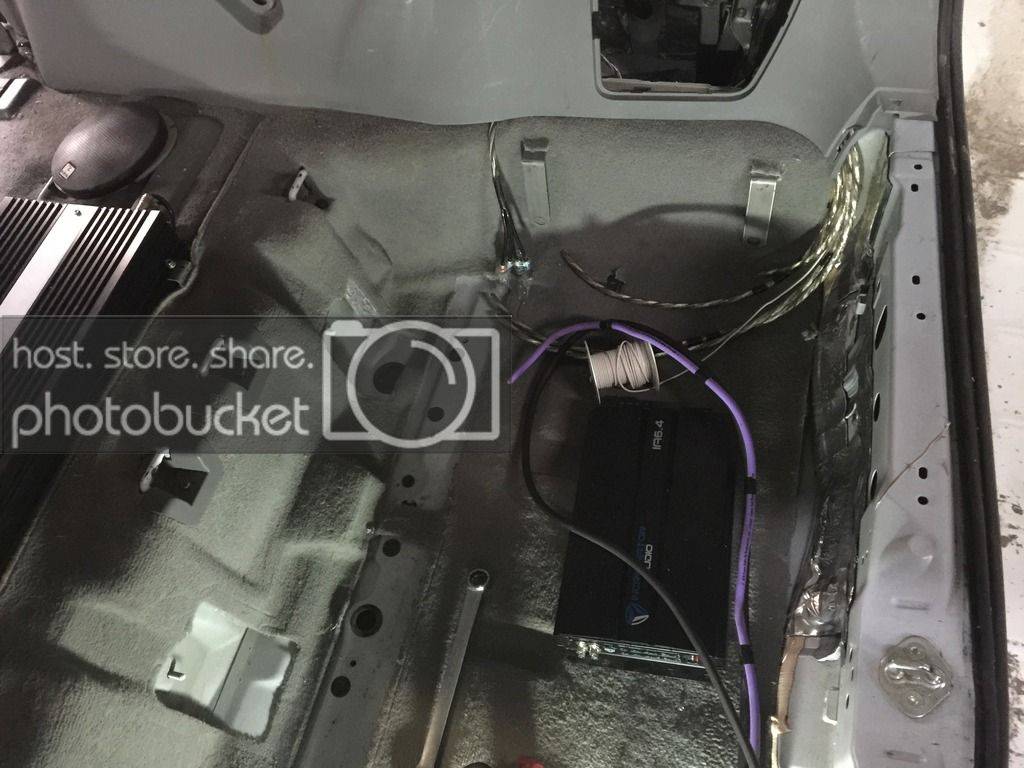

22 x 40 x 40 is only 17.5 gross, you subtract 1.5 from each for wood thickness. For that space, you'll want to go aeroport with a sonotube from home depot. Probably need 2 10 sonotubes ported to the side. If you can, do a cardboard mock up to see if the box will hit hatch window since its kinda curved. At the bottom, there's some steel curves at the side that might prevent the box from just dropping straight in.

Rear cargo space of a 2011 Sienna minivan, retaining 3rd row seats.

The steel curves you are referring to is where I mounted my IA6.4 right?

I have 40 from the 6.4 to the inside of the other side - I thought I needed the cubic footage so I didn't think I could put the ports on the side with there being only like 4-5 in to the side of the van.[/QUOTE]
4-5" is plenty of room. My Tahoe with port back loved 4" away from hatch.. So 4/5" away from the side wall will be fine. Just don't build the box to tall.

Using Jeff's mspaint diagram for layout - do I use what SSA recommends for the cubes (7.25-7.75ft^3 @ 27-34hz) or what would be suggested?
And remember at least double layer ur whole box. So when u use Torres box calc ur wood should be 1.5" thick. And after woofer and port and bracing displacement space gets ate up fast.... I say just wall it 3rd row lol. Cuz I never had a mini can but all suv I've had it never sounded very good with a box over 24" tall. If it's to close to the roof it just doesn't get loud n sound as good as it should/could.
