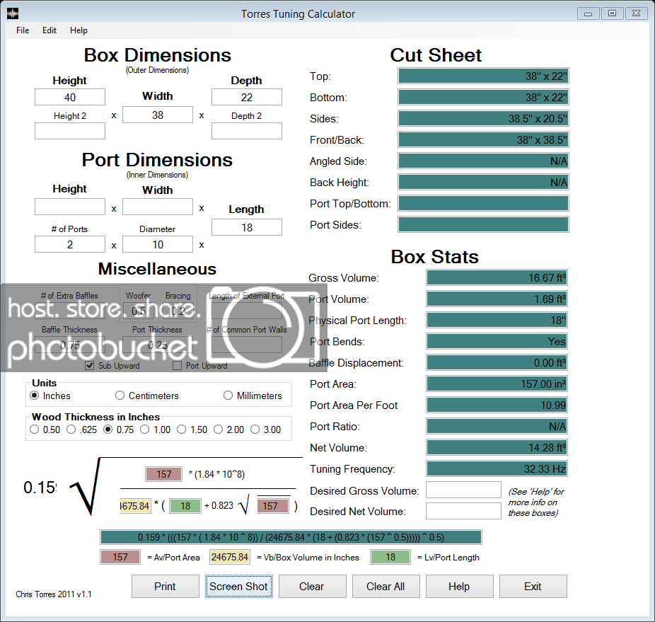

Ok so plotting this box out - changed the ports to 10" with 2 of them.
Flare-it gives me about 70 m/s limit on air velocity but if I plot this all out on WinISD, it shows that there is going to be around 85-90 m/s.
Is this going to create some noise or does it pretty much not apply where the ports are so big?
Ok so plotting this box out - changed the ports to 10" with 2 of them.Flare-it gives me about 70 m/s limit on air velocity but if I plot this all out on WinISD, it shows that there is going to be around 85-90 m/s.

check out what I got with Torres box calc

Anyway as far as ports are concerned - here is what I used
39.37 * (Fb*Vd)^(1/2) = minimum port diameter
then
pi*(above number/2)^2 = minimum port area needed
I came up with 13.207 for diameter and 137 square inches of port area.
Why i went with 2 10" ports is that gives me a port area of 157, a little more then the minimum of 137.

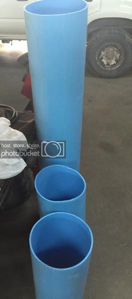

Here is what I got for port material - was 10$ for 10 feet so it saved me a drive to lowes/home depot (an hour and half away)
It is 10" inside diameter and the wall is 1/4". I have a 5 foot piece and 2 x 3.5 foot pieces. Figured extra would be good to have.
