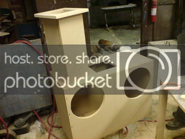

well if it's 7.2 cuft before port displacement then with port displacement @ 37hz that only gives you roughly 5 cuft for both subs to share.....you could always build a square port like this....(i'm in the same dilemma sorta...probably gonna go 8" sonotube or square port like pictured cuz the slot port takes up too much volume)
oops here's the pic i was talkin about....
you can use mbrooky idea, and do a removable port like i did.(sub up-port back) that way you dont need to re do a box. just play with dif. port lenghts and diameters.just try to do long port so you can cut to yor fs needs.
