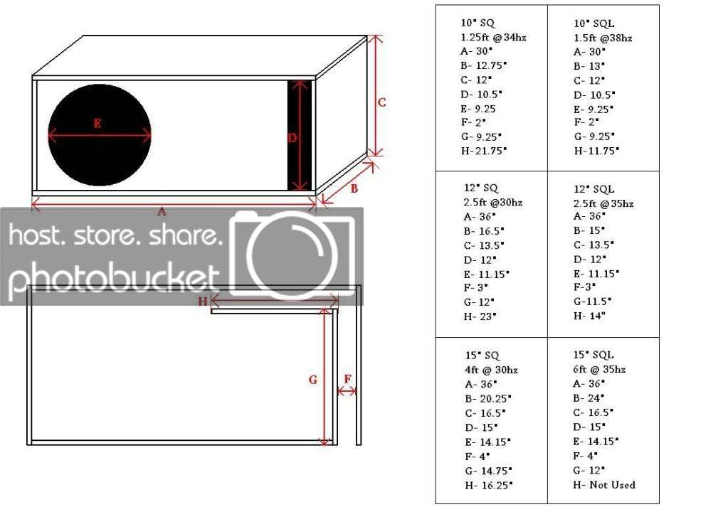

hey everyone i thought i would post this because i had a little trouble finding it myself, but i ended up emailing a guy at RE and he sent me this img
and told me to use the SQ design for my 2 12" XXX series subs,
i just emailed about single box designs and i will post it as soon as i get a reply, hope this helps someone out.
cool. get to buildin it dude. btw you dont need turnbuckles if you dont have them. i just held the wood together for a few minutes then it was fine. plus i put screws in after i glued. good luck
