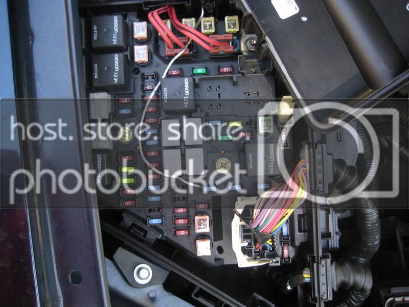

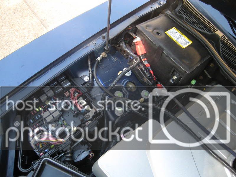

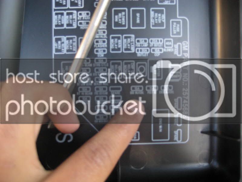

yeah i went to his house today, whoever installed it, didnt use a relay for the turn on lead(since he is using stock HU). the turn-on lead was just stuck in the fuse bay under "odd inj/coil" fuse
