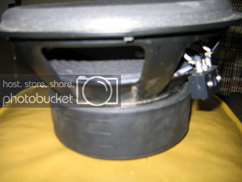

As you guys know RE audio is very underrated.
I ran 2 SE's on an AQ2200 with no problems

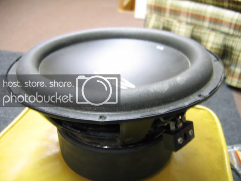

Now I have been testing a 10" RE SR.
News is, I finally reached its breaking point.
AT 900WRMS ported at
(rated at 300wrms)

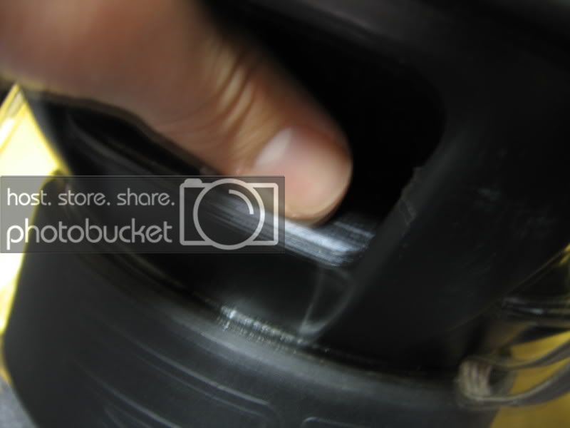

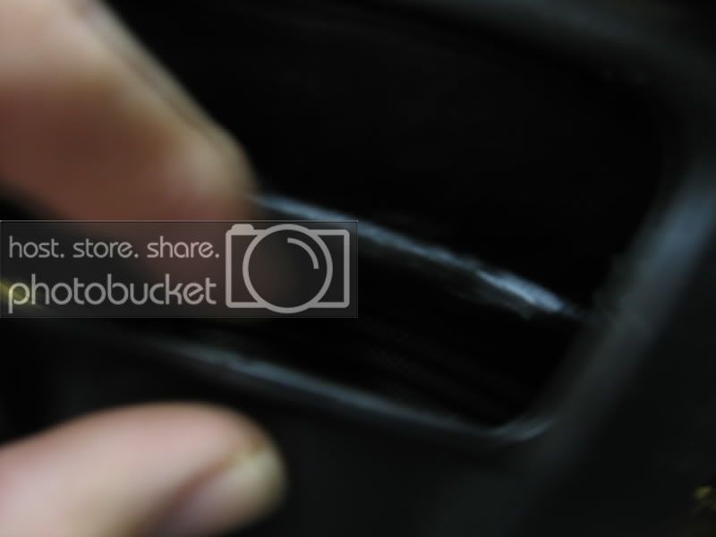

Thing is, it doesnt even need a recone. The spider popped lose from the glue joint to the basket.
The coil is perfect!!!!! This thing was taking routine 10+minute runs at 700wrms without caring. It just couldnt take that 38hz burp at 900wrms.
