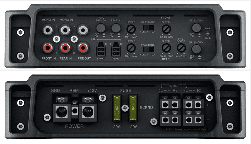

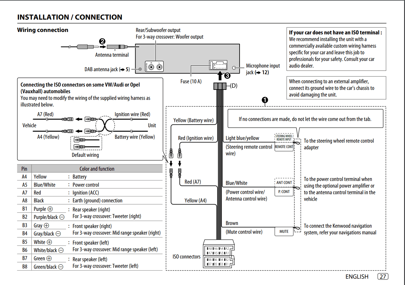

I have a Kenwood player with 2 RCA outputs, namely rear and subwoofer. Im connecting this to a 4 channel amp, that will drive component fronts and a subwoofer(2+1 channels).
How is this to be connected? I want to set my crossover on my player.
1. Left RCA on player splitted to Front(L+R) on amp, and right RCA on player to rear on amp?
2. RCA(L+R) on player to front on amp, and pre-out to rear in on amp?
3. Left RCA on player splitted to left(front+rear) on amp, and right RCA on player splitted to right(front+rear) on amp?
Or some other configuration?

RCA’s from stereo to front input on amp. Rear input switch on amplifier set to off.
You will not be able to use the crossover in the player.
Id throw in a Pre-amp Eq or look for a 3-way crossover.EQ will give you more options to clean up any of your music at your finger-tips. Just my 2cents
Hmm, okay. Seems like my player has only rear RCA output, so my fronts are playing as rear speakers on the player. Is there any difference in signal to front and rear speakers?
At the moment, fronts are set to 50hz high pass and sub to 50hz low pass. RCA from player to front in, and RCA via RCA volume adjuster from pre-out to rear in (sub).

Use two sets of RCAs. One set for the Front channels and the other for Sub Output and into Rear Input on the amp. Turn off the Rear Filter on the...

Thanks a ton for your suggestion to my rather long query, I ll follow it and see how it works out. Thanks again
