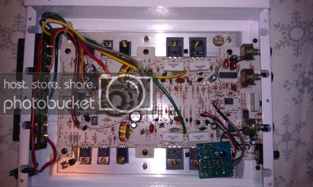

P.S. I attached a gut pic for your enjoyment, or to make you feel better about what you're running, lol.//content.invisioncic.com/y282845/emoticons/redface.gif.62fdbfe1a101588a808c4cff71bcb942.gif
