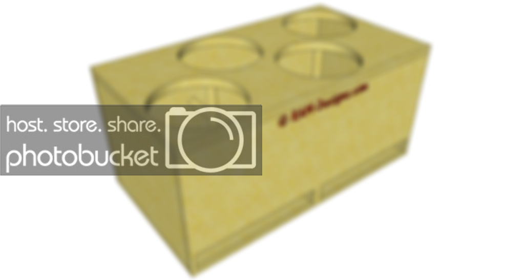

Here's one for Elitebass at the SMD forum. This is for four Fi Audio X10's going in the back of a 2003 Chevy Trailblazer. The box is 4.8ft^3 tuned to 33hz with a pair of 12"x2.5" ports
Ports seem a little small? I like that design though i wish i had the $$$ to run a four 10 or 12 setup, I bet it would get loud as fuuuuuck
Not much port is needed since they're not high excursion subs capable of a lot of air displacement(on their own). The box is on the larger side, and you're still looking at 12.5in^3 per ft^3.

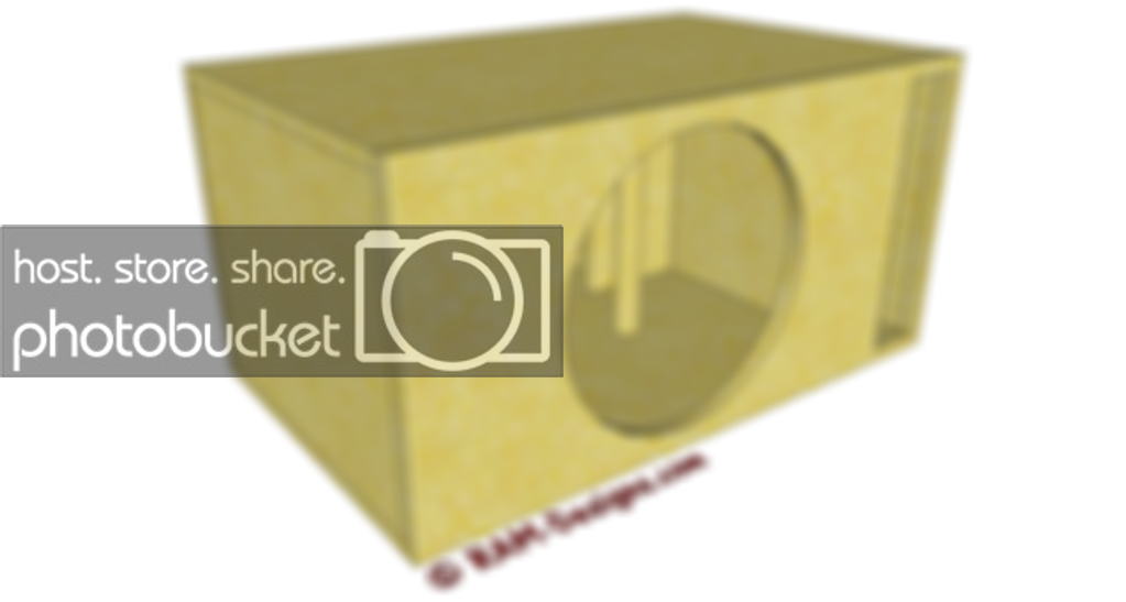

Here's 05fronty's 4th order bandpass box for a pair of SA-15's. Be patient, it's a pretty neat looking design.
