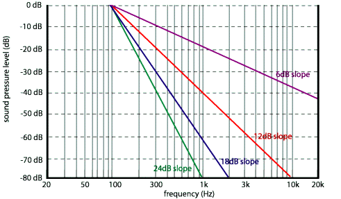

Now it is to my understanding that "DB/slope" pretty much means that the higher the number is the less that driver will play over that specific crossover point. Obviously the higer the number the driver will play less over that crossover point.
In which point with active you have the ability to go from 0-6-12-18-24 in slope.
Set by this example:
