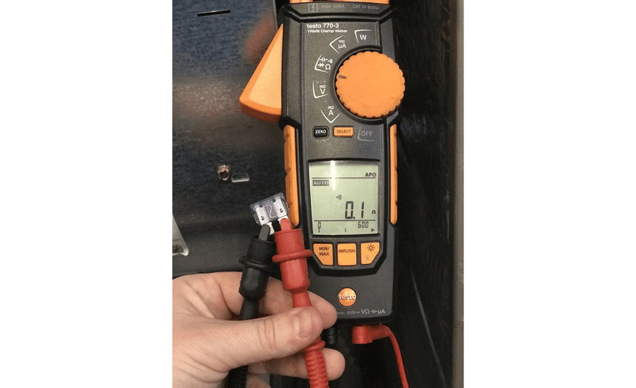

You need to get a device and measure the resistance on the top of each fuse. Fuses can be partially blown and they never look like it.
Most fuses have two recessed contact points in the fuse plastic. Those are there so you can stick needle nose probes on them, and read the ohms of the fuse.

Agreed that is the problem with those little fuses. Sometimes they are very hard to see even with a very small break in them.

So you should do that, and see if you can find a fuse that doesn't match up with the others. Even if it's not fully blown, it's 100% restricting current flow, which can cause lack of current or voltage problems. I've had blown fuses cause voltage to be about half of what it should be. That's a failure of a fuse. Which is ok, they are meant to be the weak point.

Alright I will check that out and see if one of my buddys has one of those tools. If they don’t would an auto parts store be able to check them for me or would I need to buy one?
