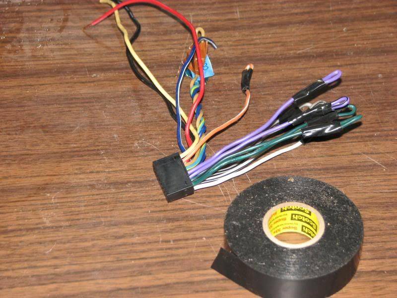

the speaker wires on the head unit will not be used. tape them off individually, like this:
then wire each speaker to each channel on the amp. if you use factory wiring, you can access the speaker wires in the dash. hopefully you have the wire harness adapter so you are NOT cutting factory wires in the dash. obviously, if you can access the rear speakers easily, you can wire them directly and use the factory rear wires to feed the front speakers (connect in harness behind HU) and save yourself some wiring hassle.
