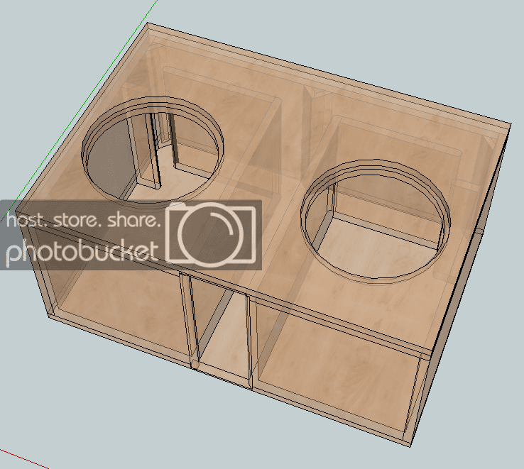

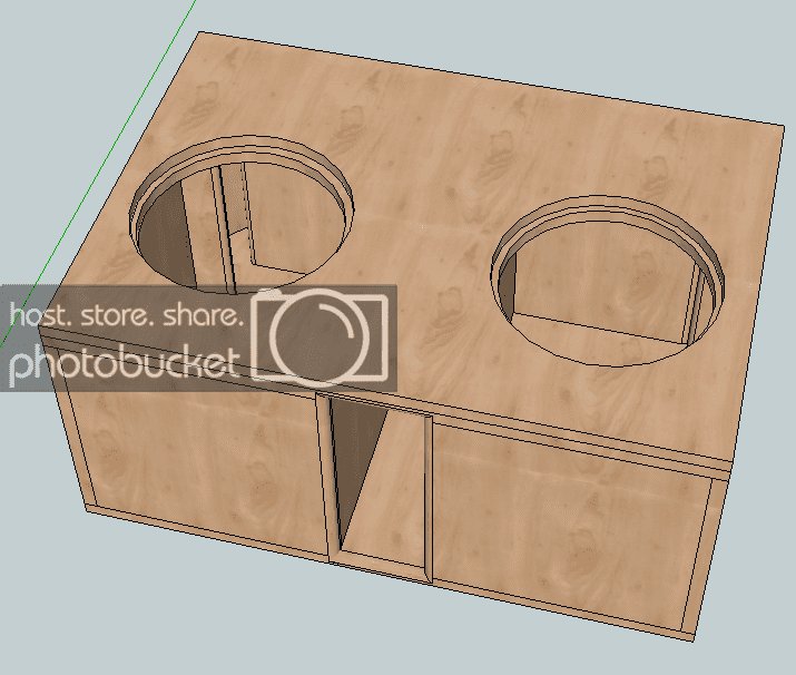

I sent you an email with a design and quote, if you would like I can change it up a little to accommodate the size a little better.
I replied to the email with updates and questions. What was the software you used to make that rendering of the box? it's nice.
I haven't seen the picture but he uses Google Sketchup.
I was going to get the AQ2200D but I think I will have him build me a box first to see if I even need to increase my wattage lol. I'd like the subs and port facing the rear tho so I can cover the box with my canopy thing in back.
