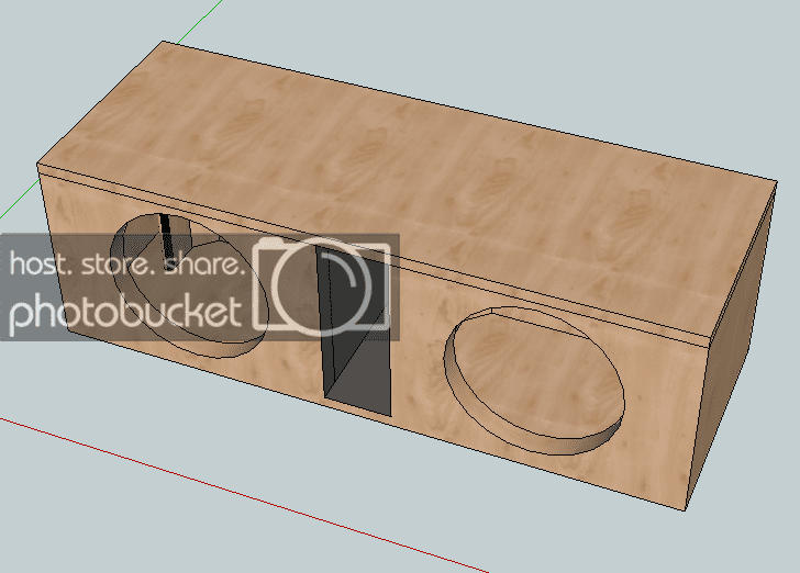

Hey pro-rabbit so I still would love you to build me that box I'm just conflicted on the tuning I know the sa-12's sound good at 32hz but I'm wondering if tuning that low would hinder my kick drum type music like alternative, metal and techno.
I can go over your design again and look at some of the plots, but when I designed it it seem to have a great response. If you would like I can alter the tuning and adjust the design to ensure you have a smooth response curve.
That would be great please let me know what you come up with thanks. The box I have now that I made I am hating it's 1.75cuft per sub and 35hz tuning but only 4" pvc ports I think one of your boxes would sound a lot better //content.invisioncic.com/y282845/emoticons/smile.gif.1ebc41e1811405b213edfc4622c41e27.gif

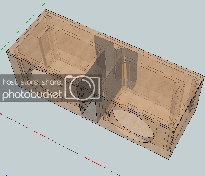

We can do something like this. This would get you very close to everything you want and everything firing backwards.
35 wide x 15 high x 17.75 deep
tuned to 36hz which I adjusted after I did the design. That designs shows a tuning of 31hz, but after some playing around I found that increasing the tuning with your application would work out very well for what your looking for.
Everything looks perfect should fit in the back next to my spare tire at 35" tuning looks good all firing back perfect. I do also listen to some dubstep is that going to be ok at 36hz?
