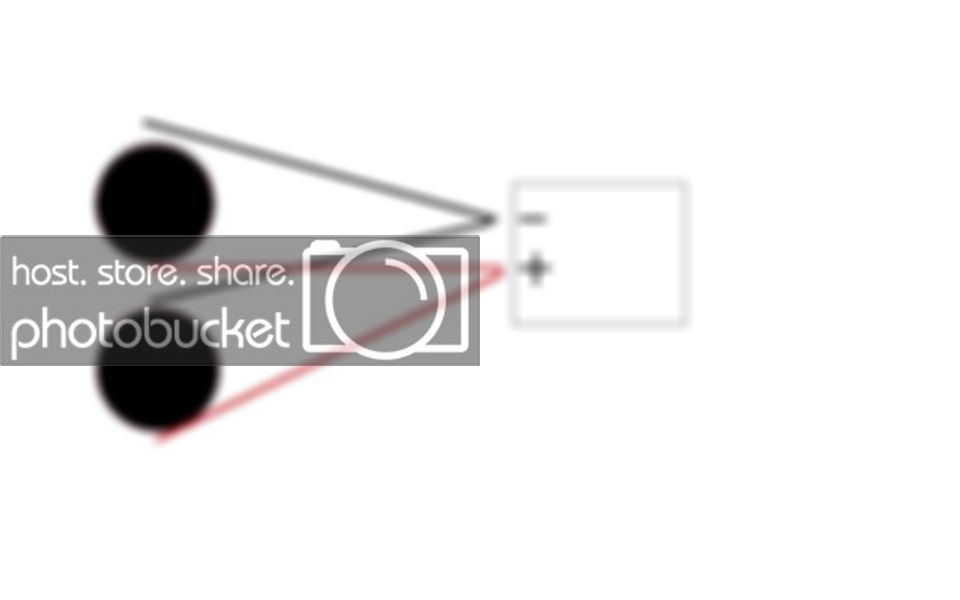

At the risk of being roasted...what happens if I were to connect two speakers to same channel. For instance, I have a four channel amp. I am tempted to wire, not in series or bridge, but to just shove two speaker wires into one channel for +/- and two speaker wires into the channel two +/-. The remaining two channels would be bridged to power my sub.

like this?
Nothing is going to happen, the most is you put the amp into protect which will go away once you remove the load.

You are right, you won't be wiring them in series or bridging, but you will be wiring them in parallel reducing the ohm load in halve. So as long as the amp can handle those ohm loads in the channel then you'll be fine.
If not, you'll just go into protect mode.
