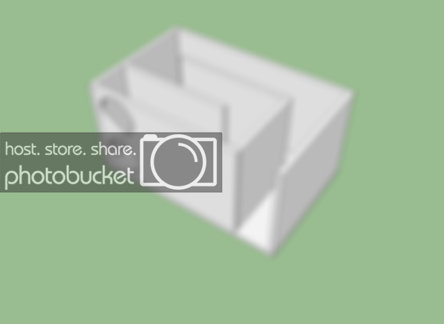

Building a TLine since no one answered my 6th order question....
just asking to see if i made a mistake any where....
the Fs of the speaker is 43
and the Sd is 33.17
using 2 of them so my port area needs to be 66.34
and since the Fs is 43
1130/43 = 26.28 Ft
divided by 4 = 6.57 for the 1/4 wave
6.57Ft = 78.84 in
the way a wrapped the port, i was able to get around 76 inches
and here is what i have so far, still need to put in all of the 45s
