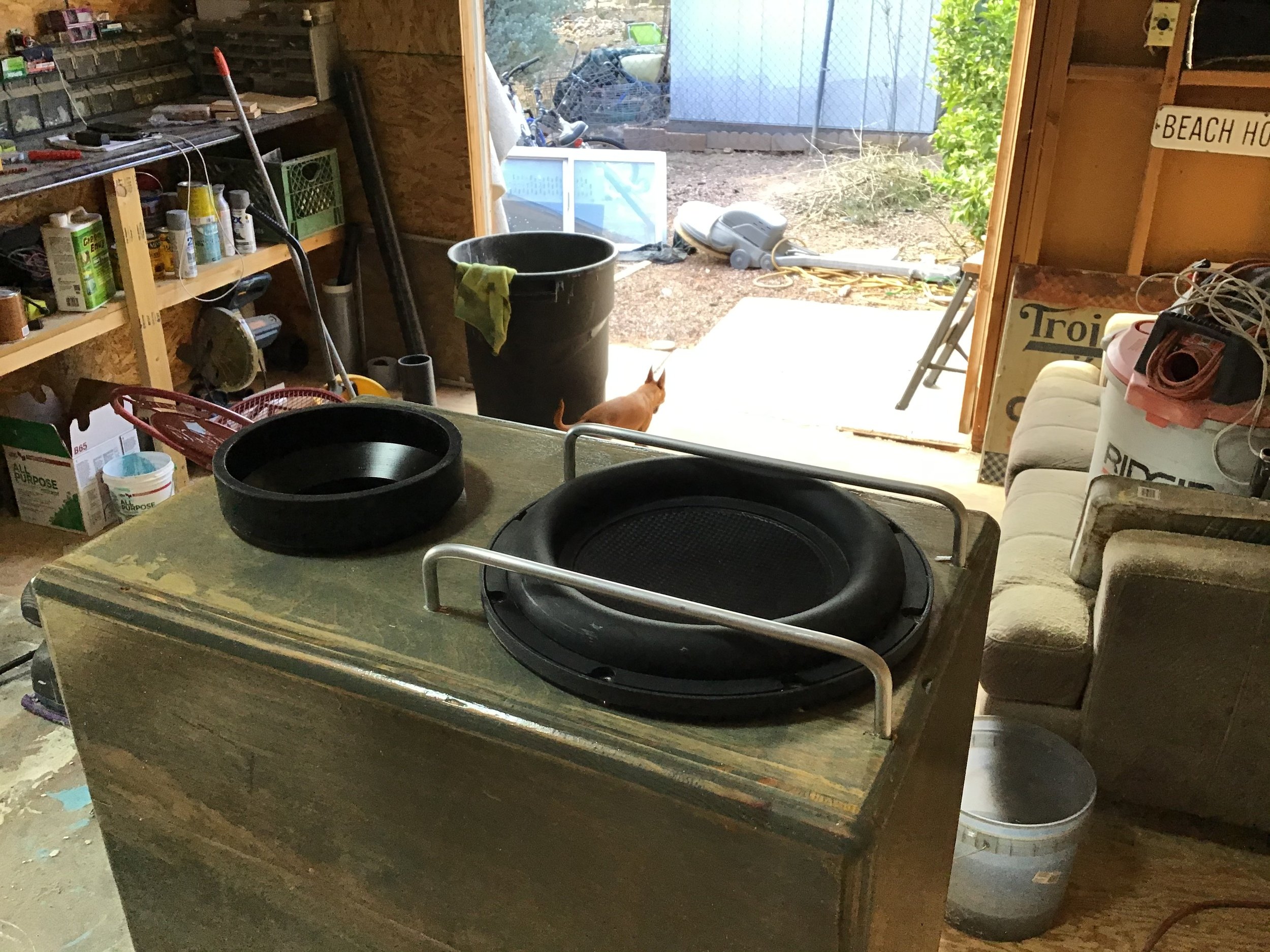

Bigger box. My Ultimax 10" sits in a 1.4 cu.ft. slot ported enclosure tuned to 35hz. I think you could go up to 1cu.ft. with a shorter port for that Ultimax 8.

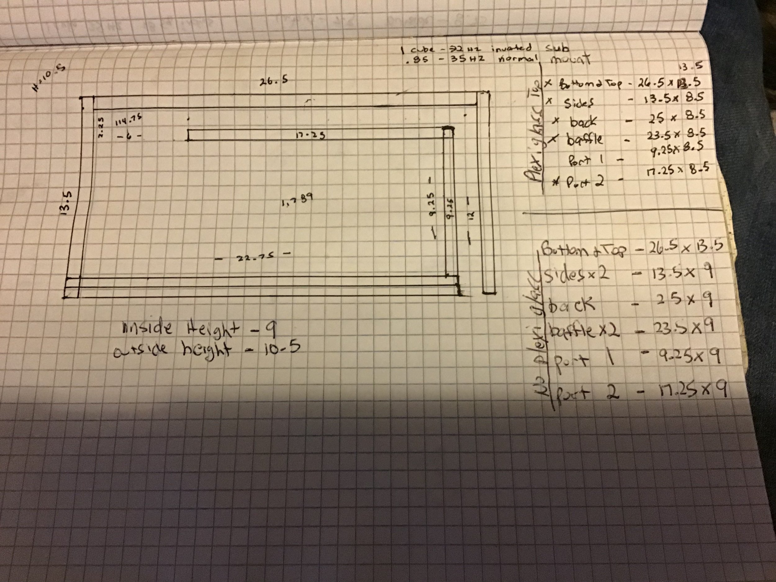

Here is plan I used for a different 8, but it would work. With the Dayton ultimax in the box it would be around .9 tuned to 34 HZ. it doesn’t really need the double thick baffle for the Dayton, so you could eliminate that part to make the build a little easier.
