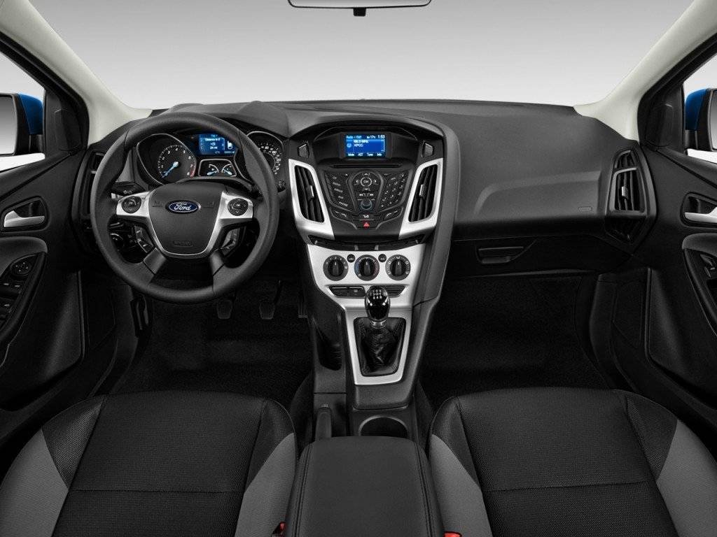

If I install a Nexus 7 into my dash, and have it connected through Aux, will the volume control still work without the radio? I'm not sure if the volume is to the radio or speakers.
Will the LOC still be able to catch the bass without a radio, just a tablet?
So this:
Amazon.com: Metra 99-5827B Double/Single DIN Radio Installation Kit for 2012-Up Ford Focus: Car Electronics
And then a Nexus 7 in it
My amazing photoshop job
.You'll be sacrificing on sound quality. You can use just the tablet without a head unit though, you'll need to go from 3.5mm > RCA's > Processor > Amps
edit... like this: Hifonics HFEQ 4-Band Equalizer with 9-Volt Line-Driver and
