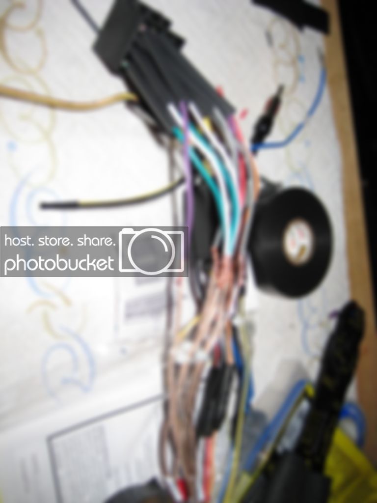

Oh and here is a pic of the wiring (will solder them tomorrow). feel free to critique it //content.invisioncic.com/y282845/emoticons/smile.gif.1ebc41e1811405b213edfc4622c41e27.gif

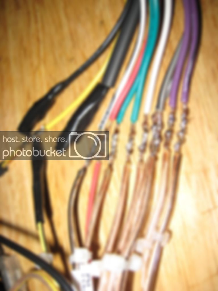

here is a picture of everything soldered up (decided to forego the illumination/dimmer.. I dont want to deal with any additional hassle at the moment and may add it later)
flame away! ( I dont really solder much, just little things here and there)
Solder work looks fine.
excellent thanks for the input
I'm just kind of worried if I did too little, or not enough.
//content.invisioncic.com/y282845/emoticons/biggrin.gif.d71a5d36fcbab170f2364c9f2e3946cb.gif
just make sure you cover them good some of them look pretty sharp.
yup, I have heat shrink tubing already on all the wires and I will be using thick electrical tape over that. I just want to test for continuity tomorrow before I button it up and the hu will go in the car shortly after
