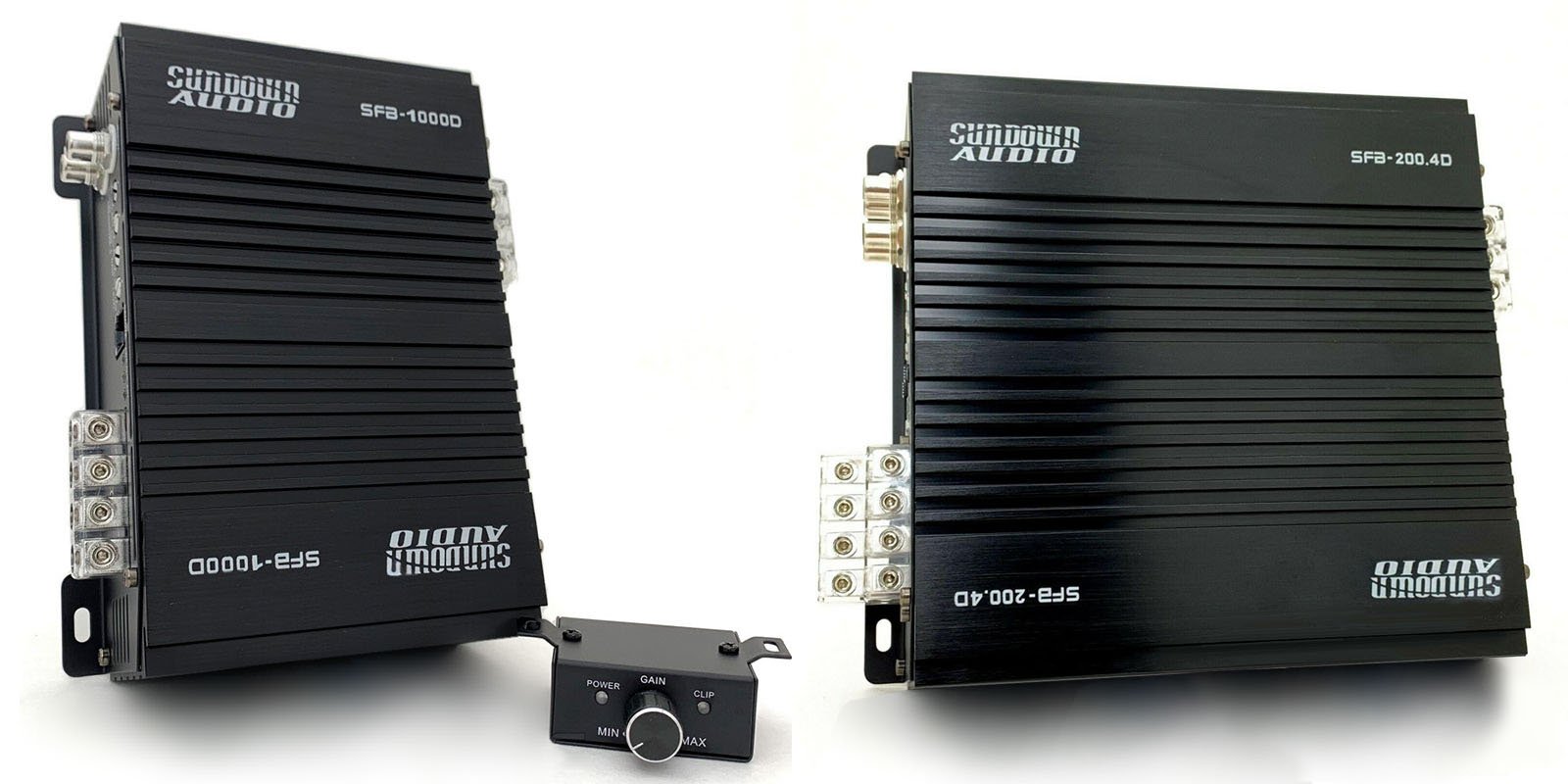

It's a class D amp, but did some thinking and searching .... I already have a Sundown monoblock that I got on sale and saw that Sundown also carries a small 4 channel amp that would work great with my components. Keep it all in the family and still get a great combined price with two year warranty.
