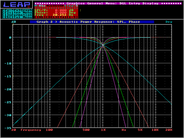

I find this representation of it very easy to understand..:
Cyan = 6dB/octave
Red = 12dB/octave
Green = 18dB/octave
Violet = 24dB/octave
he diagram above shows both high pass and low pass crossover filters with the 4 most common slopes. The crossover point is the frequency at which the level of the signal is 3dB down (for a Butterworth alignment - to be discussed later) from the level of the pass band (the crossover point is about 1000hz in this diagram). The pass band is simply the part of the audio band which is unaffected by the crossover's filters.
