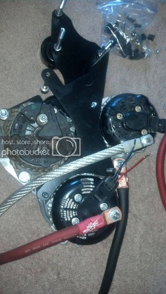

I moved the computer out of the way and connected wires to the alternators after mounting them to the bracket

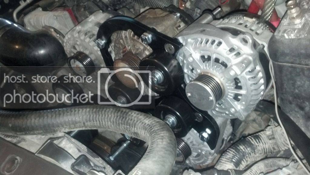

Then I got the bracket with all the alternators into the engine bay
The bolts are going in crooked for some reason. I haven't turned them yet, so they're not being cross-threaded. I'm going to see if one of my neighbors can help me out real quick. Someone else needs to push the bolts in straight while I hold the bracket up
supposed to leave the alts off and bolt the bracket in first, thats probably why you cant get the bolts threaded, tons of weight on one end and you only have two hands. i had trouble with that doing my dual bracket until my buddy helped me out
the center bolt of the 5 (top 2 are the stock alt bolt locations and bottom 3 include the middle then 2 lower - all engine block bolts) wouldnt go in for me i literally left it out lol
I use clamps to hold mine in and straight so you can thread the bolts in. And thread them in by hand cuz you dont want to get those cross threaded !
I ended up taking it apart and bolting the bracket on before the alternators.
