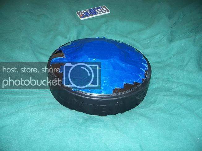

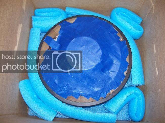

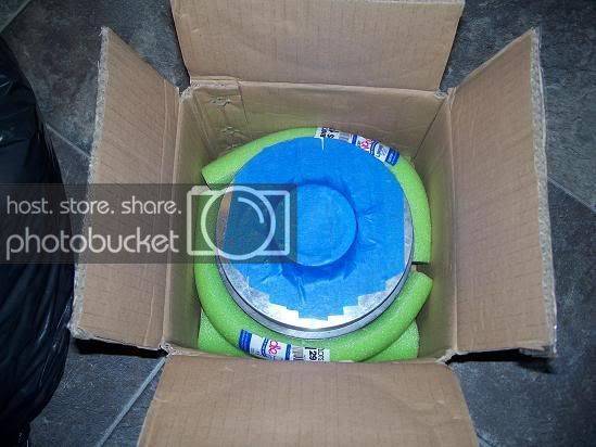

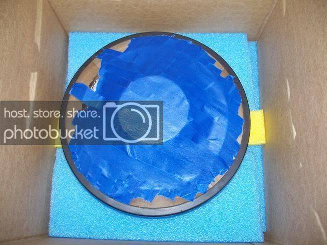

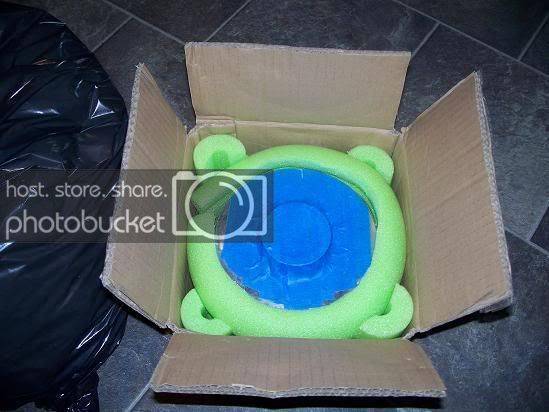

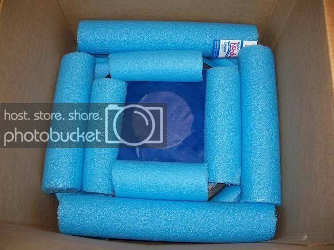

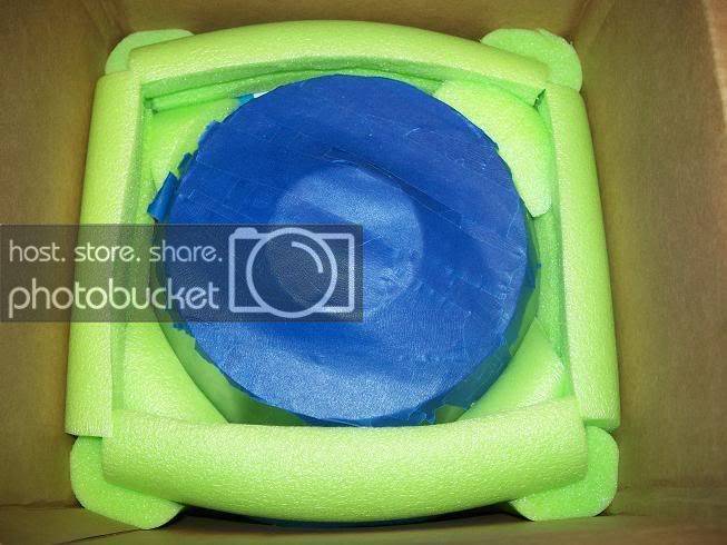

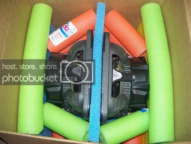

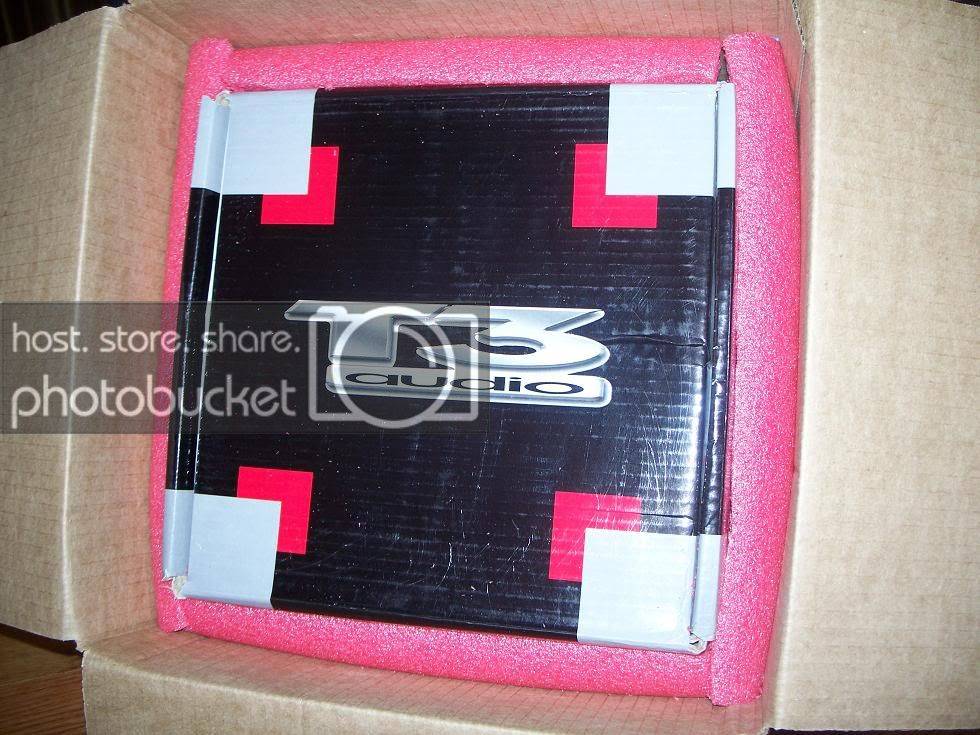

Proper Packing Techniques

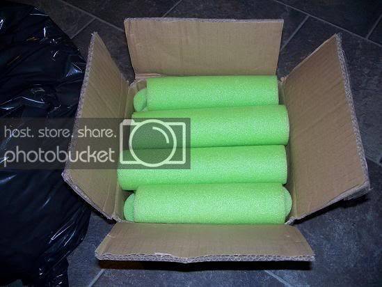

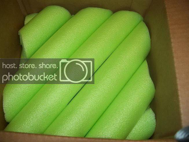

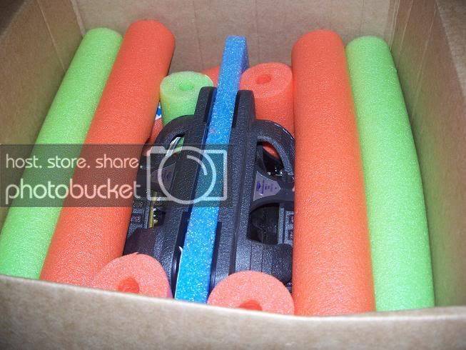

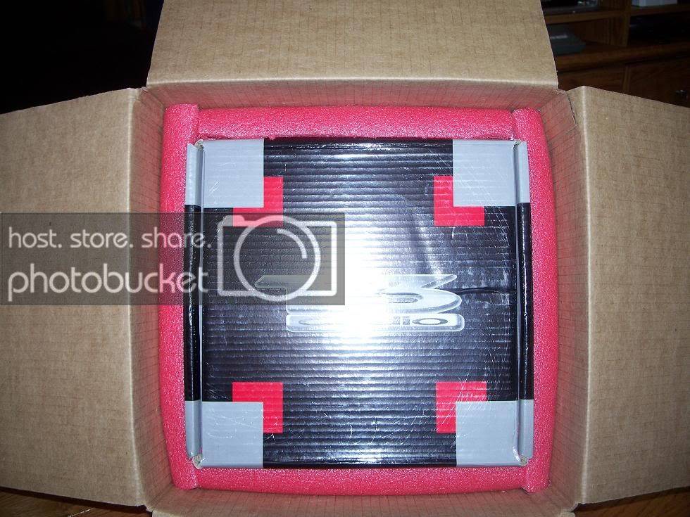

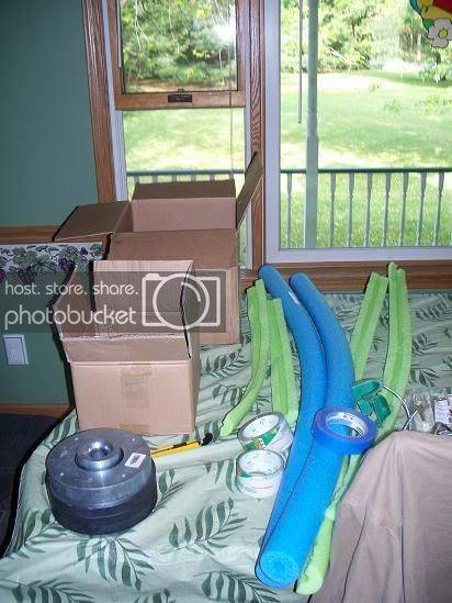

-Try using pool noodles, they are cheap ($1.00-$1.50 each) and affective. You can pick them up at your local dollar store, big lots, or discount store.

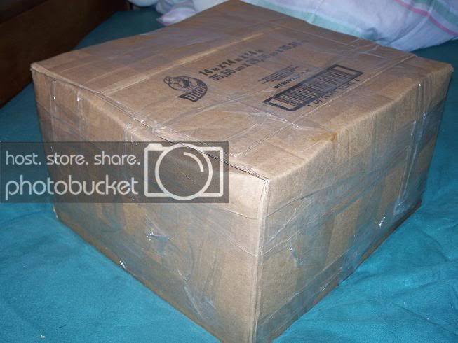

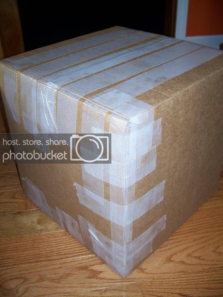

-On heavy packages, tape the factor glue seam on boxes to prevent "blowouts".
-Avoid shipping subs in baffle style crate (were the sub is mounted to a board and suspended). This is a bad idea because the motor is not supported and the basket can break. Also the screws are known to come loose and put tears in the surrounding.

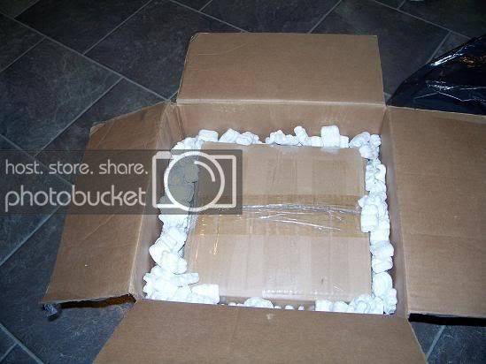

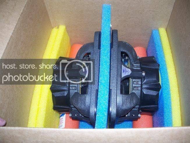

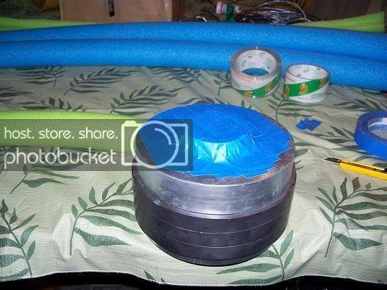

-When shipping motor always tape the gap and never use packing peanuts. The peanuts can get smashed into the gap, then you got all sorts of problems.
-Do not skimp on packing to save money, include the cost of packing materials in the shipping cost.
-Try double boxing to insure the contents safety.
-Never ship items in there factory "cosmetic" boxes.

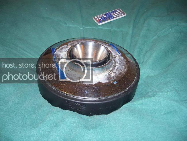

-Motors that are damaged in shipping, such as shifted top or bottom plates can be repaired. Contact Scott @ Fi Car Audio, he can usually reset and re-glue them for a fee.

Pictures

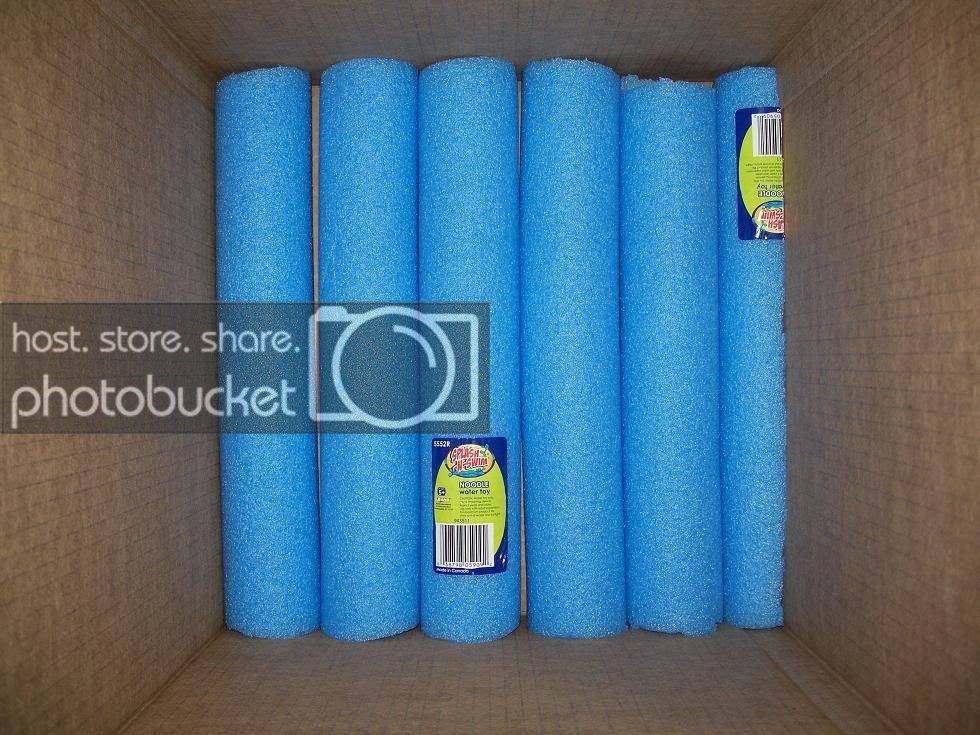

Pool noodles, doesn’t hurt to have a stock of them if you frequently shipping packages.
No need to purchase the expensive ones, you are just going to cut them up anyways.
LA X2 3HP Motor and Packing Supplies
