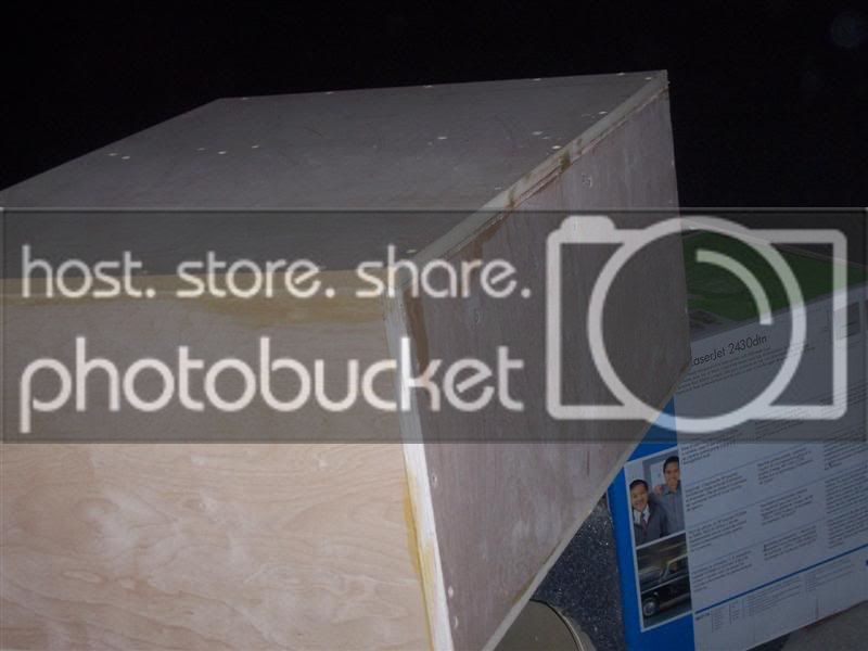

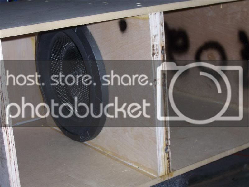

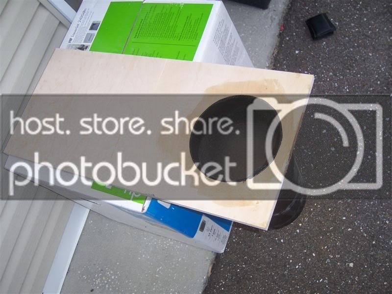

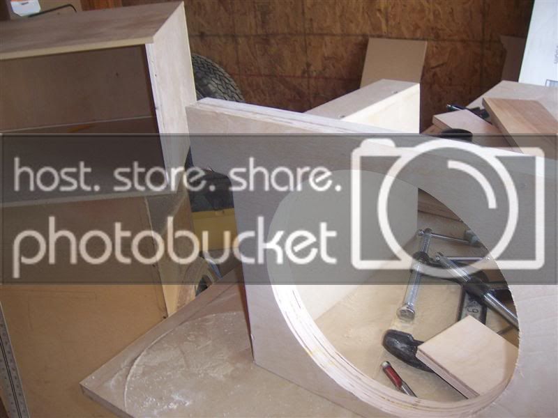

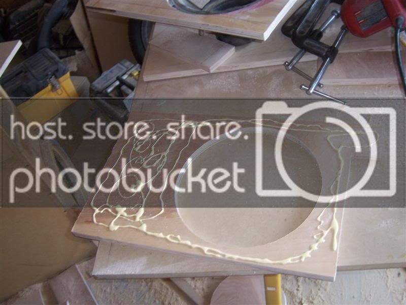

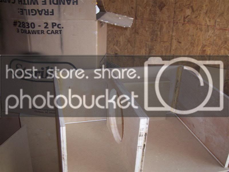

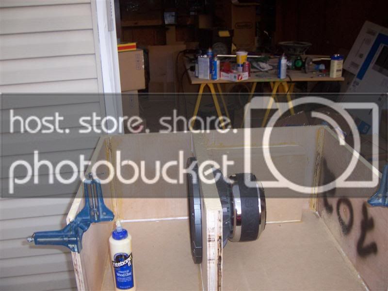

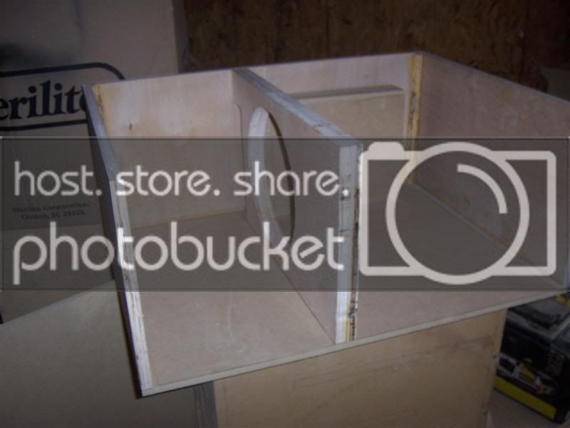

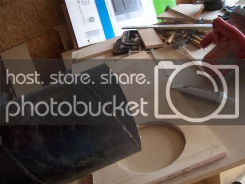

I ended up going with a double baffle for the center, because this sub is MASSIVE literally....lol its a Massive audio DMX.

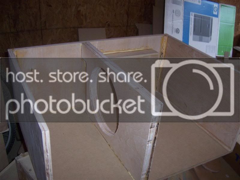

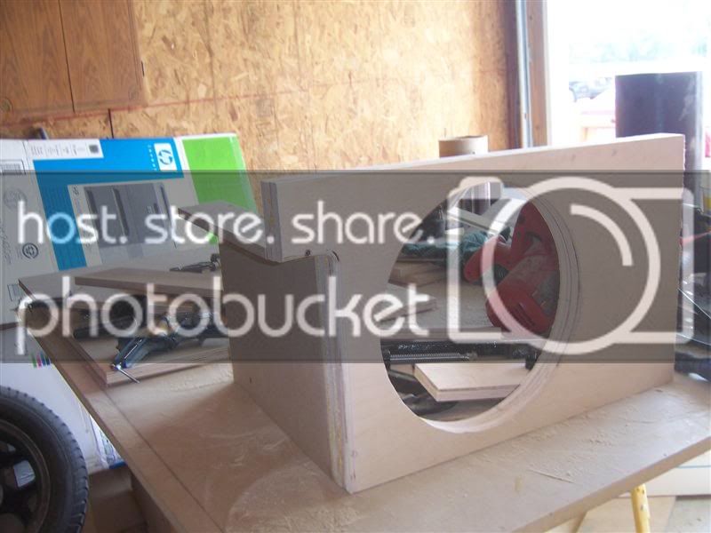

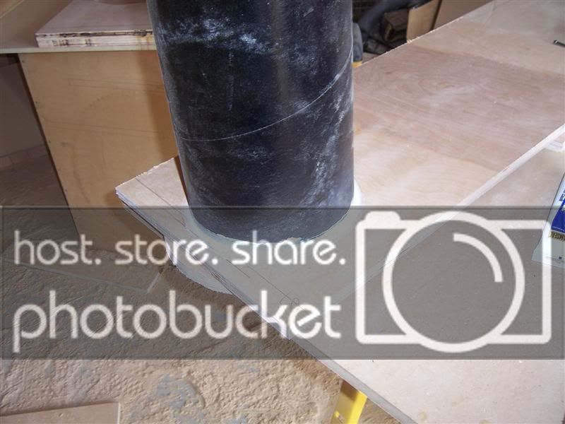

here is the double baffle with the inner port attached
and here is the sub baffle, and the inner port inside the box already.

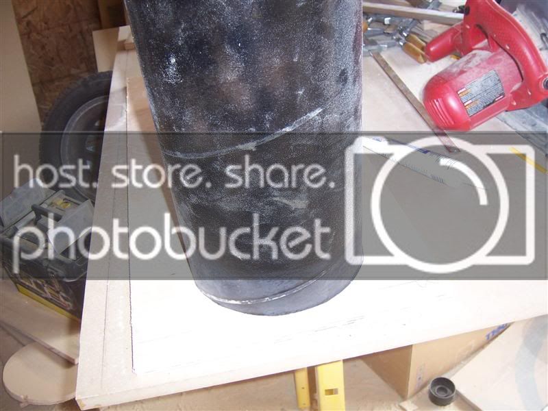

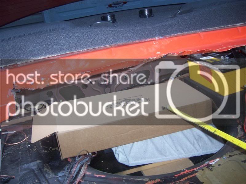

this is an inital fitting pic of the outer port. we ended up changing the style so the box is firing to the rear like a normal box, instead of cutting into his back dash and glassing to it.
yes, its an 8'er.
lol

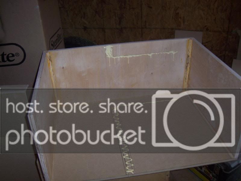

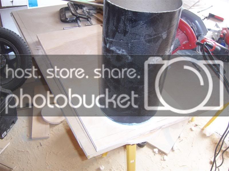

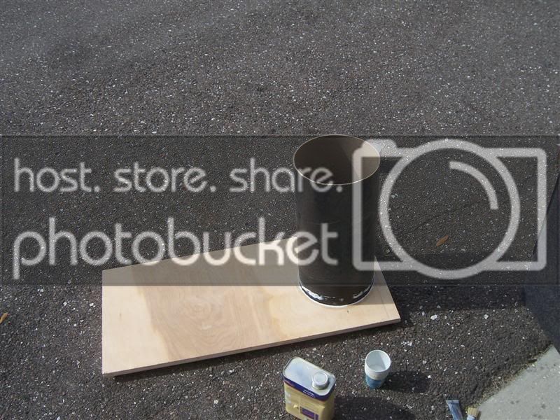

more fitting and sealing the front port pics
more of teh caulk holding the port in, waiting on teh glass.
glass is hiolding it in place....3 layers on the coners

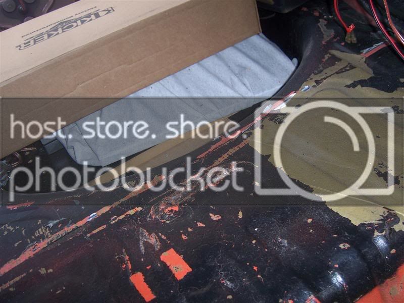

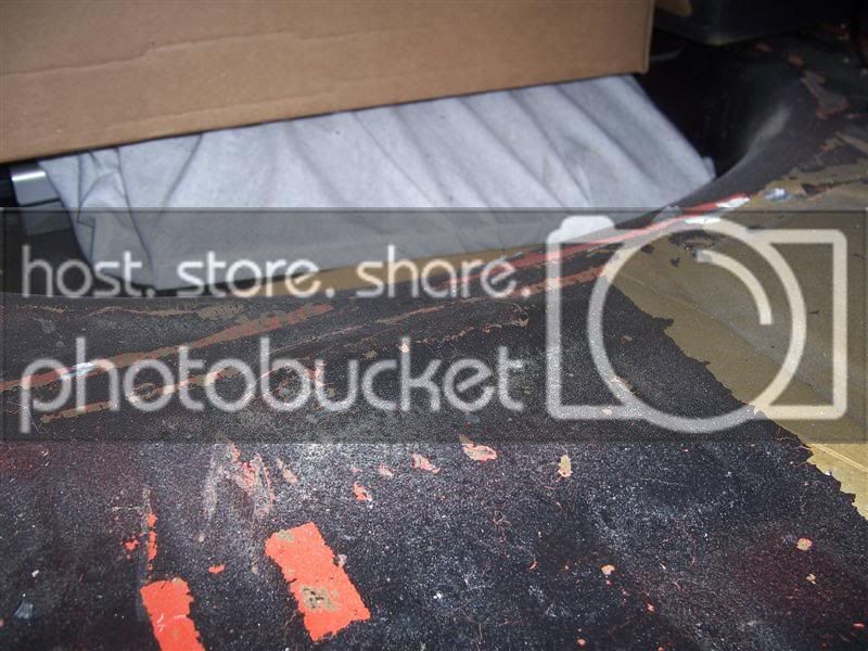

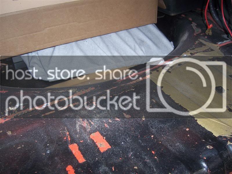

big hump in the car that needed to me smashed...
Big daddy hammer donty play (Part 2)
cuts in the ride
had to make those cuts to get the 14 inch tall box to fin in the first place...lol

**** I didnt hafta cut that much to get into my trunk... That doesnt look pretty at all....but I did beat the hump down.. I forgot about that, until now. Great looking box though.
its getting pushed back down, and covered by that plastic piece that is in the stock location

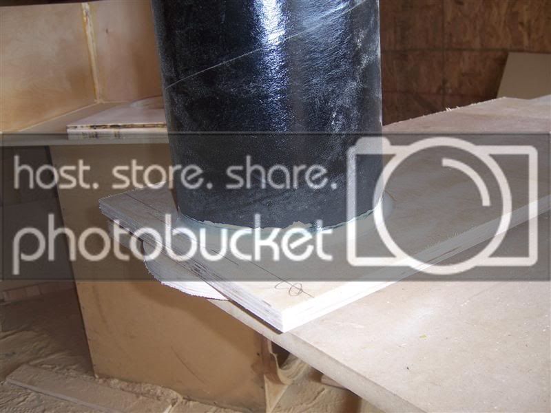

took a lot of angles of the inside port for some reason.

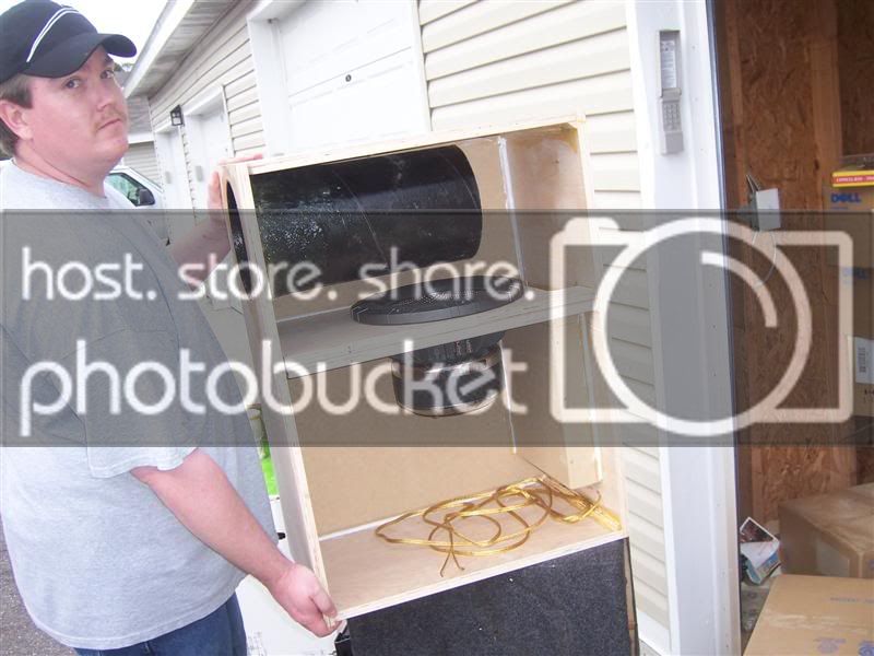

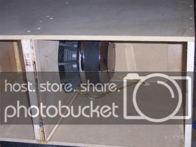

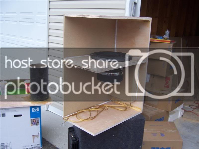

here is the 40 pound sub inside the box already. and it doesnt budge.
Joel; holding in the port going into the smaller chamber.
702 upside down adding teh Esssss Q'sssss

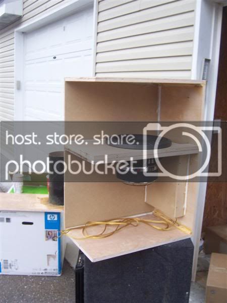

Top is on..
closeup

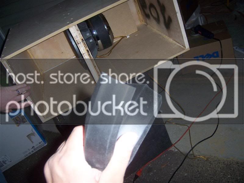

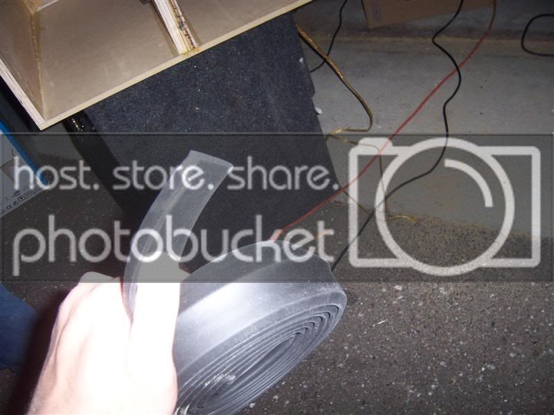

one piece had to be removable, so here is what i used to make that happen.
what is it you ask?
its the strip that you put at the bottom of a garage door. Only used because they didnt have any weatherstripping........which was teh ghey
its about 1 1/2 inch think.

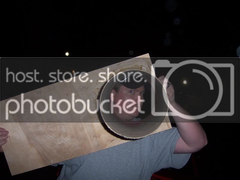

only pic i got of the backside of the port.
