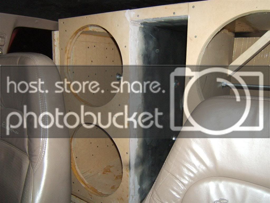

project pimpedout97: 4 15" mts walled off

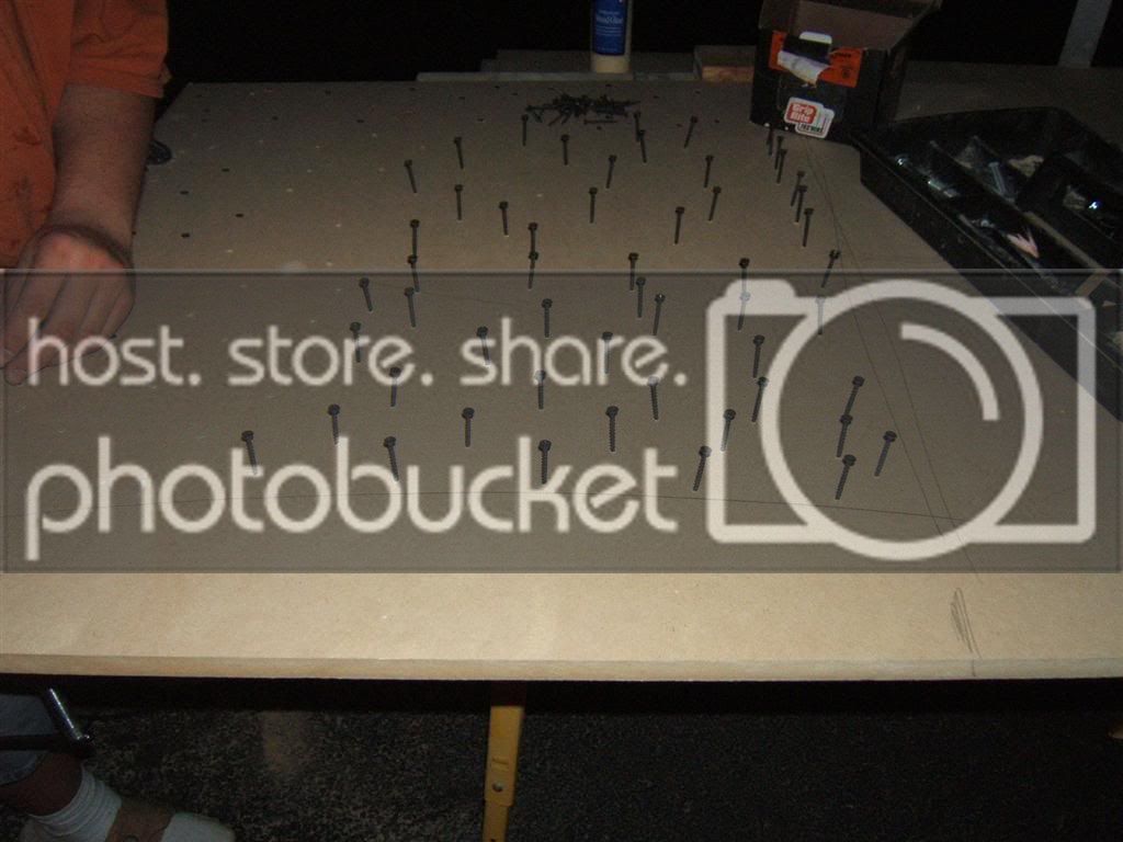

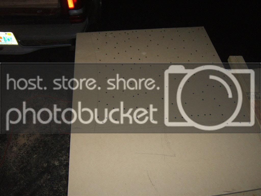

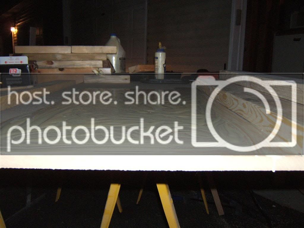

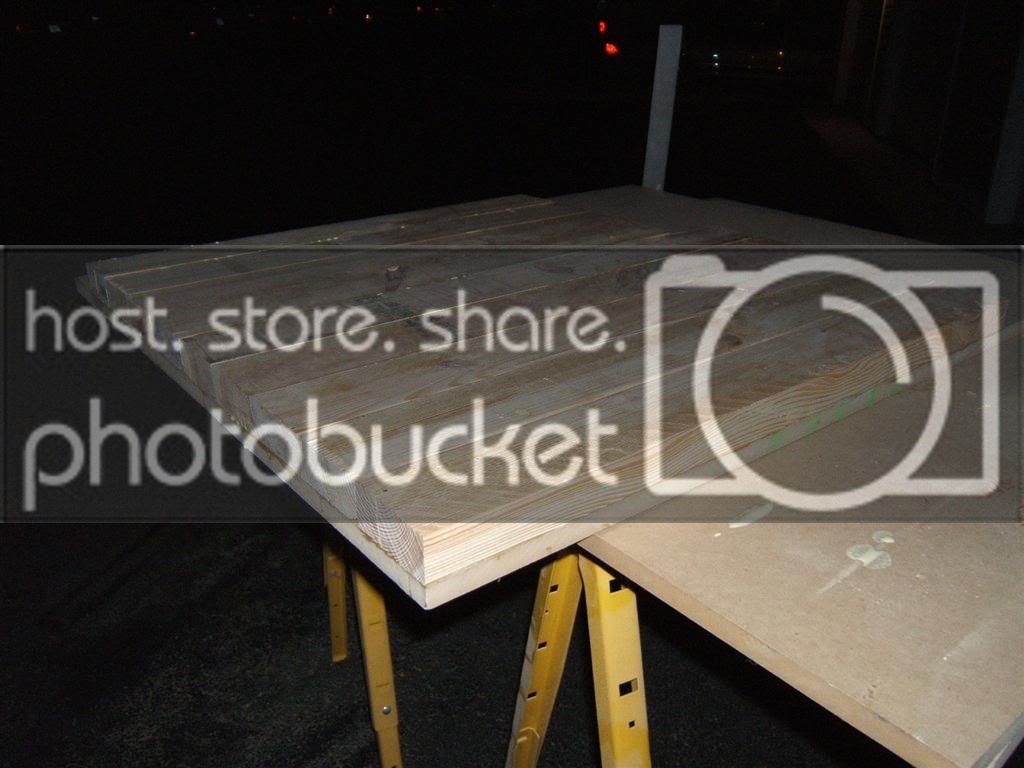

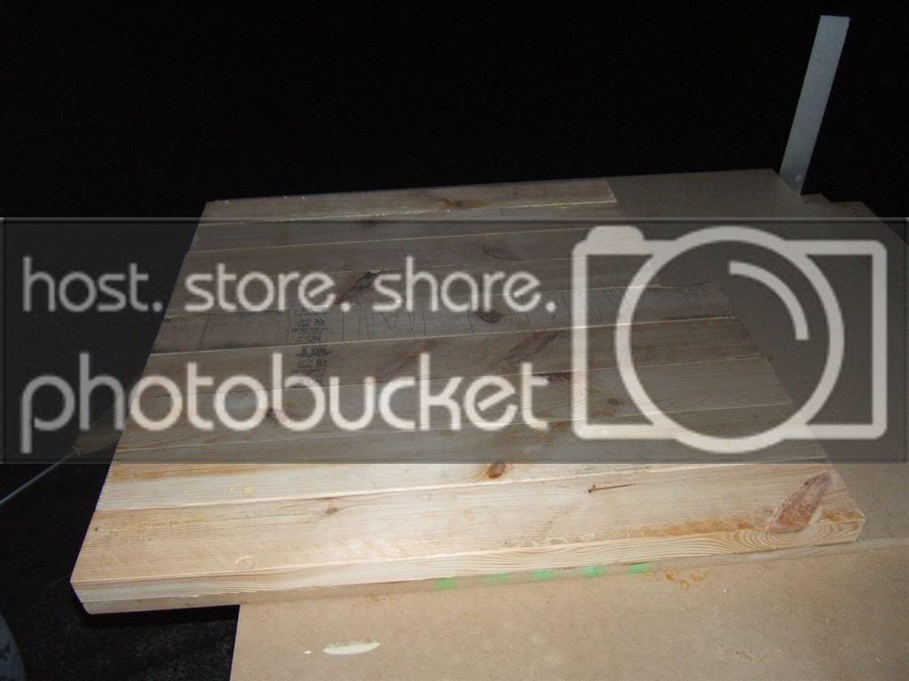

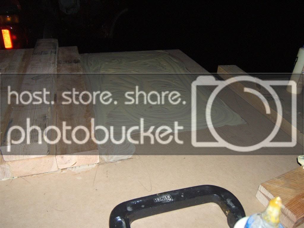

And that is how I ran Kennys 2x4's. I left 4.5" a space between each run and then cut one to run at an angle to run from the top of one to the bottom of the next. Left minimal space open, yet didn't cost as much as running it solid across.
And yes, concrete like walls are what you end up with.
Just signed on AIM.
and the 2x4's are CHEAP...we were trying to use up all the extra, i have like 4 extra 8' pieces.

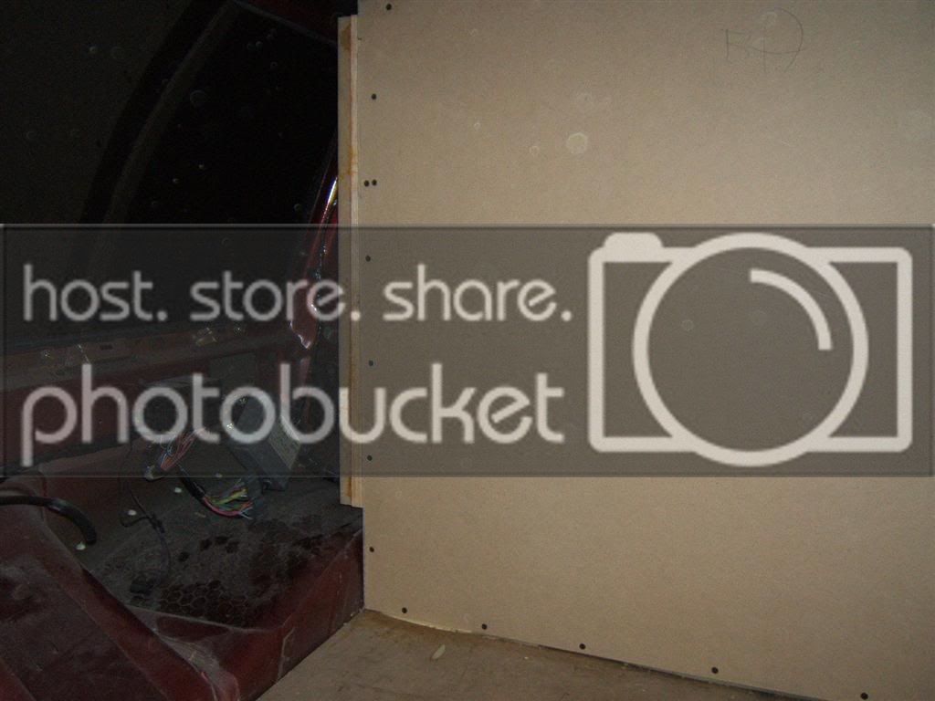

the back baffle will have solid 2x4s though. we ran out of time last night.

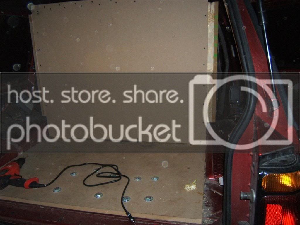

make it when u open the rear door, its completely flush with mdf, covered of course in suede.
its gonna be hard, but ill figure something out. i gotta talk to that guy, which im sure he'll reply in this thread later (drew)

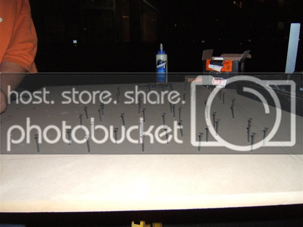

Screw assortment......for the back panel
Concerning your rear door wall are.....When you get ready to plan that out, we should all get together and brainstorm it. I have ideas depending on your final goal and overall look you want.
